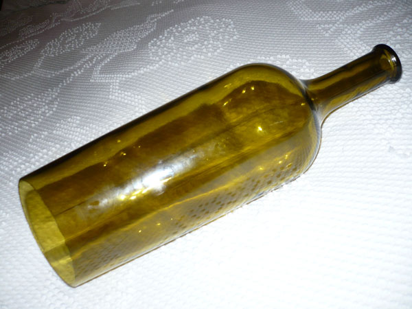

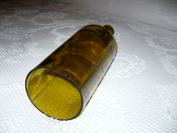

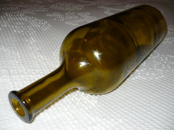

STEP 1: THE BOTTLE
Here she is, the one I think will work. But I can't be sure until the speakers arrive (estimated friday). It's a red wine bottle. But if I were to simply paint the inside with white paint like I did with my last one, it would look like a white wine bottle. I think I'm gonna have to buy some dark red paint from Home Depot...I want it to look like a red wine bottle, I think that will go better with the iron rack and black speakers.
The edges look parallel in the picture, but they're not. It's hard to tell, but this is one of those bottles that expands from the bottom before contracting again at the top. I originally wanted the ones that have a relatively short region of straight edges and then taper gently towards the top. I don't know what they're called. But on second thought, could this expanding type bottle be good to reduce standing waves?
Ok, here are the pics.

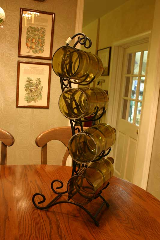

the rack came today...looks great!
here is a pic of the rack with the four bottles, all cut, placed in it.
the rack only touches the wine bottle at four points. to stop the circular version of standing waves that bottles can have (the ringing when you flick a wine glass), I think i should touch at more places than four points (more like a line). So I might need to buy some foam padding, cut it into the right shape, and paint it black.
Any suggestions on where to get this type of padding? local art supply store?

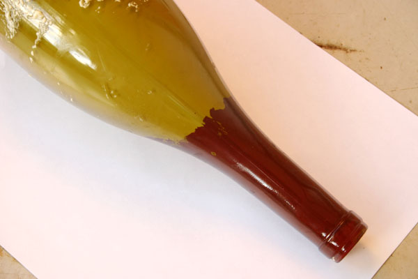

also, I need your advice on painting.
attached is a scrap bottle I used. the white paint makes this red wine bottle look pretty nicely like a white wine bottle. I like the color, though I was thinking of making them look like red wine bottles (seems a little classier).
I bought burgundy colored paint, but it looks way too red. Red wine bottles rarely look red because of the color and the glass and the density of the liquid...they almost always end up looking black.
So right now I'm leaning towards just painting the inside black. What do you guys think?

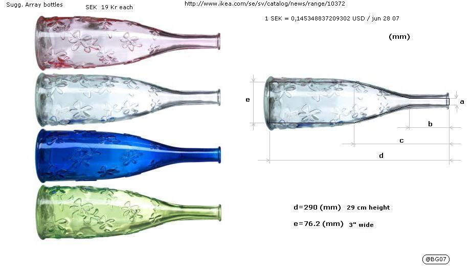

Hi Shpoop,
Nice project!
You have to supply dimensions for your bottles; otherwise its impossible to give you a recommendation concerning a specific driver and the amount of stuffing needed or what the difference would be if you vary densities and their total weights.
For optimum result the stuffing may also be applied at different locations in the bottle.
As a good approximation, post the dimensions of your bottles labelled with letters in the attached picture and you might get some response form this forum.

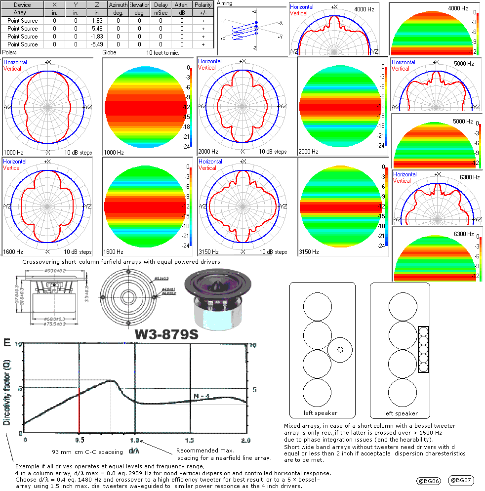

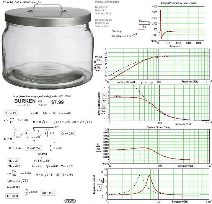

cool. The speaker and the jar don't look to be the same diameter...are they if not, how did you fit them?
No, they aren’t, you have to make a circular baffle (of glass) instead of the jar lid.
Another hint, 4 drivers will absolutely have really bad dispersion characteristics over about lambda = 2960 Hz even if the c-c distance is minimum.
Cross over to a T driver <= 1480 Hz 12 dB/octave filter or with a steeper filter if closer to 3kHz.
Test with a 1.5” driver mounted as in the submitted picture, placed as close as possible near the middle of the array, maybe in a suitable wine glass?
With stuffed1.5 L volume only, the Qtc will be about 0.8 at f-3dB = 128 Hz.
Tip;If higher power is needed at fc, use no bottle cork and trim the whole volume to a Damped-Box, Damped-Vent (Aperiodic) System.
