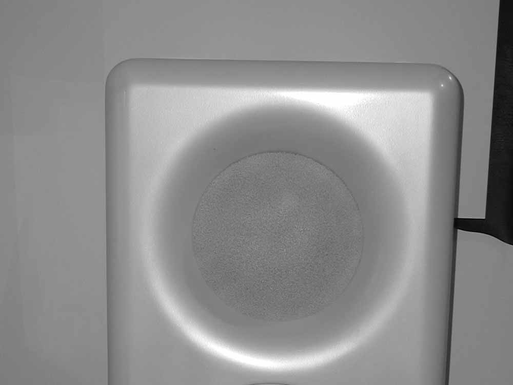

I have attached a photo of the Summa. The foam is quite evident in the waveguide.
I tried about five densities of foam and at least that many shapes, took complete polars, etc. The density is a critical factor, too dense, too much loss, too open not enough effect, but the shape played a small role - works like an acoustic lense shaping the waveform.
Small features like screens don't have much of an effect. You can see that my foam is about 7 inches thick from front to back. This has a major effect. I even tried wall coatings, but again, not enough effect to be worthwhile. Make no mistake there is a price to be paid for the foam, it takes about 3 dB out of the high end that has to be EQ'd back. Fortunately with a awaveguide and compression driver we usually have a lot of output to spare. But believe it or not once the response is CD and the foam is used the top end of the waveguide has about the same output as the 15 woofer - no more. Its the limiting factor of efficiency.

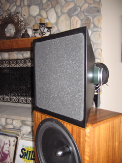

Sheldon said:Shown in the Unity. Goes all the back into the the throat of the compression driver, about 12" worth.

Very cool! If my patent issues this would be a violation so I would be careful about commercialization.

Thanks, and your patent is safe from me. I'll be more than careful; believe me, there is no conceivable scenario that involves me in the business of selling audio stuff.

I didn't realize you were stuffing the whole thing with foam. You cats are just crazy! 😀
Still no terminus treamtent, though. Try it, it really works.

I do see an issue with our products from diffraction off of the mouth edges even though they are radius'd. I might just try what you suggest, although I do need a solution that is a little more commercially viable than "towels".
