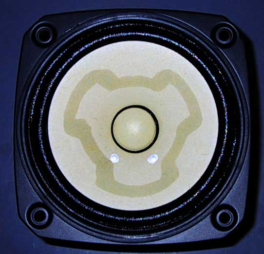

Puffin said:(does anyone know the formula for the pattern ?)
It is not a secret.
http://fullrangedriver.com/forum/viewtopic.php?id=535
dave
PS: if you have any questions i'll try to anser them....

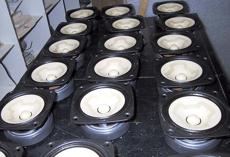

I got some damar varnish at lunchitme to do the pattern on the 126 cones. Of couirse I could not get hold of any puzzlecoat or it's U.K equivalent. Is there a substitute ? Watered down PVA ?
Puffin said:Of couirse I could not get hold of any puzzlecoat or it's U.K equivalent. Is there a substitute ? Watered down PVA ?
Mod Podge is a PVA formulation (PuzzleCoat is the brand name of the stuff i started out with -- don't think it has survived thru these last 30 years). I use it because it dries and retains a fair amount of flexibility.
picking the co.uk domains (there might be some .coms in the UK too.
near the bottom....
http://www.doart.co.uk/acatalog/Glue1.html
Mod Podge (PLAID-U1120) is probably the one to use
on sale this week, so all tou UKers get on line or visit your local doart store and scoop some up... a 4 oz bottle should be good for 100 little speakers... if you have some big woofers to do you might want to pop for yjr 8 oz bottle or even the 16 oz. Keep in mind it is useful on FE16x, FE20x too (and it will no doubt find its way onto FF1x5 as well (past experience tells me it won't hurt but you don't teally know until you try it)

Dave. I now have the Damar varnish and Mod Podge and I am ready to go. Just a couple of questions :-
1. Is there a measurement for the length of each line ?
2. How many coats of Damar should I apply ?
3. Is 2 coats of Mod Podge sufficient ?
I see on your site there is a box of modded drivers with a different pattern on them. Are these 126's and is this pattern worth trying/does it work as well as, it looks better (aesthetically speaking)
Rob.
Rob.
Puffin said:1. Is there a measurement for the length of each line ?
60 degrees (and then judiciosly extended just a bit as you join the ends of the levels
The damar creates the pattern and you only need one application
Yes... note that it doesn't take much added water (or colorant) to thing the puzzlecoat until it is ruuny enuff... you also need to work fairly fast since when applying it as lightly as you do, and thinned it tends to set up fairly quickly and you want to get it brushed out evenly before that happens (althou -- with practise -- that can be used for effect with colours)
There is only one pattern. The 1st set pictured on the FR Forum were the 1st stab and weren't fully developed.
Attachd is a pic of the pattern before puzzlecoat (i've tweaked the gamma on the pic to make it stand-out)... 2 sets of 3 arcs and then you join the ends... the last an opportunity to tidy things up a bit. Note that this one has a pattern upside down from what we usually do -- do pay attention to get the pattern oriented in a pleasing manner wrt the driver mounting holes and the lead out wires.
dave

As long as you don't overdo it (or slip and spill the bottle of damar onto the cone...
Also, until you have a good handle on how the damar flows it is a good idea to have a piece of cardboard to blot your danar brush on between bottle & cone.
dave

The whole cone is done in puzzlecoat, i'm not a big fan of whole cone with damar, it exacerbates the resonances instead to help quiet them.
dave
Scottmoose said:IIRC, it's picking the specific points at which the cone breaks up -but don't quote me.
The placement of the arcs radially is very much directly from the work done by mark mcKenzie.
Joing the 2 arcs together was a serendipitous accident (if you are not careful the damar will run)
I have no idea whether a better pattern or scheme could be developed, but we do know this one works... if i had the R & D budget to burn thru a couple cases of drivers, to do some serious masures (including laser interferemometry (sp) i'm sure that more could be done.
That is one of the reasons the mod is out in the public domain, so others can participate in the R & D... So far it seems, you can put too little damar on (ie make the pattern too thin) and you can put too much puzzlecoat on.
