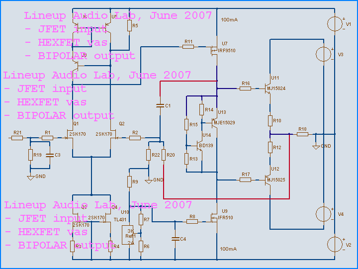

Experimenting with Voltage Amplification Stage.
There are many ideas about input & ouput transistors.
They are important too.
But to have a good and not to un-linear VAS stage .. is a real blessing.
At least when every other stages are trimmed to last decimal.
As you can see from attachment
this experimental setup use IRF TO-220 HEXFET for voltage amplification.
At a comparatively High Current.
My first version here, which shows good performance
uses JFET 2SK170 for input and TO-3 MJ15024 / MJ15025 ( hello JohnCurl !!!!! ) for output.
Not much more to say really.
If you know how to read a perfectly drawn schematic
you will get the idea and how it works without too much difficulty
Finally, this is according to my ideas.
How I have got the strength of diffrent transistor technologies:
1. JFETs are good for input. One quality is High Input impedance and low bias current.
2. MOSFETs are are good voltage amplifiers, they are fast!
3. BIG BIPOLAR working as Voltage Followers have low losses.
Even if noe are very good Output FETs that are just as good and probably will be the future ahead.
Enjoy my screen capture directly from my Sim Working Bench.
I will explore this idea further, when I have had some sleep and feel fresh again.
Audio Regards

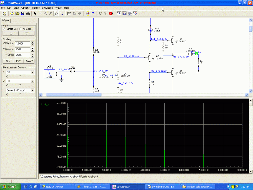

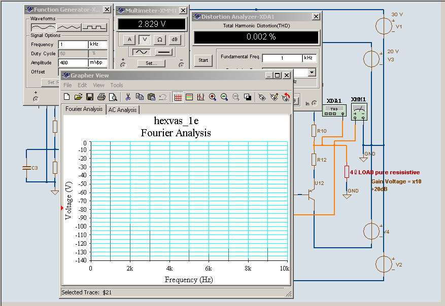

2 Watt RMS, 4 Ohm fourier and THD analys
if you look at my attachment
you see good test results
For an unfair comparison:
I have not been able to get any lower Sim at 1 Volt RMS output
than 2.2 % THD into 10 kOhm. ( ~ 60 dB worse than my attachment into 4 Ohm)
I refer to the original Nelson single transistor 2SK170BL JFET Boz circuit.
(When optimise the drain resistor, (4k7) I could get this down to close 1% THD.
But not any lower.)
It should be clearly noted here
Nelson have never claimed JFET Boz to be a low distortion and HIFI preamplifier.
But instead JFET Boz is an easy very nice project for DIY builders,
that may sound ever so good as any other preamp!

VAS Volt Stage Hybride - Version 2a
Update.
My Experiments with this new amplifier idea continues.
Version 2a of this hybride amplifier gives even more promising test data.
You can download schematic from my Diy Audio website.

Hi
Just a thought, wouldn't there need to be a 'degeneration' source resistor for U9 to set the current relative to the steady gate voltage from the regulator? I thought for vertical fets, Vgs decreases with increase in temperature, for this current level. I would guess that the output bias would began to increase as the circuit is left on since it's input bias is the VAS current, which would increase with temp, at least that is what the temp-co is telling me.
jerluwoo said:
Simmed distortion results were basically identical to that of a bipolar in the same posistion.
The largest difference being the large amount of current used to put it in its linear range.
This is good info.
We may not gain by using HEXFET for VAS
in sll parameters, compared to BD139 etc etc.
But, as you noticed,
the VAS CURRENT Output = The Energy to drive FINAL Stage
is at very high comparative level.
The cure for capacitance is .....
... that's right ..... it is Ampere.
Regards 🙂 lineup

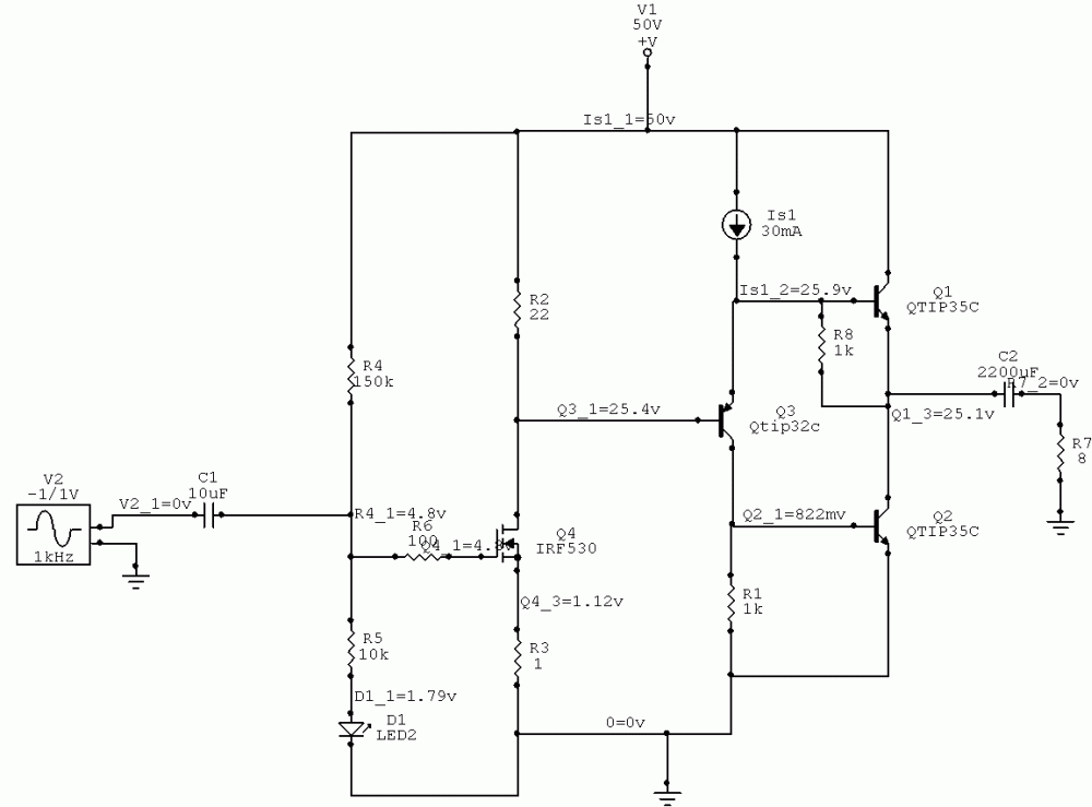

lineup said:The cure for capacitance is .....
...FAST ampere... which is why a cascode is worth an experimental representation here....IMO. I personally don't use an input stage capable of amperes.🙂
In a conventional 3 stage circuit using the 'amplified diode' bias for the output, a lot of the increase in current would be offset by the thermal tracking action of the transistor mounted on the heatsink, at least I would think so. With that much current available from the vas, drivers before the output would not be needed. This could also be delt with by simply adding a temprature sensing resistor that increased resistance with temp into the vas current source. Many ways that it could be made to work correctly without having to get too complicated.
