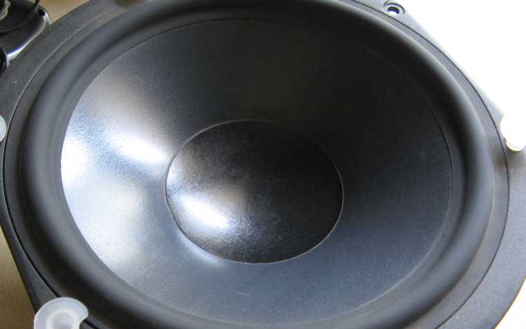

I have a Peerless 850490 8 inch bass driver. I wnt to remove the dust cap without damaging the cone.
Would anyone know what solvent will soften the glue used to stick the dust cap ?
Looks like a polypropylene cone. Will Benzene or Acetone damage the cone material ? The dust cap seems to be paper based (?).

It's always a bit iffy working on a speaker where you don't know the adhesives used, but I would try gentle warming first to see if that softens the glue. I use a hot air gun, but I've had practice, I recommend a hair dryer, or a temperature controlled soldering iron with a wide bit set to very low and rubbed gently along the join. If that doesn't work, you can start on solvents, but try them with a tiny amount on a test patch first. I've had most luck with acetone applied directly to the seam with a 000 size artist's paintbrush.
Whatever you try, work slowly and carefully - patience is definitely a virtue here.

I removed the dustcap off my old dynaudio 21w54s (polycone with inverted dustcap) just by using a sharp blade and carefully lifting up the joint. No solvents were necessary.

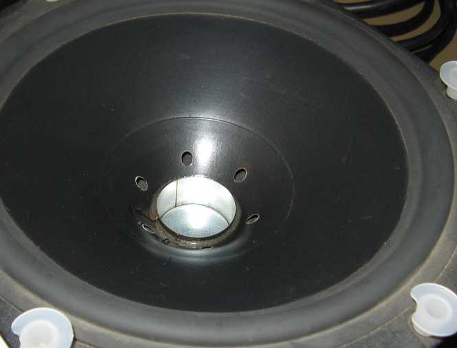

I used a small paint brush to apply Amyl Acetate along the joint of the dust cap and the cone. After 15 minutes I tried to lift off one corner with a sharp blade ( typical box cutter blade ). It did lift off but the glue layer did not lift off together ! I noticed that it looked like a rubber based glue. So I then applied Xylene all round and waited for half an hour and then applied some more again. After some time I lifted off the dust cap by going round with the blade and made sure that it came off 1mm at a time.
You can see the end result. The good thing about this was that the dust cap is fairly intact except for some patches where I was in a hurry and some fiber layer has peeled off. The exposed side looks fine . So I can put it back if I find that it has not helped.

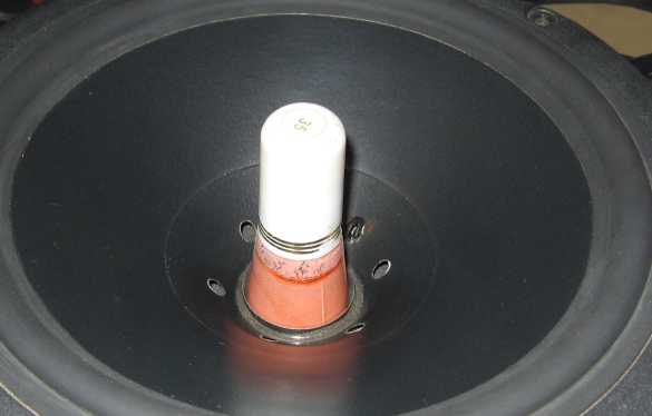

First I tested the driver in as is condition without the dust cap.
Lots of resonance in the open voice coil area.
Next I put in a nail polish bottle over the pole piece. The only thing which approximately fit in there.
Much better sound. Far better than with the dust cap in place.
So I'm happy the effort was worth it. Now the dust cap will not go back on. I'll have to deal with the dust problem , but no more dust cap here. I'll have to try out several different phase plugs to see what sounds best.

Problems..................
I just noticed that the cone has small holes at its base. That is an air leak between the front and rear .
