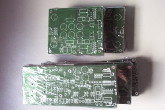

The PCBs arrived today, one day delayed. I will try to ship everything today and tomorrow.
-peter
After some hours of packing, all (paid) boards are on the way. All international shipping was done "air mail", in Europe You should get them in about a week, overseas in about two weeks.

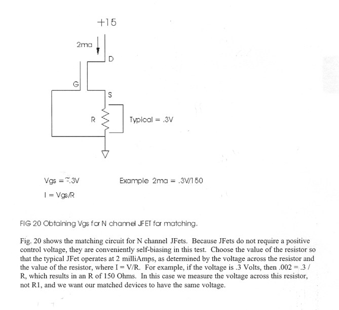

As far as I know, You should (at least) match the four JFETS of the MC stage, and the two IRF9110 (Q21, Q22) in the inverter. You can find info about MOSFET matching on www.passdiy.com .
For the JFET matching, I got a document
from Jens, it is attached as a jpg.

About 2SK170, it has different Idss classification:
GR(2.6-6.5mA),BL(6.0-12mA),V(10-20mA)
I can only purchase BL class, is it alright?😕
Do I have yo change any component's value?🙁
What is the best Idss or operating current of each FET and BJT?(2SK170,2SC1844/A991,IRF610/9610.......)

I used BL types, but just because I didn'n know better 😕 . Maybe can someone of the experts give us some enlightning? :idea:

I match 2SK170"BL" using the circiut parameter, that is the Rs=22 and Vd=15, and find out that the current thru fet should be 5-7mA.
I also check the chart on datasheet to figure out that the noise will be smaller when the current is larger in some degree.
SO......BL is right?😕
