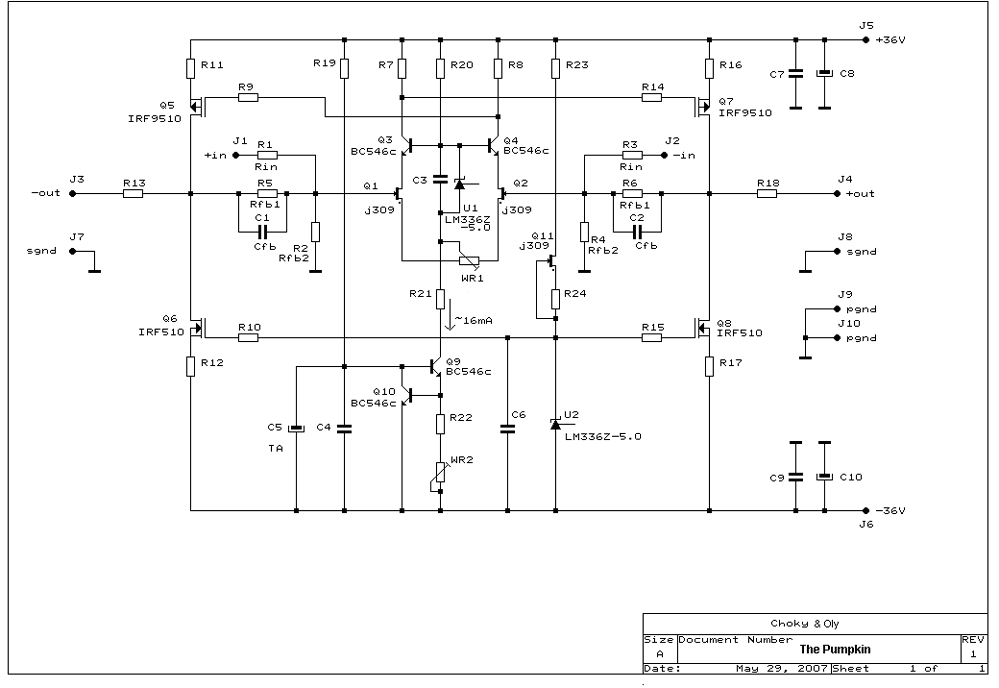

there it is

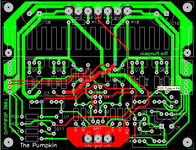

schm and render of pcb enclosed
now I'm waiting for pcb protos and heatsinks ,just to tweak some values - this time I'm lazy (or spoiled?) to make Ikebana prototype
I don't like to use nag nag protoboards where I can't see connection, contrary to Oly......pcb wizz with 100 yrs of needlepoint experience

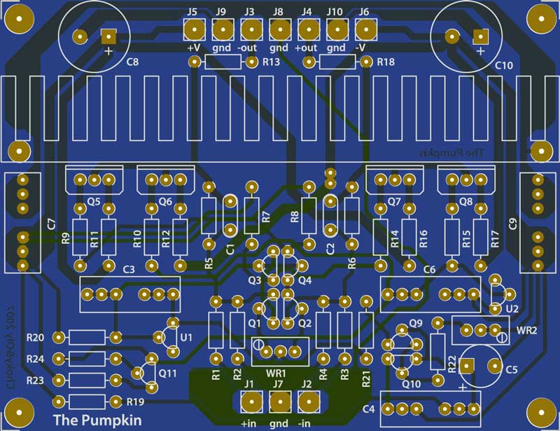

double sided pcb , in fact just several traces on upper plane
this preamp is intended (Steen again) even for F4 driving, with little more juice even headphones ; I'll certainly try it on my spks (sorta biggg headphones with 16 ohm impedance :clown: )

Babowana said:
Did you simulate all the CCSs, chky?
:darkside:
PS Last night farewell party killed me . . . :dead:
there is nothing simulated in that schmtc
I'm too lazy to learn sim proggies
in time needed to put schmtc in any sim proggie,I can use iron and parts instead......at least to gadgets I mess with
why..........you see something wrong........?
:clown:
"farewell" ..........to whom?

FastEddy said:
Zen Mod: regards Pumpkin ... I like it, quite interesting. That's a rather clever PCB layour, putting the heat sink in position to act a shield from the PS input & connections ... I'll bet your PS transformer is intended to go on that side of the 'sink as well ... ;)
xformer is intended to go on other side of house :clown:
Oly is clever half of Pumpkin team.........hehe
I'm there just for bothering ..........:bawling:

Babowana said:
A............
By the way, no R values? Just wondering . . .
:darkside:
they'll be here after thorough check ;
goal is to achieve DC stability ,to be able to use it DC coupled
in this way - without values , I think that will be less questions in first time......."why is this//why isn't"
