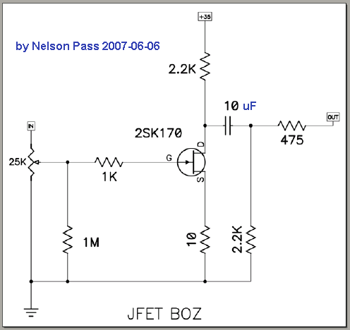

Nelson Pass said:
Maybe you would like to try this first.
mpmarino said:
That's way too complicated.
You must be joking, mpmarino 😉
It is as simple as it gets!
Most of the time we wouldnt even need an input cap.
My question is only
shouldnt those resistor values be adjusted a little bit?
I mean the Drain resistor, 2k2 and Source resistor, 10 Ohm.
These are contributing to BOTH setting the current in
2SK170 (what variant of 2SK170 is it? They come in colours ... )
But GainV, by bipolar formula is:
Load // 2200 // 2200
10 Ohm
Say we have a of of 10000 Ohm (10k)
and the voltage gain is 991/10 = 99 ... for a bipolar
Still for a JFET, even at half this value, we get a gain of like 50
Isn't this too much. Or maybe this is supposed to be An input of a RIAA Phono amp?
What current will this variant of 2SK170, with 10 Ohm?
I attach here the nice BOZ schematic.
It is a good starting point for true Nelson type of preamp.

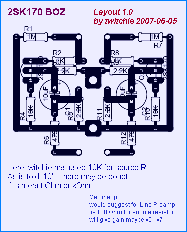

my first layout
I know this one is simple enough that most people will try it P2P, but I figured this would be a good lesson in Eagle for me.
Anyway, I'm going to etch this and try it out with a regulated (LM317T) psu ... wish me luck, and any recommendations or comments are welcome.
Thanks to NP (Papa) for this 😀
It's not labelled, but input is at the top (L&R) and output is at bottom. Large middle hole is +35V and large bottom hole is GND.
Hi Twitchie,
I look forward to your completion and impressions. I'm sure I won't get to it for quite some time. Amongst the majority of the company on DIYA I'm a hopeless newb but I think you may want to make room on the board for 10uf film caps. I'm thinking that with so few parts - selection may be more important.
Please free to tell me I'm wrong and I'll happily crawl back into my hole:xeye:
If am not mistaken, it should be possible to increase the source resistor to get a lower gain. But I am not sure how this would affect the operating area of the Jfet.
Second, is it possible to operate this one from a higher supply voltage (60 v)? I see that 2sk170 max. voltage is 40v...
What if we increase the supply voltage to 60v, Drain and load resistors to 3,9 K and the source resistor to 33 ohms?
I know these are basic questions, but....:scratch: :ashamed:

Here is a PNG image of your PCB suggestion.
I wonder if not The Master had intended source resistor = 100 Ohm
... what I can estimate, using my head only,
this would render a Lineamp with a Gain of like x5 - x7.
10 Ohm here, seems too little,
when the total Drain Lood impedance is like 1000 Ohm.
Gain is set by: 1000/(source resistor) x k
....where k maybe is something like 0.5-0.8
Let's see what comments Nelson himself has to give
( next time he can spare some time for www.diyAudio.com )
before we start decide for our Final Version.
Anyway, one resistor or two are easy to exchange ..
and for these circuits, will hardly be much smoke 😀
Regards
