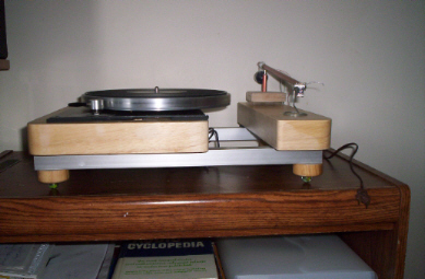

Hey Nanook - first I want to say you're an inspiration! I've reading some of your threads for awhile. In fact, your recent responses/posts on the AudioOrigami thread for the 12" arm Linn kicked my butt to do something with this arm! What kind of turntable do you have your 14" and 17.5" arms on in the photo?

the turntable is my take on a DIY turntable. Actually a "re-plinth". An old Sugden Connoisseur BD-1. A hardwood cutting block 1-3/4" thick cut and spaced away from each other a suitable distance to mount the tonearm. Aluminum square tubing, and the original feet.
technically my 14" arm is 12" effective, and the 17.5" one is 15". I haven't finished the 17.5/15 one. I hacked up a high carbon plastic headshell from some beater turntable, but I do do my own headshells too.
