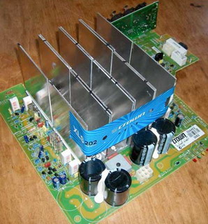

Finally i contact Anthony E Holton To Make this Spyder and
this is the photo when he came with fedex 😎

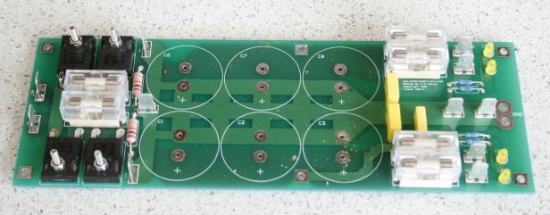

I buy PSU PCB from Anthony Too
but i have a little trouble now
can you help me guys, i can use
- 6.800 uf 63V / 100 V
- 10.000 uf 63V / 100 V
but the caps diameter max is 35 mm
can you help me to choice the caps for this psu
and if it is special caps
please let me know where i can buy it
If i use Blackgate it is good or just waste money here
please dont lie to me 😀

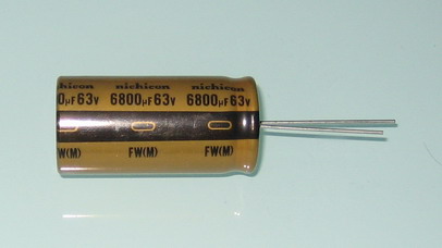

This is Ni FW 6800uf 63v for my back up

Hi Jeffry,
Your nichicon FW looks tiny , you better check the datasheet to make sure the ripple rating is sufficient.
Hartono
Hartono
FW 6800uF 63V

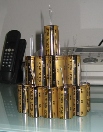

After i measure my caps and looks the nichicon diagram
http://www.nichicon-us.com/english/seihin/alm_mini/daia_f.htm
The size is right 25 mm x 50 mm
( I buy cause when i look AE Holton Psu space is 30mm )
This is very cheap wanna buy it ? 😀
Hii Hartono, where are you ?
this is my HP number 08158772900
go to sms man

look another
because it is very cheap so i make them as backup
so i look for another better caps 😀

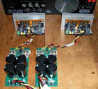

Here is what I did with my NX150 assemblies: http://3dotaudio.com/ampics.html
The completed stereo amp is now at home and connected to a pair of Maggies ( http://www.magnepan.com/_mmg.php ).
The amp runs very cool, each heat sink is ~~ 90mm x 125mm x 20mm (fins) aluminum, drilled to accept brass screws and "thumb" nuts, all bolted to the bottom of the Crown chassis ... with no fan.
Each "ready made" PSU filter board is from aussieamplifiers.com as well and each board contains four (4) black Nippon Chem-Con 10,000 uF (100 Volt) capacitors which measure 35mm x 54mm tall. (I have only one (1) PSU board installed in the Crown chassis for both amp modules (unlike the pictures) = 40,000 uF total for the two amp modules.)
The Crown chassis & torrid transformer pictured is 400 VA, 48 VAC with center tap producing +67 / 0 / -67 VDC ... so the 100 volt capacitor rating is necessary for this setup. (Note that +/- 67 VDC is slightly higher than aussieamplifiers.com 's suggested maximum for the NX150, but it works just fine and the transformer is also quite cool temperature.)
Internally: signal interconnects are twisted pair #18 AWG stranded silver to gold plated RCA inputs and fine stranded #12 AWG speaker output cables to the original Crown speaker connector board (with rolloff filters ~ 100k Htz.). I added gold plated spade connectors to the amp modules, but this was not really needed.
Shortly I will be adding a third NX150 amp module to the chassis (with associated summing circuit and low pass filter) for a sub woofer, all driven from the same torrid transformer and PSU board.
... It all works very well, very low heat, no smoke, no stink ... The NX150 is a flat, full range voltage follower / current dump MOSFET amplifier with no suprises. IMOP the sonic results are very nice indeed with plenty of gutsy bass and bright highs ...
(Input is from a Bottlehead.com tube pre-amp 😀 )
(I also have a pair of Anthony's NX500s ready for in another amp box = PSU to be determined ... 😎 )
