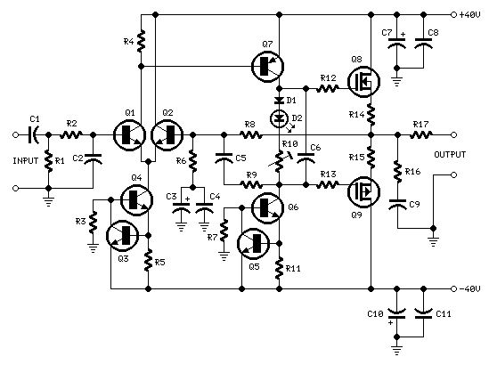

need opinions about this circuit a 60W MosFet Audio Amplifier

I would be very wary of this change to the bias temperature compensation.In the original circuit, a three-diode string was wired in series to R10. Two of these diodes are now replaced by a red LED in order to achieve improved quiescent current stability over a larger temperature range. Thanks to David Edwards of LedeAudio for this suggestion.
