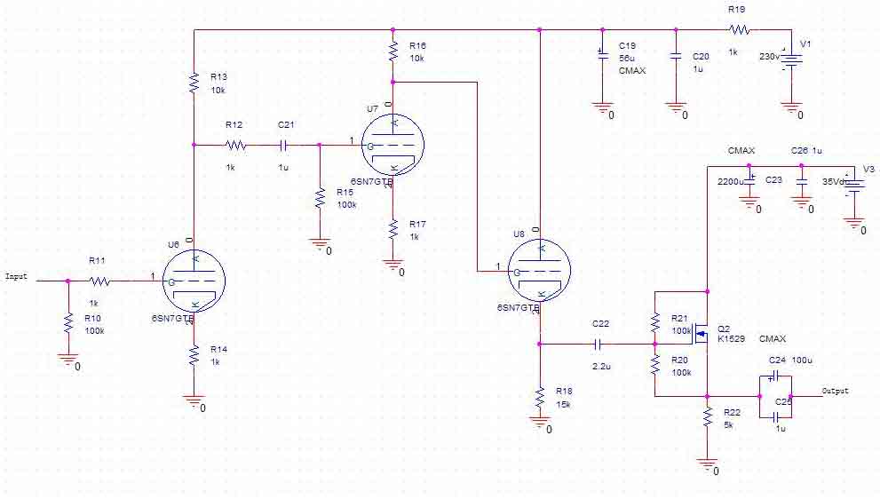

I have a hybrid Bada ph12 headphone amp with blown MOSFET, which I want to rebuil/mod. I don't want to deal with MOSFET any more. I am going to rebuilt it as all tubes.
The ph12 has three 6SN7 mounte on PCB. B+ power supply is 230v. Heater are from 3 7806 regulators.
I want to re-use as much as possible what is on the PCB. Any suggestions?

OK, I did a quick test today to connect my HT600 headphone dirctly to the 2.2uf cathode follower output capacitor, and I got loud enough volume - about 11:00 o'clock for normal listening.
So if I replace the 2.2uf CF output cap with a larger one, it should be OK for my high impedence headphone.
To get more amp to headphone. I am thinking to put a small output transformer between the CF and headphone. Anyone has a schematic for a parafeed tranny?
If you want to increase output power with 100% tubes, two ways can be studied:
The first solution: add grid coupling capacitor betweem u7 and u8, convert ub8 into a commun-cathod amplifier, add a transformer in the anode to adapt any headphone impedance.
The second solution: don't touch the three present tubes, just add one extra tube as last stage amplifer with transformer. The impedance of the transformer will be defined by the added tube.
All I need for 300 ohm headphone is 3v-10ma output. I am thinking I can skip the CF and add output transformer to U7 stage.

After a few iteration, my current PH12 is all tube head amp:
one 6SN7 common cathode direct coupled to two 6BX7 white cathode follower
Not my favorite one - none of my WCF amp is my favorite - but I have a lot of tubes I can roll.
