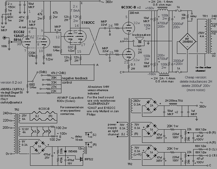

I actually found your website a couple of weeks ago while I was trying to help another member with his Cuffioli OTL.
Since your amp seems to be inspired by the same topology I wondered if you care to solve something I have a lot of trouble understanding:
On his latest version he shows a single channel and three separate secondaries for the bias supply.
One is common for both channels and naturally if left this way adjusting one channel naturally changes both channels simultaneously.
What bothers me most is that biassupply connection C appears to be common to both channels.
How on earth can this work?
Why did he not use four independent bias supplies?
I would appreciate any clarification on this since Mr.Cuffioli has not yet replied to the e-mail sent by our fellow member.
Thanks,;)
Frank,
Just seen this and having a quick look....
As I read it C would be connected to the -160V rail of just one channel so the bias volts are 'referenced' to this point and each channels bias is tapped off via 68K resistors... I guess we are assuming A1 operation...
I think this will work but it means that the two channel will be biased differently by the amount of the of the difference in their -160V rails...not ideal.
If point C is common to both amps - then the -160V rails are tied together... should also work I think providing the last psu cap is a true ac short (this is a valve that is happy at vhf+ and we have common grid connection if this isn't true!)) ... but there are going to be some interesting circulation currents in the psu...and the failure modes would be doubly spectacular!
What have I missed?
James

Hi James,
This is precisely what baffles me.
I think the best solution would be to use four bias supplies.
If C is really common to both channels it would be degrading stereo separation to such an extend that it would be rather ridiculous,not to mention dangerous.
Connection of C to one channel only would work but the channels would keep on tracking each other,whatever you add to one would be detracted from the other.
Neither one would be biased correctly either.
All OTL amps I know off are all AB1 and from what I see so is this one.
If I were to build such beasts for my own use I would definitely opt for monobloc construction.
Thanks,;)

Regarding point C in Andrea Ciuffoli's diagram I believe he intended to connect that to negative supply of only one channel. I tried that method earlier and found that there where problems to adjust bias for the 2 sides equally although it was possible to make it work also that way.
What I did later and still am using is to use one power supply for both channels with only one pair of capacitors. Altough this can seem strange it works very well also in theory given that the capacitors exhibit a low impedance in the audio range. If the positive and negative average supply currents are equal, which is true for normal audio signals, the connection points between the 2 capacitors will act as a virtual ground point and will not move at all and therefore it is possible to connect the 2 sides together without them interacting.
This setup is somewhat similar to what you use in microwave circuitry where it is quite common to work with virtual grounding, I have a background in that field and usually try to see similarities when building audio circuits, (it is only the frequency band that is different, the theory is the same).
In reality it works very well and there are no problem what so ever with stereo separation, I haven't measured it, (probably the only thing I haven't measured) but will do so in the near future, however there are no hearable leakage between the 2 channels and it shouldnt be.
Regarding safety and speaker protection I use ordinary separate fast fuses in the positive and negative supply lines, I am confident that they will blow before I destroy my speakers although I never had a tube failure (yet).
Regards Hans
