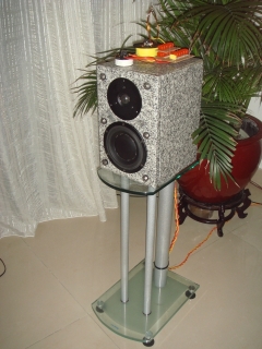

...well today I played around with the first attempt for a proper 24db/oct x-over...
Still not optimized and I will keep the wild outside set up of the x-over until the x-over is really ready, but already the first trial is not harmful to my ears.
Here the version in grey stone with MDT-33 Tweeter.
The MDT-33 has a nice character 🙂

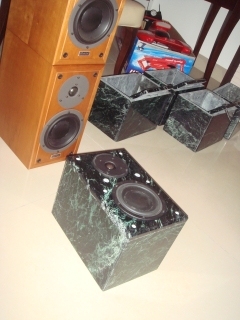

... version with Peerless 810921 in green marble to come..
BTW regarding all these stone and marble things I was quite concerned regarding resonances of the stone/marble. Fortunately I found that it can be completely clamed down by installing inside a wood plate which is glued between the walls with addidtional rubber dampers. ...This method is turning even a bell more calm than most wood cabinets, -amazing.

How the story is going on:
Slow, very slow..
Sorry for that. Due to exciting oportunities in multiple areas I opened to many projects at the same time...
But regarding the MDT-33, we measured the frequency response and found a strong peak around 10kHz. Unexpected thing is that this peak is quite unbalanced. Morel is stating that they sell matched pairs, but in fact one piece has about 2-3db peak at 10kHz, while the other one has about 6db!
Another phenomenon was that absolutely everybody prefers the sound if the tweeter is connected with wrong (unflipped) polarity, showing a deep dip around the 2kHz crossover frequency. ...one case more where human listening perception does not correlate with the frequency response at all...
Despite all these strange findings, my ears still like these stone speakers more than my Dynaudio Contour 1.3 ...
