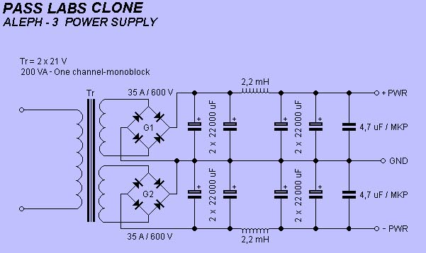

hi
According to this web site 400 va for both channels
but for me ?? it s a minimum
bye
