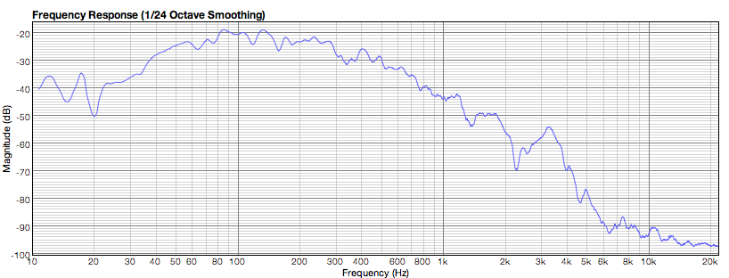

You sure have more experience than I have with OB, your speakers are quite compact for an OB. But I don't even doubt they sound like heaven...anymore....
Be building more of 'em, much much more:cool: next with a really high Qts driver :smash:
navin said:
Even I assumed that a really high Qts (Qts > 1) was required.
Well from the measurements and from the experience I have nothing to complain about. I think a higher Q driver could have been smaller size and lower sensitivity. I just thought I'd start with overkill to create the necessary headroom to clean it up afterwards. But I don't feel I should change anything, like I said I'm totally satisfied! I don't even feel like using eq to boost the lowest freqs up. The driver has 40hz Fs and the system goes well below 50hz, which I find deep enough...
Bottom line is that the balance here seems quite allright, eventhough I think some adaptations are needed with low Qts drivers. But I see no problem in using low Qts drivers. High Qts will perhaps only give slight benefits...
I can only speculate on this for the moment, perhaps someone can explain it better or give a few nice examples? Pictures or measurements...or a link to....

v-bro said:
I think a higher Q driver could have been smaller size and lower sensitivity. ....
you give me hope. With a Qts of 0.44 and a sens of about 90db though I am not hoping for somehting nice in a OB config. Presently my subwoofers (130 liters per side) are nice but WAF dictates a smaller box. Hence I figured isobarik (box size would be about 40 liters) untill I saw that beautiful OB picture.
Isobaric is nice to save space and still have very low roll-off, but OB scores a lot better on low distortion. Note that my OB is helped a lot by the floor (by putting the baffle in contact with the floor it also becomes part of the baffle, I also placed the woofer pretty near the floor. This will raise distortion a littlebit, but still waaay better than conventional enclosures) So bass response is very very good IMHO.
I think since you allready have the 12" drivers you should just try it out. Build one baffle first and see (hear ;) ) what happens... Just use some cheapo fibreboard or an old (but massive) door like I did.... it might still lead to satisfaction....depends much on the top-end as well offcourse. And whether you have separate level control to match the volume....
My drivers were less ideal than yours if you ask me, and I'm VERY satisfied with the result. I don't care that they are big...
Bassdrum hits my stomach without being boomy, and I can follow very exactly what the bassquitar does in songs where I didn't even notice the bassplayer much on my previous subs.....
