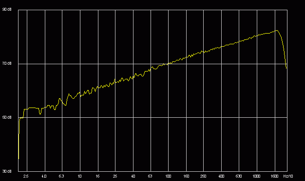

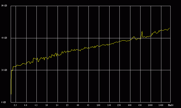

The other day I downloaded a trial version of Spectrogram 7 http://www.visualizationsoftware.com/gram/gramdl.html very useful even in the demo version BTW. It is an audio spectrum analyser with a wiggly line, 1/3 octave, and coloured mess display. For best results you need to use a calibrated microphone of course, and the software has an input equaliser to flatten the respone of the mic you are using. Ater thinking long and hard, I hit upon the idea of using the air hose from my compressor and blowing the air past (not into!!) the mic and recording the results. IMHO it is almost a perfect white noise source that rises at 12dB per octave as it should. Just a matter of fiddling the mic equalisation till you have a upward ramping straight line, then away you go. 😎

How did you determine that it was a true white noise source, and didn't have some other similar law?

This is the equalised microphone response. I don't really know that it is true white noise but it certainly sounds like it. The equalised microphone measurements now make a lot more sense than what they did before.
On this last pic the vertical scale is 30dB per division, not 20dB like the other two pics.

Yep, I'd go with that too.
Few things in nature have a "droopy near the top end" law.

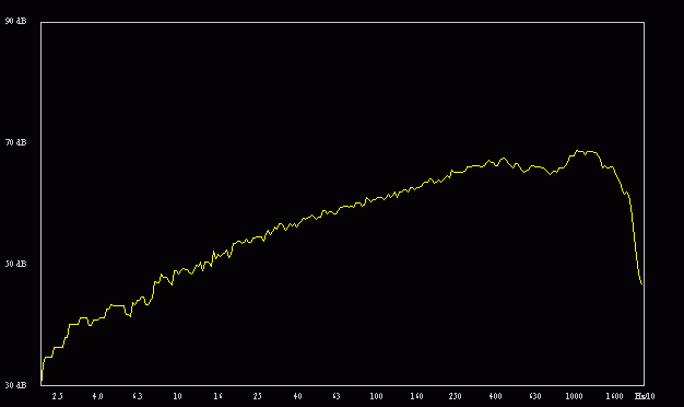

One thing I should mention is that I used the bare microphone insert. It used to be inside this plastic housing complete with clip, and there was a 2mm hole about 2mm deep through which the sound travelled on it's way to the mic. This made the response just rotten. 😡 Shown below is the original response to white noise.

Everyone here has a pc, most of us can afford a $2 electret microphone, all of us like audio. You can plot frequency response graphs of loudspeakers if you feed them pink noise and use the software mentioned in the first post. Trouble is, the results are only as good as the microphone you are using. You need a known source of wideband noise to apply to your microphone first and see how it behaves so you can set your spectrum analyser software so the microphone frequency response appears to be flat with pink noise. (actually rising in the case of white noise) High pressure hissing air (100+ psi) seems to be a reasonable and reproducible example of true white noise .

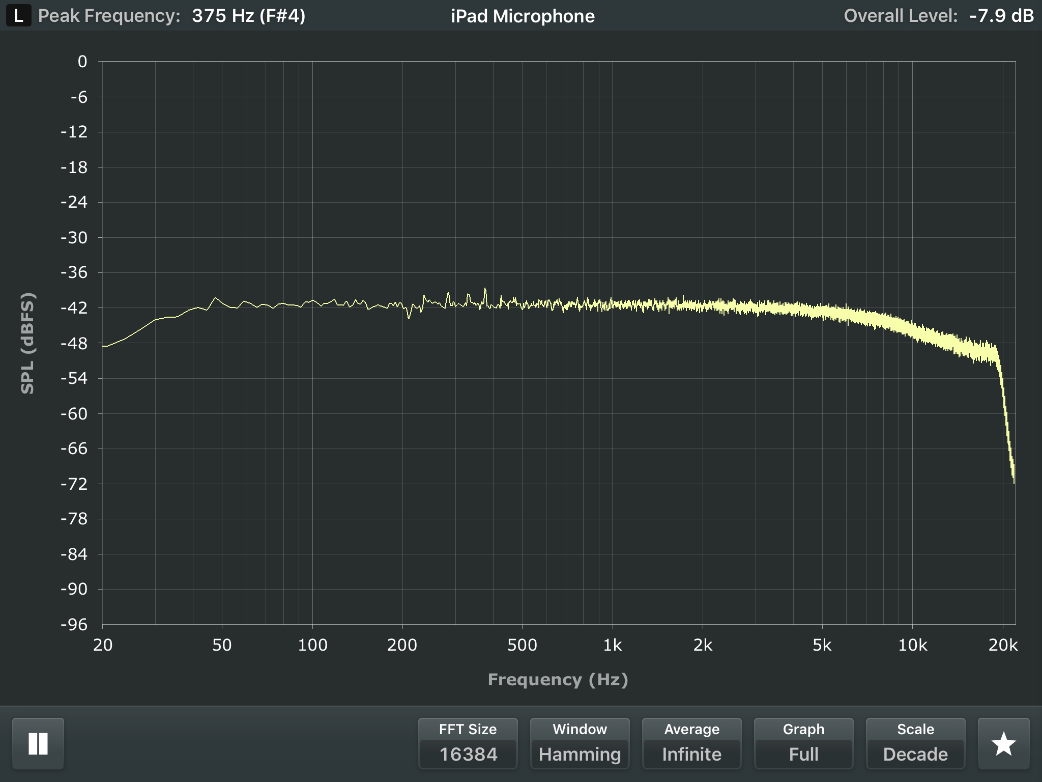

This is the same test using the inbuilt mic on an iPad Air.
App is FFT Plot.
App is FFT Plot.
