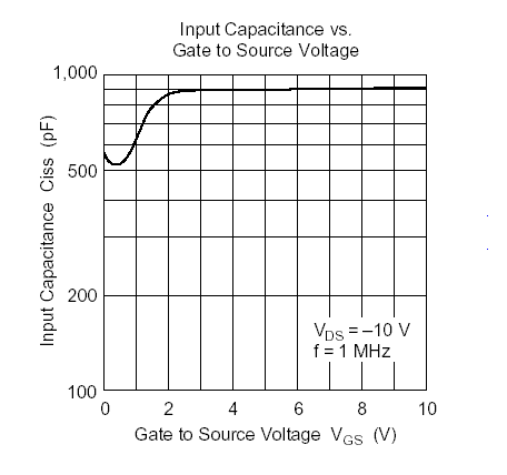

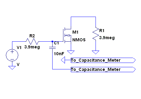

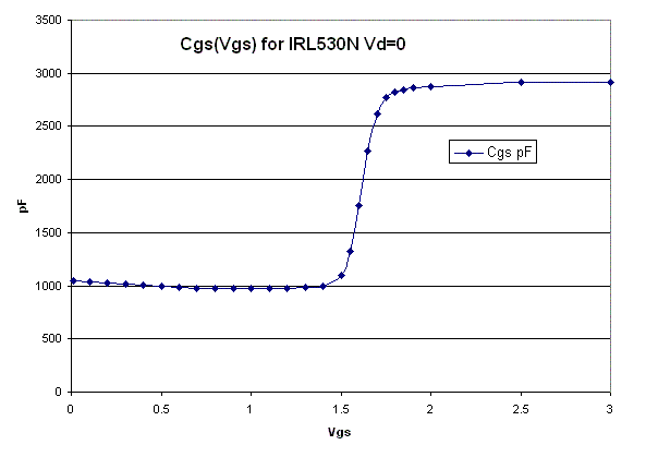

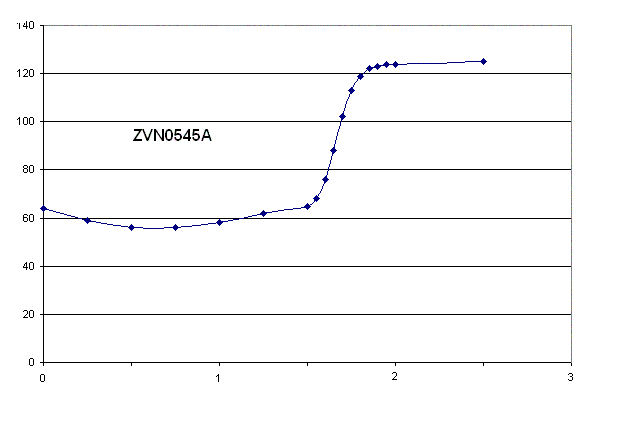

What I did was to measure the Cgs capacitance with a capacitance meter (1MHz 10mV max) sweeping the Vgs from 0 to Vth and above, leaving the drain connected to the source through a resistor (Vsd=0, Id=0) . Tomorrow I will show my data for a small VMOS from Zetex ZVH0545A and a logic-level power VMOS IRL530N. I've found that the static gate capacitance measured this way is indeed increases over the threshold region by 2 to 3 times for a very small increase in Vgs.
Apparently this change has a very simple explanation - when the channel of the MOSFET is off, the area of the channel itself under the gate is essentially isolated and Cgs+Cgd consists only from a capacitance between the gate and the metallised source/drain connections. When Vgs reaches the threshold level the channel begins to conduct and the area beneath the gate connects to the circuit, markedly (2 to 5 times) increasing the input capacitance even without the Miller effect - in fact even in the abcence of any drain current! If you put some voltage on the drain it somewhat changes the shape of the curve, but not the character of it.
As you can imagine in an audio amplifier there are many cases where the Miller effect is not really present - i.e. in a common drain follower configuration of the O/P stage. However in a class AB amplifier the Vgs of the output devices goes through the threshold region and that kind of a change in the input capacitance of a MOSFET could be quite significant in understanding of unlinearities in such a stage, especially at high frequencies.

First picture is for ZVN0545A @ Vds=0

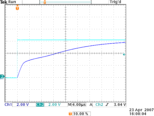

The picture with a small MOSFET ZVN0545A on the other hand confirmed my previous measuments for Vds=5V quite accurately, thought the method was different, which is a good indication of a correct result. I attach here a screenshot from a scope. Ch1 shows the voltage on the gate, Ch2 shows the voltage from the pulse generator. Between the generator and the gate there is 100K resistor. Vds=5V DC and decoupled by 100nF. My current thought is that a small MOSFET has a different structure and behaves differently. From the curve for lateral MOSFET 2SJ162 in my earler post it looks like lateral devices do suffer from this effect much more than power VFETs and that small MOSFETs are similar to them. I'll try to get some more samples of different FETs and see how these measure.

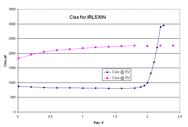

Continue measurements and, unfortunately, my previous observation about VFETs are incorrect. After a proper setup was made I've measured Ciss (input capacitance) for IRL530N properly for Vds=0V and Vds=5V, on top of it I've repeted my pulsed experiment for this transistor for different drain voltages (from 0 to 4V) and it appears that the "jump effect" is present in force. Here is the scope trace at Vds=3V similar to the previous for ZVN, however in this case the series resistor was 3.9K to compensate for a higher input capacitance. Note, that the trace is for a constant Vds unlike the traces usually found in the gate charge graphs, where Vd changes and Miller effect is present.

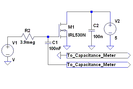

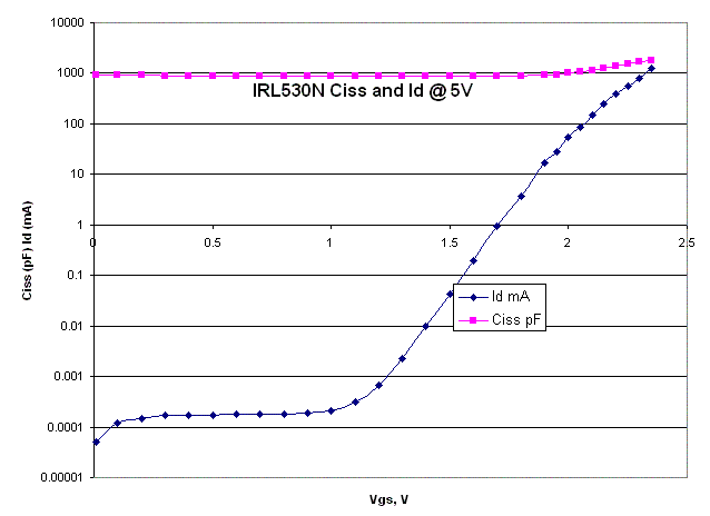

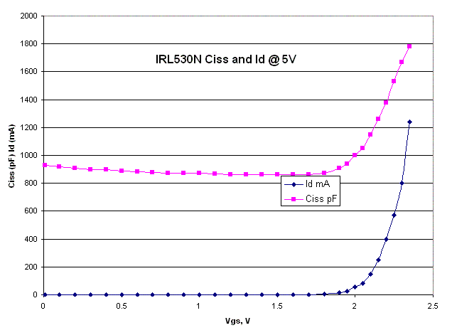

Some more results for IRL530N . This time I've decoupled the drain by an additional 4.7uF to reduce possible Miller effect at higher currents where 0.1uF presents an impedance large enough to affect the result. This time I did measure the Id as well as Vgs and Ciss. First picture shows Ciss and Id variation v Vgs for Vds=5V .
