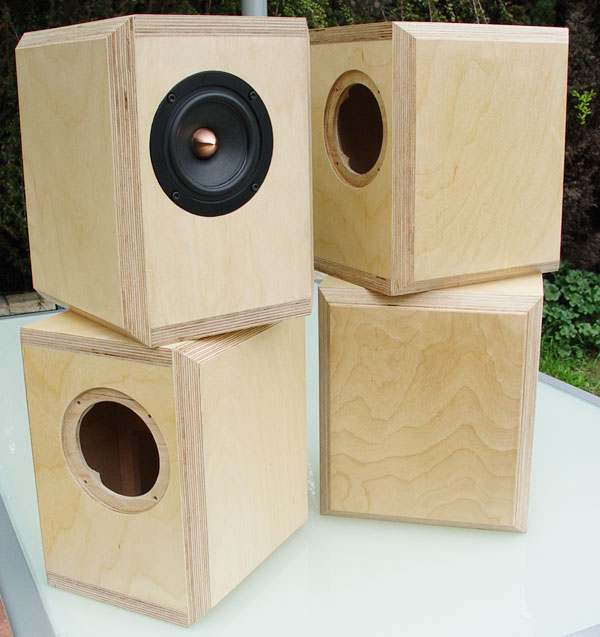

So when do we get to see to photos of this new creation? 😀

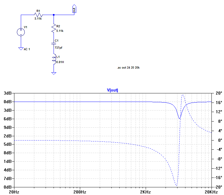

Bizaare. I've just designed my first active eq filter without using any active components :xeye:
The notch calculation seems to have worked a treat. Let me know if the result matches yours.

Vikash,
You're part of the way there. However, note the value of the inductor. It's very large. 🙂
Substituting the L with an active inductor is the fun part.

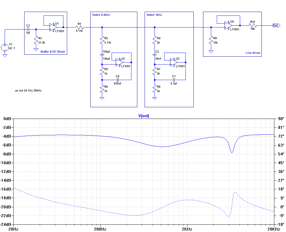

This is the complete filter design. Any feedback appreciated.

The results of your first simulation appear to match mine perfectly i.e. your Q is too low as well! Your original post said the width of the notch at 3dB is required to be 1Khz (for a Q of 6.5) but it looks larger in the simulation; approching 2KHz, I'd guess.
Can anyone here explain the discrepency?
Just a couple of points...
I'm not sure if you intend to have R9 in the circuit or not. It's not really doing any harm but is adding constant attenuation across all frequencies.
When designing the PCB, you may want to add a spare parallel capacitor to positions C1, C2, C4 and, erm, "700pF" to allow you to do somw fine tuning of the values.

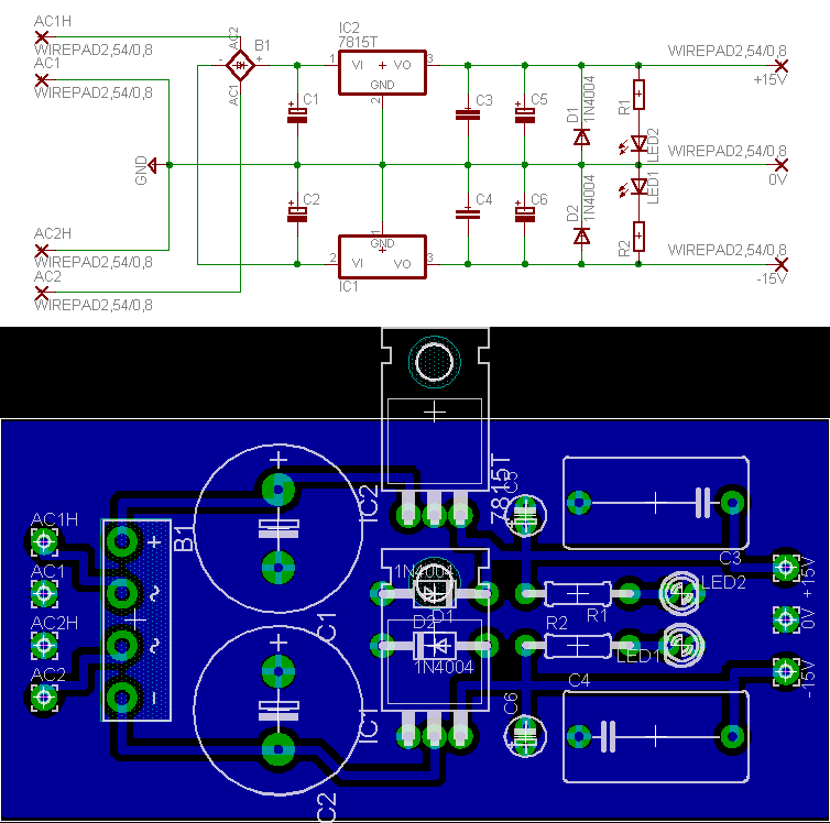

In preperation for designing the eq filter PCB, I've attempted to first do a simple regulated PSU to power it. Again, any feedback (of my first ever PCB design!) is appreciated.
Eagle has a less intuitive UI- than Speaker Workshop even! 🙄 Getting there slowly though...

If you are going to the trouble of making PCBs for all of this, would it not be a good idea to include a shelving network for bafflestep compensation? And possibly also add in a highpass to cut out the frequencies the driver isnt producing, thus increasing power handling, and also giving flexibility with using a sub.
Just a thought.
Matt
Edit - the PCB looks fine, as a tip though, its useful to make the pads as large as they can be whilst being functional, this makes soldering and drilling easier. Also make the tracks as wide as they can be, especially the ones handling power.
Hi there Vikash,
Your PCB looks great for a first effort! My only suggestion would be to thicken-up all the tracks - not to increase current capacity, which isn't really needed for this circuit, but in case some of the track etches away. I've made plenty of PCBs using the blue Press 'n Peel sheets and I don't go below 0.030" for track thickness for this reason.
I know you said you wanted to use parts from the good ole' spares box, but I believe it's worth ordering a few surface mount parts (100nF decouplers, 1K, 10K resistors etc) for any future PCBs you might make, simply because it reduces the amount of drilling required. Decent drills in the 0.6mm to 1mm range cost a couple of quid each so you only need to snap one to make the investment worthwhile.
