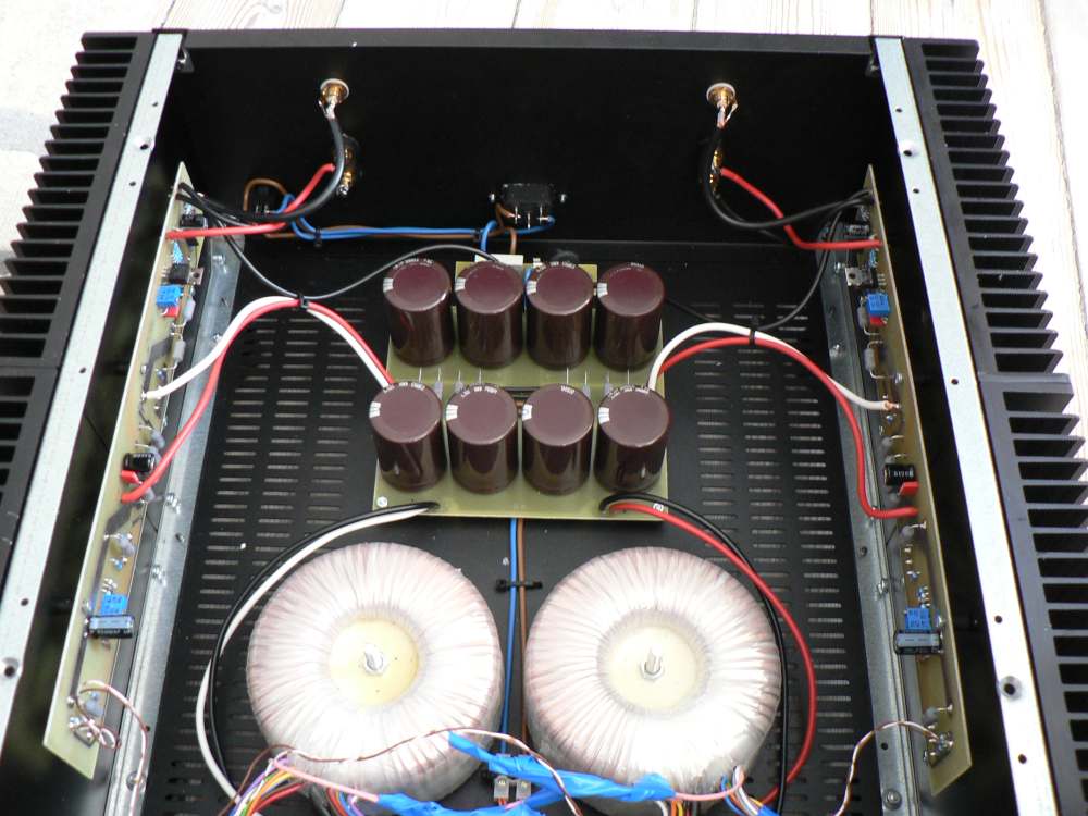

Well, I completed my version of the babbelfish a few months ago and took it for a small road tour to visit friends and family. Comparing the sonics to mid-end amps was just such a blast!
My brother wanted me to build him one, so I did. However in between I finished the F4 and was surprised how little noise it produced. It got me thinking and also the layout published in the service manual gave me a few pointers on how to better my design.
GRollins has also given many useful pointers on using jfets and I have tried to absorb some of that information into my
Changes:
- The input seemed very sensitive to fiddling with cables so I lowered the resistor values in the input and feedback.
- I removed the decoupling capacitors because I had a hunch they only provided noise to my signal ground.
- The input ccs was changed to aleph style with irf9610 and zener.
- And a few other small changes to make it more like aleph30.
- Source resistors on the 2sj109 input pair was reduced to 4R7 to get better bass
I started soldering Friday and delivered it Saturday, so I had little time to testing and comparing it to my other amps.
In overall it turned out pretty good. The bass is definitely louder and noise is greatly reduced. The turn off thump is also removed. I suspect the ac gain might be slightly too high, but I didn't have time to check it.
As mentioned, I didn't have time to thoroughly compare it to my own babbelfish, but to my ears it sounds better. A very nice amp indeed!
I have attached the schematics.

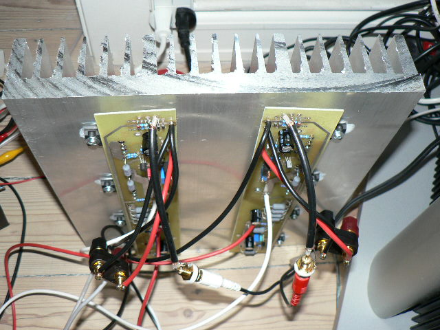

Yesterday I built another one of these fishamps and hooked it up on a piece of heat sink so I could do some listening tests - I was not completely satisfied how the bottom end turned out on the one I built for my brother. But I was in a rush to complete his amp and didn't have time to compare it to my old amp.
Now I have done that and found that it sounded very mellow in comparison. The problem turned out to be R131 a drain resistor on the negative input resistor. When I decided to include it I was only concerned with easing the voltage on 2sj109, but it turned out that it seriously changed the sonics. Now I have shorted it and the amp sounds wonderful!
It does not reach the detail and control offered from my F4, but it still is a very nice amp indeed!
