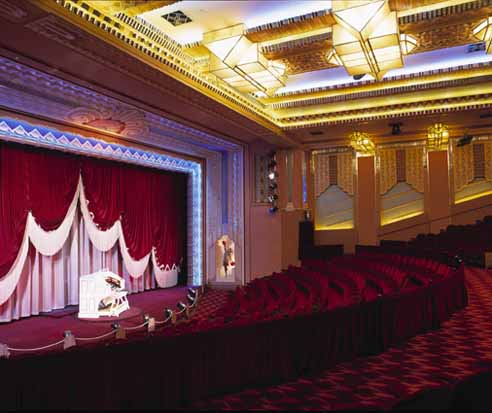

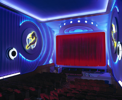

Here is a cinema that I designed, costum built and installed the speakers for, it was opened in 1995. The acoustics are very good because of the 3d plaster effects break up the sound. Backstage is damped with black tissuefaced fiberglass that is 3.2 kilograms per sq meter. Speaker boxes are 2x15 inch and a 2" horn each mounted flush it own custom wall. 1 x 18 inch sub. seating 350.
This 750 seat cinema for many years featured lots of 4 inch full range speakers for its surround channel, that I concealed behind the extensive plaster work around the auditorium, in areas less than 10cm thick. Dispite an auditorium being over 110 ft wide, these speakers did survive running TITANIC in 70MM. Backstage is ALTEC a4s x 5, modern JBL 2" horns, and a 4 stack of EV 18 " subs operating flat from 25 hz.

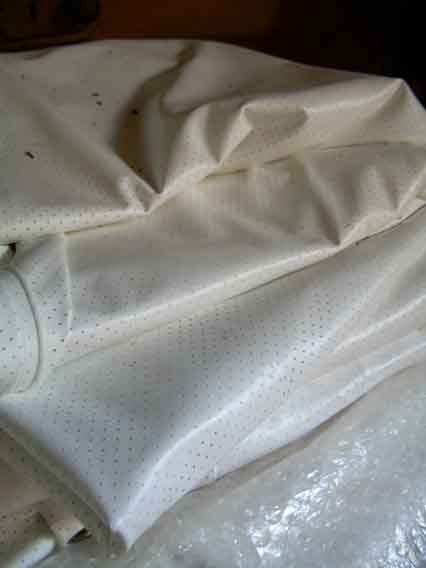

Also in a perfect world we would all have a perforated screen and have the front array behind it, failing that the layout I sketched above is a good compromise. You have plenty of room to play with though, how about adding another wall a couple of feet infront of the front wall with the screen in and building the front speakers into it behind a perforated screen? You could have racks either side of the screen housing your electronics and subs either side of the screen at floor level, that way everything except the projector and surrounds is togeather and easier to wire up/keep tidy 🙂
