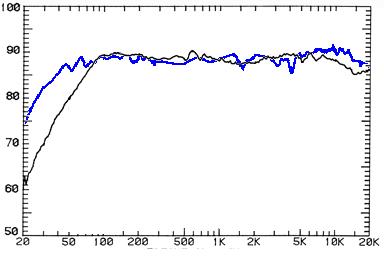

Hi phn,
I overlaid the 2 (ignore the scale on the side, it's not correct for both) after adjusting for size. The Stereophile one is in blue. It has more lively 'peaks' and 'dips' - but as I said in my previous post, I'm not sure if the measurements have been smoothed for the "Best Loudspeaker". I know they have been 'adjusted' in the Stereophile, but I don't think JA smooths them very much...
Tenson, it is a silly claim. But I don't think that the THD+N is average. Check the latest Quads (in Stereophile, I think) for amazing claims against incredible distortion...

http://www.soundstage.com/revequip/energy_c3.htm
http://www.soundstagemagazine.com/measurements/energy_connoisseur_c3/
Nearly as flat on-axis
Better off-axis measurements
More bass
Significantly Lower distortion
$27,500 cheaper
More bass
$27,500 cheaper
