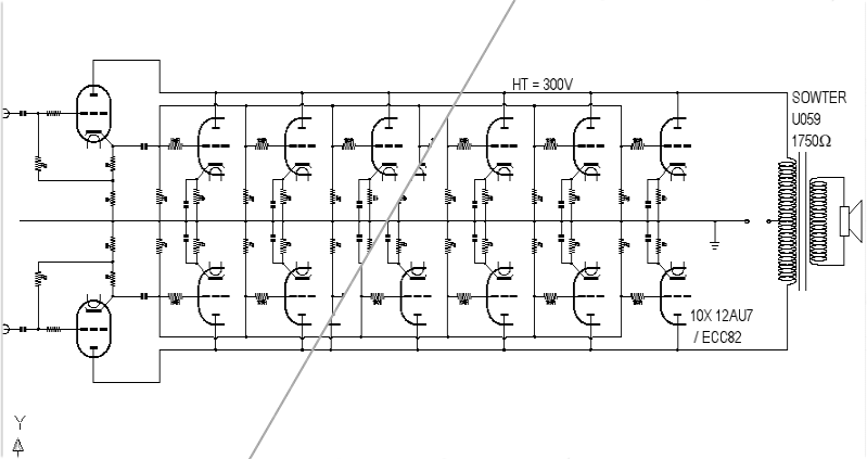

Hmm
YEP! would love to see the schematic... wonder if its anything like the attached, probably not if theres 20 watts available...
I've run the numbers through TCJ's push-pull calculator and all I can come up with quickly is 10 watts for the 12AU7 (ECC82) thats at 300Va / 9ma / 1750 load
I guess that the ECC82 / ECC83 are reversed. I couldnt get any sensible figures for the ECC83 - not enough current.
And its at this point I'd drift towards bigger tubes - a similar number of 12SN7 gets around 16-17w straight away (400Va / 9ma / 2250 load)

Re: Hmm
The reason I asked in the first place is that I have a box of twin-triodes at home (cannot remember the type but not ECC83/82/88 ) and I thought it would possibly make a good project.
Andy, Care to flesh out your schematic with some more numbers ?
Where is the TX available from ?/
Andy

kevinkr said:Personally I think you would be hard pressed to get 20W out of 10 12AX7A in parallel, the only way I think you could do this is running very close to class B operation.
SY said:Running into the grid current region.
Brian Beck said:
As Billy Bob Thornton says in "Sling Blade", "Uhhh...Huhh".
So, is 20w pc possible ??
Andy
I believe so, if just barely. The idea of running 12AX7A into the grid current region of operation is disturbing..
