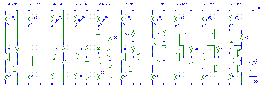

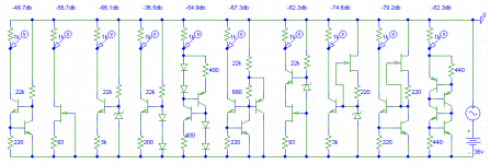

I am looking for an "ideal" ccs, i attached a small collection of 9 different ccs circuits, all rated with a psrr. This db value is the voltage ripple visible at the 1k resistor with the power supply contaminated with 1v AC, all ccs giving ~3ma. The LED style is missing because i have no model...
Did i forget other / better circuits ? Right now the cascoded jfet-ccs seems to be the candidate. Number 9 is also very interesting as it is floating style like a single jfet-ccs.
What i want is a ccs with high psrr, but not too complicated.
Mike

MikeB said:
I am looking for an "ideal" ccs...
Those are somewhat at odds. I have read references on this forum and AA that Gary Pimm's hybrid CCS is the cat's meow, but it takes some effort to implement. His MOSFET CCS is again very well respected, but it is more complex than those circuits you listed.
If you search for CCS or constant current, you will find MANY threads.
As far as PSRR goes, Self presented some measurements indicating that adding a decoupling cap impoved the PSRR of several different CCS's to where they had about the same low figure. He claimed, but didn't present data tables, that a sufficiently large cap would drive the PSRR too low for him to measure. And below what any CCS achieved on it's own.
If this is valid, the choice would be to choose the CCS that gets you the best current stability then add the decoupling chain.

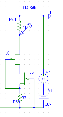

I made more sims, also adding the "self cascoding" jfet ccs. (see attachment)
The self cascoding shows an impressive -114db...
Than i ran a transient analysis to check stability of these circuits.
I quickly rejected the "self cascoding", it has ringing like hell, asking for problems. Also i rejected all circuits showing any ringing or beeing ugly slow, this left over 3 circuits, the zener referenced ones and the cascoded jfet.
Number 7 (the cascoded jfet) seems to be best option regarding psrr AND stability. (the most stable one)
2nd choice would be Number 3, simple but efficient and stable. Better than my favourite (until today), the No1....
