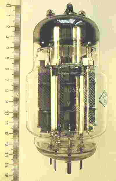

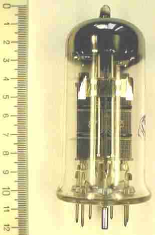

Any other tubes that canbe used with lower DC voltages?
Well for the bass amp you could use a pair of 6c33's (6s33s)
The tweeter amp could use it's samller brother, the 6c41c(6s41s)
These are low voltage Russian types, both extensively used in single ended designs, but there is no reason not to use them in PP.
Having very low Rp makes transformer design easier.
I have never even heard of these tubes. where would one get them? what do they cost?

6c33c (6s33s)
Unusual looking beast, rather high heater requirements, but the lowest impedance affordable NOS valve. Audio folklore (myth?) has it, that it was first found in a MIG fighter which "escaped" to Japan.
Datasheets can be found at Frank's site . They are too large to attach here.
(Search for 6s33 and 6s41).
