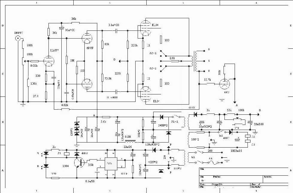

So dig out the schematic to look at modification possibilities (see attached):
Hang on - IIRC the larger anode resistor for a cathode coupled phase splitter should be on the cathode coupled side, NOT the "straight through" side as shown in the schematic.
Off with its lid too have a look:
The 83K are in fact 4 x 332K in parallel, the 73K6 is in fact 75K consisting of 4 x 301K in parallel and the 55K "Tail" resistor is 75K (4 x 301K) as well.
Checking the first channel I find that the 83K is in fact on the cathode coupled side, that is the amp is correct and the schematic is wrong.
Checking the other channel and HEY the 83K and 75K are opposite to the first channel. A manufacturing fault.
I corrected this problem and Wow! a totally different amp. The stereo image is now quite acceptable and the "covered" sound has cleaned up significantly.

Another tweak to this amp - see schematic posted above.
Last weekend I deleted the 75K and 83K anode loads of the phase splitter. Replaced both with 50K (2 x 100K Dale 1W in parallel).
At the same time I replaced the 75K "tail resistor" with a cascode current source set for 3.7mA. The cascode was a red LED referenced BC547B/MJE340 with 270R as the current set resistor in the emitter of the BC547B. This improved the sound significantly.
As a last check I looked at the HV rail and the anode voltages on this stage. The extra current in this stage plus the extra 1.5mA I was putting through the current source LED reference had dragged the rail below the 360V at which the zener regulator was operating. Dropped the HV series resistor until the zeners were once again operating and rail was nominally 360V (3 x 120V zeners in series). This improved the sound significantly again - so maybe there is something to Allen W's shunt regulator theories!!!
