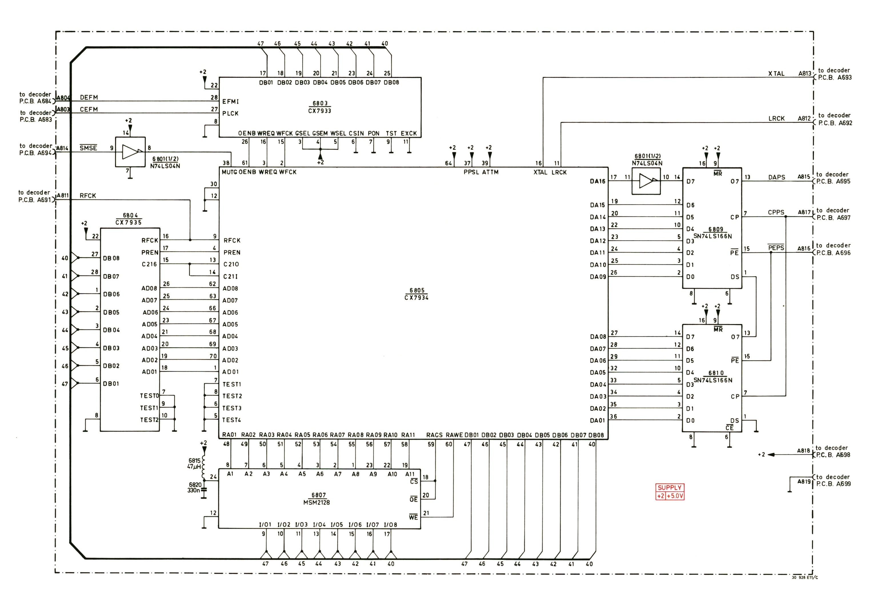

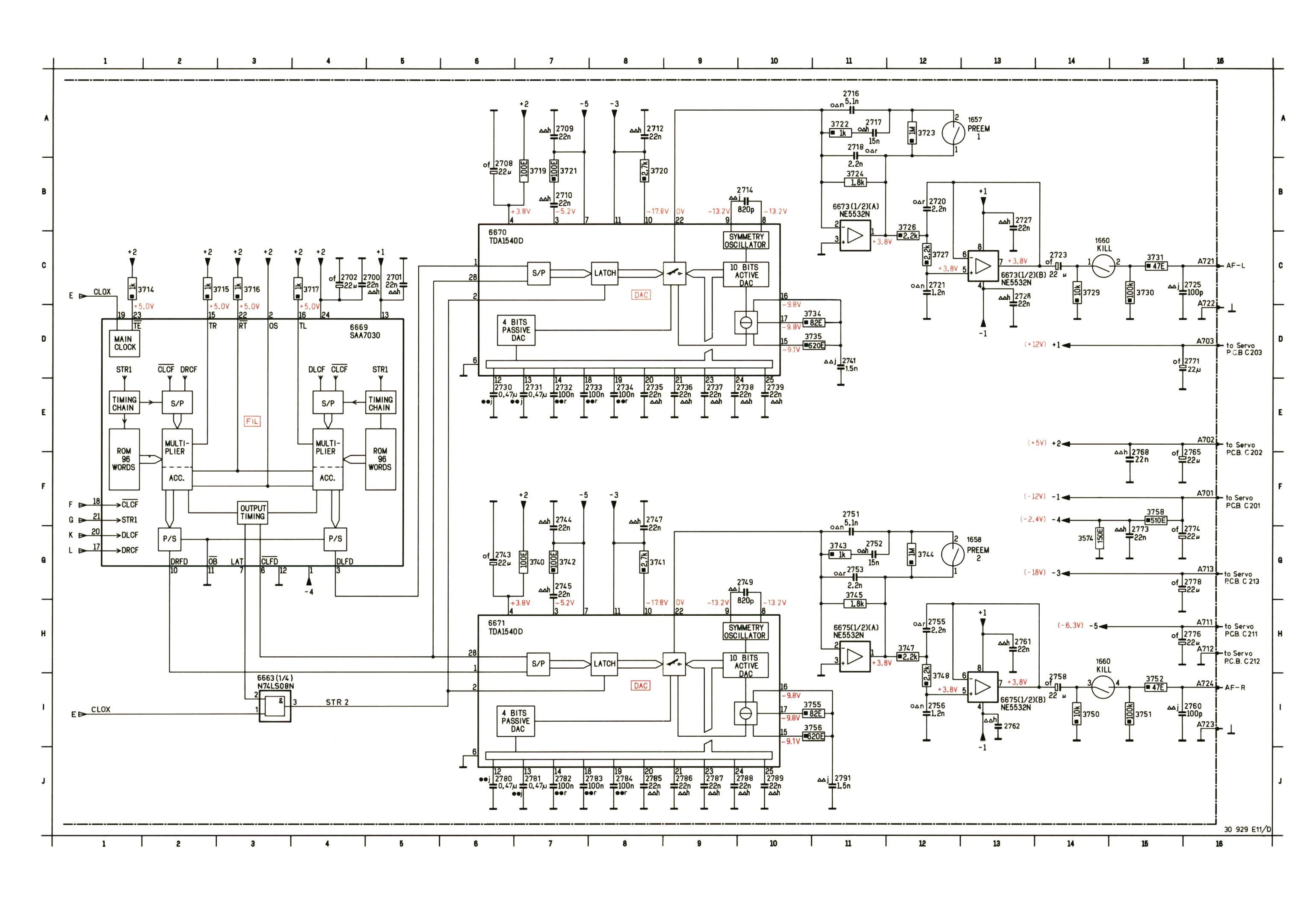

This schematic shows how Philips implemented this combo in some of their earlier players, before they got the yields of their SAA7000 and SAA7020 ICs up. They were usually preceded by a SAA7010.

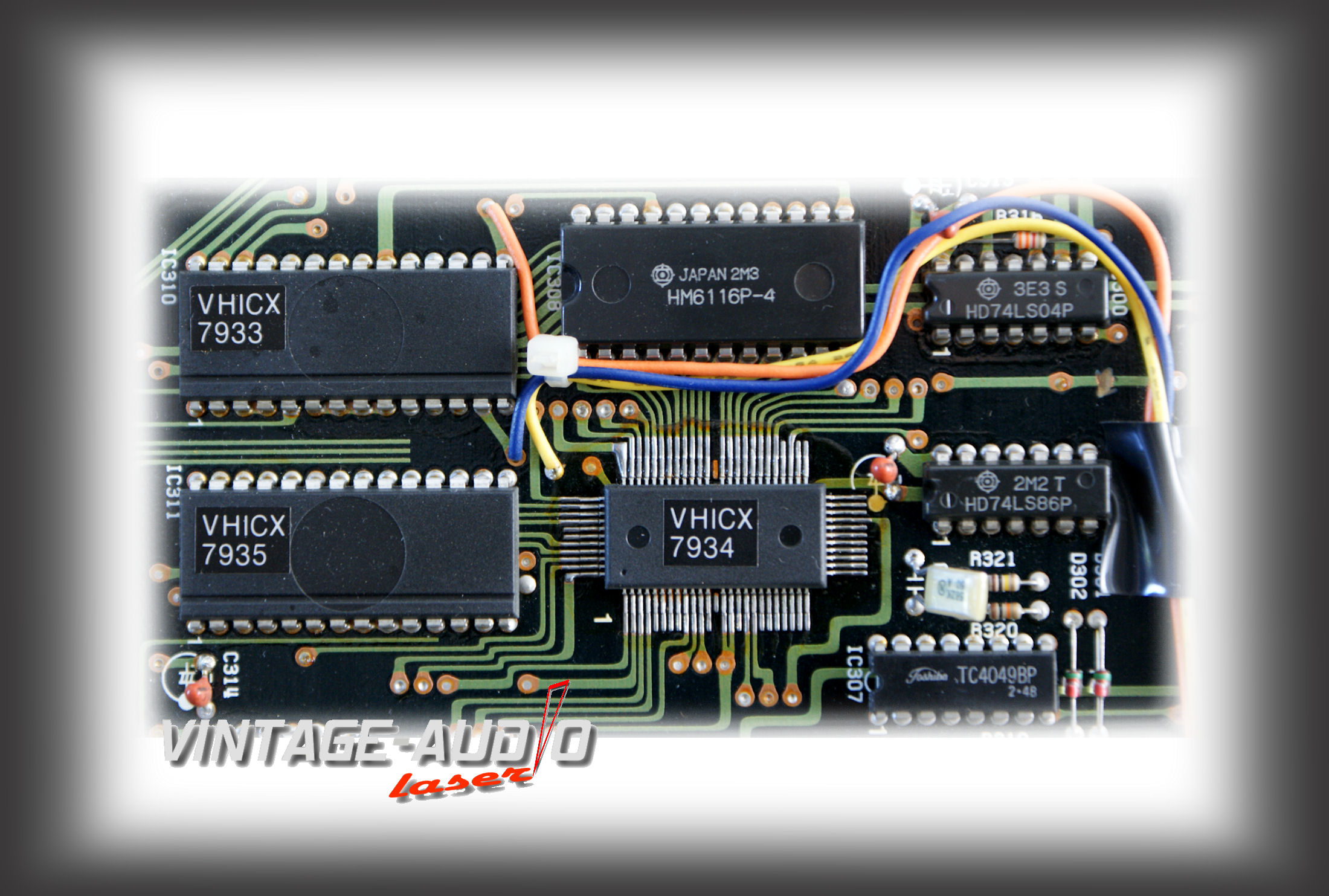

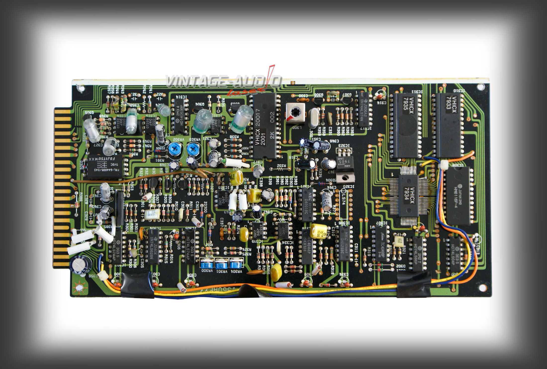

CX7933, CX7934 and CX7935 are inside by follow first generation compact disc player models:
1) Kenwood L-03DP (L03DP, LO3DP, L-O3DP)
2) Philips CD-300 and CD-303 (CD300, CD303), but not by all versions
3) Marantz CD-73 (CD73)
4) Yamaha CD-1 (CD1, CDI, CDl, CD-l)
5) Sony CDP-701ES (CDP701ES, CDP701-ES, CDP-701-ES)
6) Sony CDP-101 (CDP101)
http://cdp101.hp.infoseek.co.jp/cdp101/cdp101-16-l.jpg
http://cdp101.hp.infoseek.co.jp/cdp101/cdp101-10-l.jpg
7) Sharp DX-3 (DX3)
http://vintage-audio-laser.com/sharp/1068_vintage-audio-laser_SHARP_dx3_datapcb.jpg
8) Onkyo DX-300 (DX300)
http://de.nodevice.com/manual/newmans/DX300smpdf/get18710.html
Only by the SONY Service Manual of the CDP-701ES I find high resolution block diagrams of all this LSI devices. But I need the complete data sheets for faultfinding in my CD-73 (sub PCB especially for this three Sony LSI types) regarded the timing of all signals. Cause different modes and clock frequencies I need definitely datasheets - block diagrams are not enough.

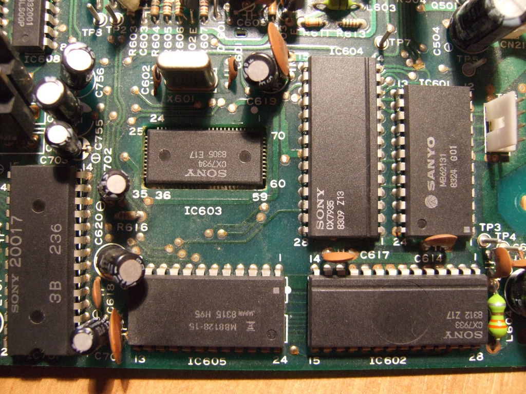

no news?
here some URLs in this case

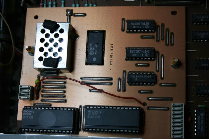

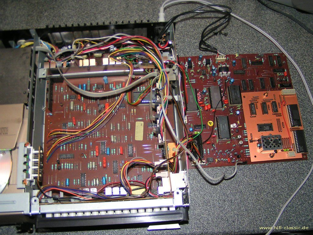

This Sony chip-set was used in a lot of "First Generation" compact disc players
Therefore I think, there must be detailled datasheets (also from the SAA7011, used in combination with this mentioned Sony chipset by Philips/Marantz before was used their own chipset SAA7000/SAA7010/SAA7030)
