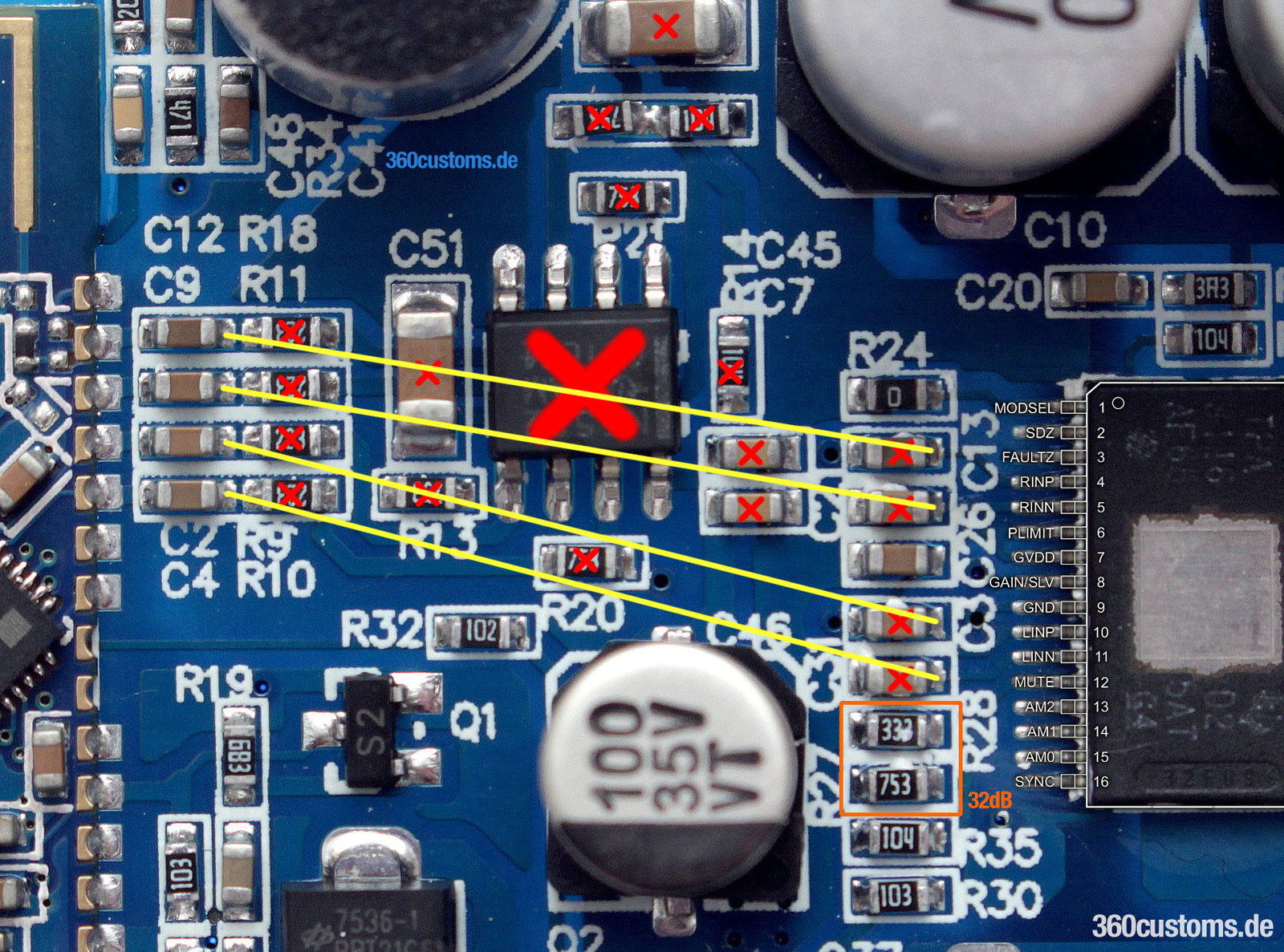

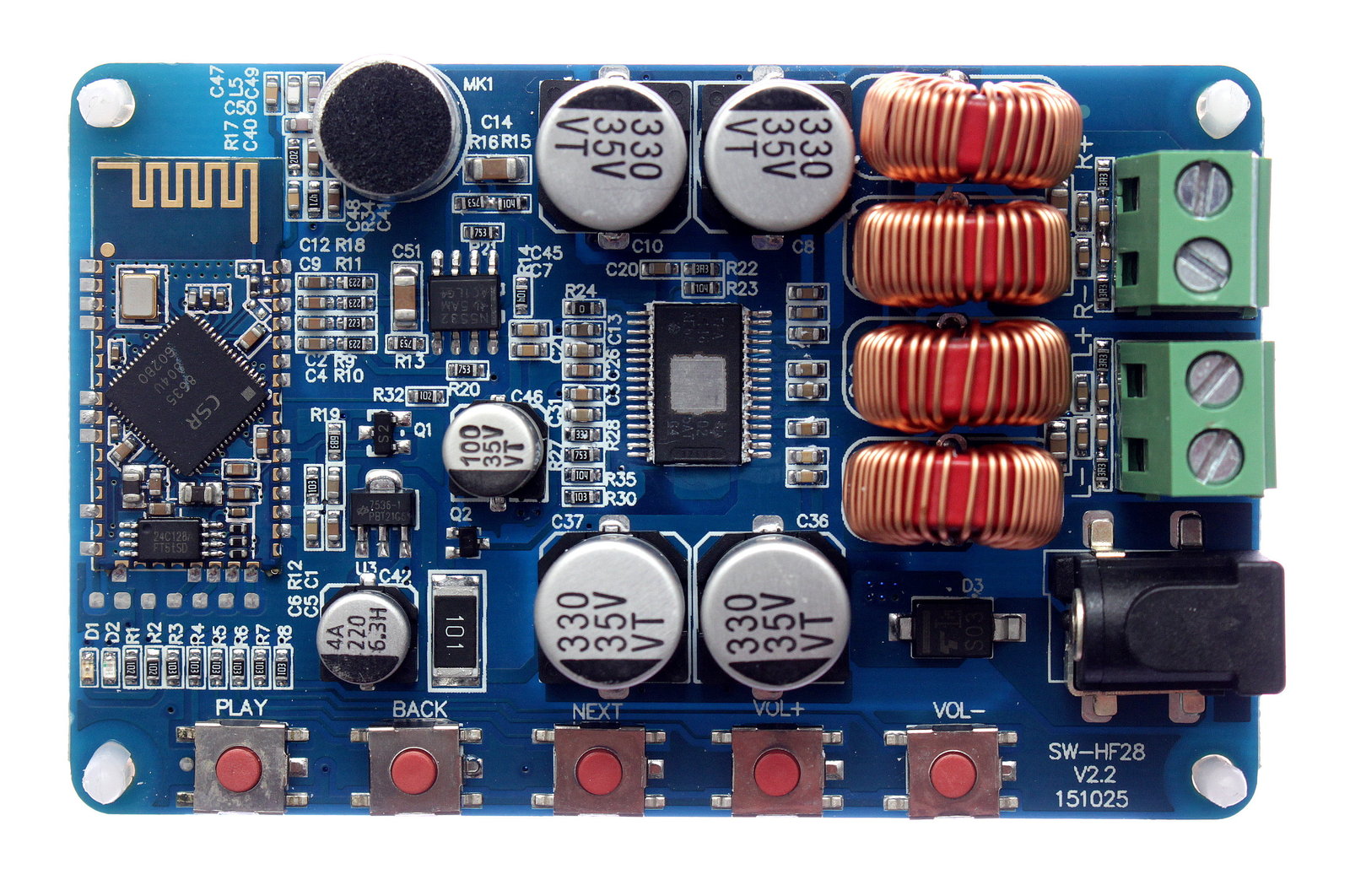

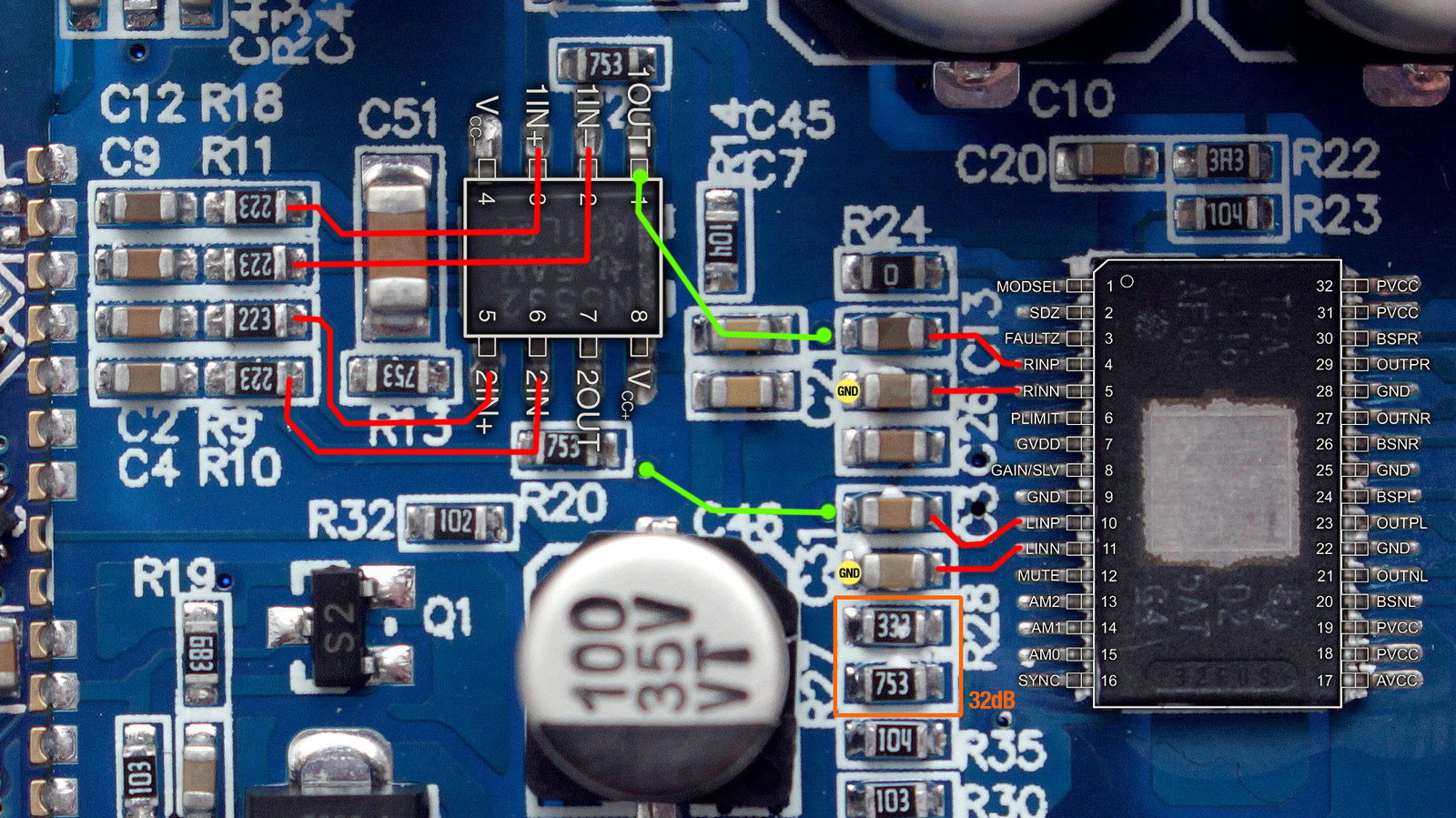

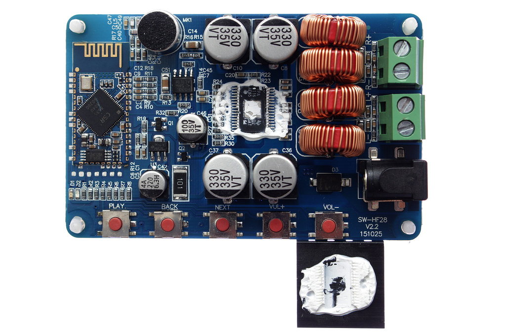

I just bought one of these boards to measure how they'll do and got a v2.2.
Sticking down a heatsink like this is rather useless. Anyway, cleaning the snot off:
Listening to this amp reveals a slight "hiss" of HF/RF interference when having a stream connected and muted or having quiet passages in the music/sound.
From the other thread:
Point 2 is fixed now.
As the noise is independent from the CSR's digital volume level, the hiss is suspected to come from the link between the CSR8635 module and the TPA3116 itself and/or most likely from the power supply design.
Sanwu decided to do a Differential 2 Single-Ended Conversion to feed the TPA3116, why ever, as shown here 😕
Having a direct differential link is all it needs to be dead quiet, so more hiss/noise.
The populated coupling caps are 4.7uF in 0603, most likely X5R 6.3V, so with 32dB gain and 15k input impedance, the f3 frequency will be at 2.3Hz. Changing them for 1uF X7R would give 10.6Hz, still low enough for normal listening.
Another benefit is the now lowered quiescent current.
should be "no more hiss/noise". 😀

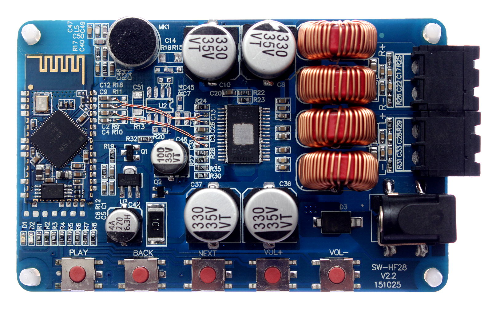

Its just 4 wires from one end of the caps to the pad near the amp pins. I'll post a pic later. Pad connection is like shown on the last picture with the yellow lines, start/end of the line is on the corresponding pad.
Did you pull off the offending parts first?
They did the differential input to reduce common mode noise or maybe prevent BT buzzing sound? I did not hear BT buzzing sound with this amp - and don't recall a hiss problem either. It's been a while since I listened though.
I pulled down the series resistors and the caps in front of the 3116 ic. While this is enough to decouple the 5532 from the signal path, all parts shown with an "x" aren't needed anymore.
The amp is much much quieter now compared to the Diff2SE solution. (There's some small residuals left coming from the 32dB setting. I can hear that from 10cm in front of the tweeters which are high efficient. Before you could hear from ~2 meters. Ymmv as the speakers used to test are ~96dB/W/m,the mig/high is like ~100dB/W/m. (Bass + Mid are AlNiCo magnets)
If you want to keep your "Common-Mode-Noise-Filter" you can alternatively change those 4x 75k resistors (753) to 22k to bring the gain of the stage down from 10.5dB to 0dB. Maybe this would be already enough reduction to satisfy the demands. (I'd prefer the differential only connection.)

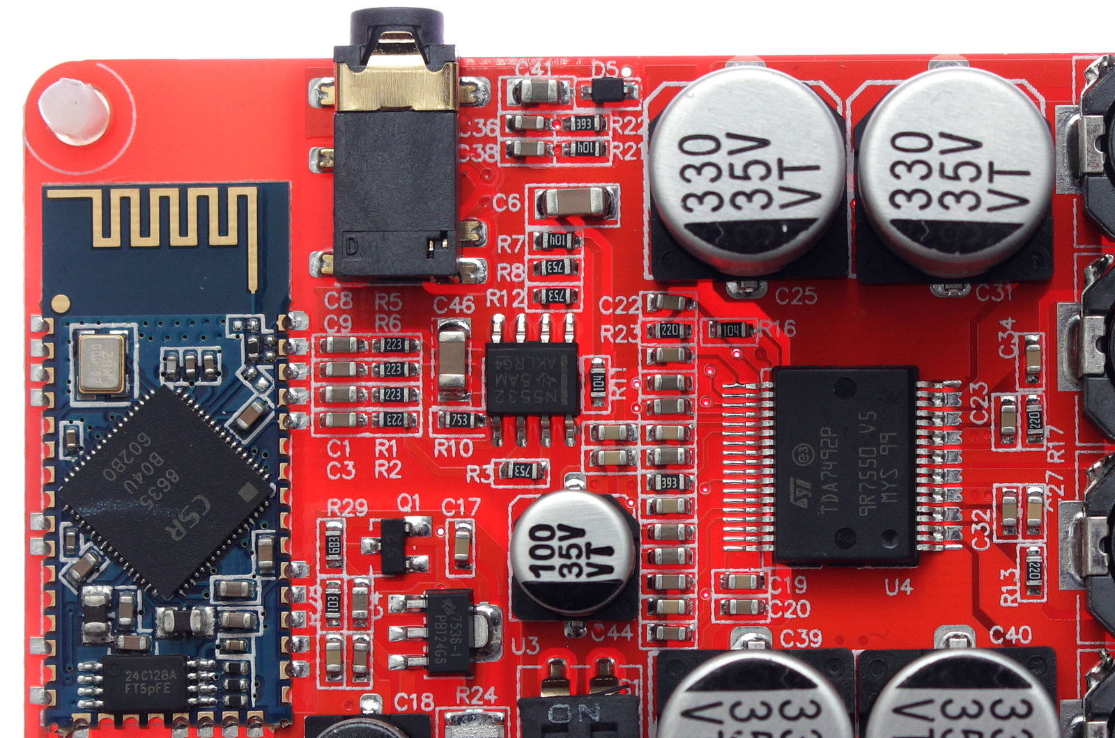

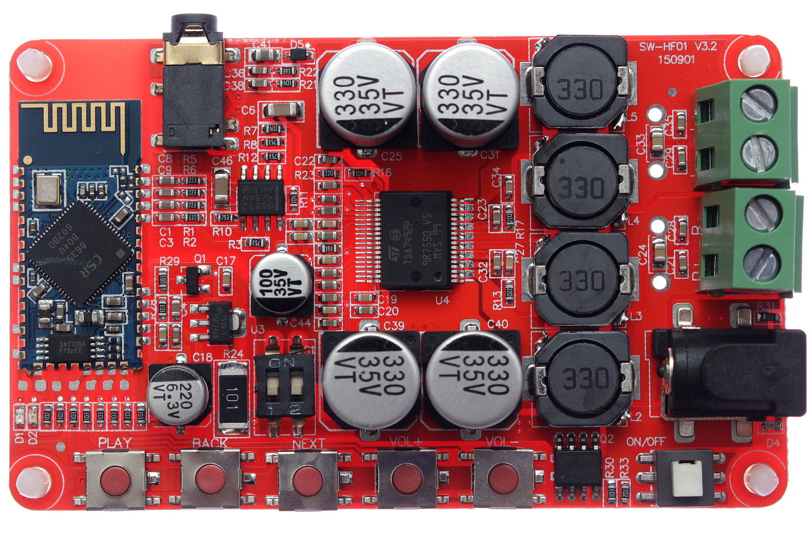

In direct comparison, the "SANWU TDA7492P + CSR8635" is much noisier.
The interstage section is nearly the same, beside the switched line-input:
Due to the layout, the RF is coupling into the audio path via the 3.5mm connector. This get really worse when having a cable connected and there's a device coupled via Bluetooth. Beside the RF-noise the TDA7492P is noisier on high gain settings than the TPA3116. It would have been better to make use of the internal ADC of the CSR8635.
Also this board doesn't switch of the TDA7492P when idling and features Power-On/Off Plop.

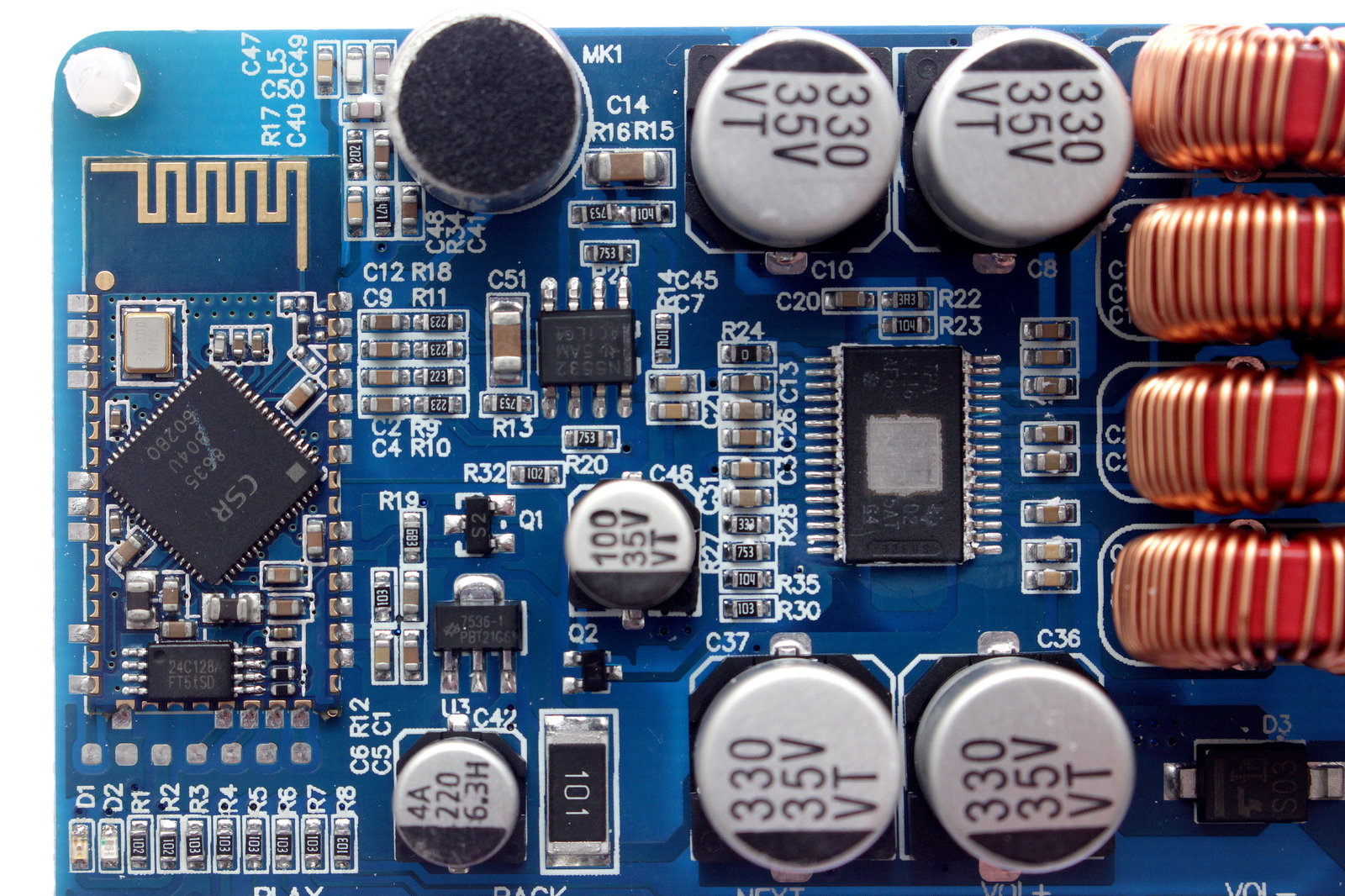

I wonder if you have any suggestions on another noisy bluetooth board. My son bought a YJ TPA3116D2 2.1ch bluetooth 4.0 amplifier board. It came from an ebay seller, but is identical to this one:
Y92 Free Shipping 1pc TPA3116 Class D Amplifier Board Bluetooth 2.1 Amplifier Board 100W+2*50W-in Amplifier from Consumer Electronics on Aliexpress.com | Alibaba Group
The sound quality is great, but the annoying bluetooth noise and hiss at low volume is very noticeable.
The board differs from the Sanwu designs in that the signal goes from the CSR bluetooth module to a SGM358 dual op amp instead of a 5532. My eyesight isn't the greatest, but there appears to be nothing but a 10K resistor between the output of the CSR module and the input of the op amp where the Sanwu boards have a 22K resistor and some value of chip cap in series.
Does anyone have any ideas how to quiet this board down? Aside from the bluetooth noise problem this 2.1 board is a great value and performs well so I'd love to find a solution.

Is the noise comming from all channels? Without the board on desk it's difficult to give a suggestion/hint. The Diff2SE stage is needed in this design, as the tonecontrol is single-ended. I suspect the noise is comming from the 7805 as this haven't got an RC-filter in front. (With like 50-100R and some 500uF Low-ESR cap)
Thanks for the quick response!
Interesting that you mentioned the 7805. I just noticed that there is a 220uF electrolytic right next to the 7805, but the silkscreen on the PCB calls for a 470uF. Would it be worth trying a 470uF (or even higher) value? There is also a 10K and 10uF electrolytic on the SGM358 but no electrolytics on the two TL072 chips that are handling the LF crossover and treble control.
One other thing I noticed after looking at FFcossag's YouTube noise fix of a non BT version of this board. It appears that the R1/R2 resistors for the TPA3116D2 that is running stereo are 75K and 47K (slave), and the resistors for the TPA3116D2 that is bridged for the sub are 39K and 100K (master).
Would there be an issue with the input impedance being set different between the two (30K for stereo channels and 15K for the sub)?
BTW, I can post a high res photo of the board if that would help.

That's a bit of a different story, as the BT-modules output is feed into the switched 3.5mm jack via the Diff2SE stage. To have the board modded like the TPA3116/8, you'll loose the wired line-in.
If you noticed power-on-plop:
Change those two resistors to:
R22=680k
R21= 820k
If you don't care for the line-in, then the board can be modded like the TPA3116/8 with differential linked BT-module. Muting while idling have to be added seperately with some more parts.
