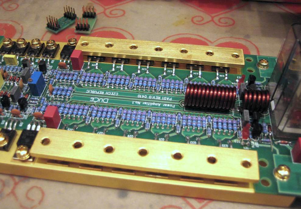

Resistors
Parallel connection of small resistors ( 0207 ) have several advantages against bigger ones : they are problemloss to buy, summary price ( per wattage ) is lowest, have standardly 1 % tolerance, thanks parallel connection is reliability very good and, what is for me very important, PCB looks nice 😉 .
i would give the layout a "fair" rating, i seldom find that all my 2 legged critters just happen to want to be scrunched up together shoulder-to shoulder in parallel rows for best electrical performance but the lack of squirrelly tracks snaking between and around parts does show the care put into parts placement - the layout may get better than fair marks for ease of assembly
and as always power/signal ground and supply rail routing can really only be evaluated and perfected within the context of the whole chassis and power/signal i/o connections
Thanks jcx
for your nice words 😎 . Outside of this PCB are only toroid, input connector, protection circuit and output binding posts. True this extremly short rail ways have amp very good SNR ( more than 122 dB, refered to full output, IHF - A, or 117 dB linear).

Re: Resistors
Nice job, Pavel :att'n: Do you always use the third person when you talk about yourself? 😉
You have maybe forgotten one thing about using small resistors, which may or may not be important: Transient handling capability.

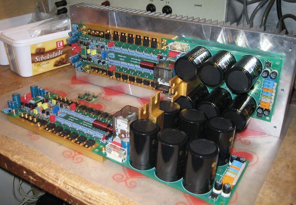

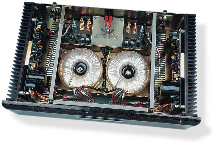

Warning signs
This is little PCB above main PCB. Below are mains inlet ( Schurter ), mains fuses and WAGO's for connecting of trafos. Little PCB also fixed mains wires from power switch against releasing. This amp I had try made as comercial product and in our country is well known. In Poland was by one magazine declared as " Power amp of the year '98 ( ? ) ".
It's prototype of my new amp with EC, cca 350-400 W into four Ohm ( still in developement )...Prisms in middle are output terminals ( there will be screwed round bars, which lead directly to binding posts ). And at pic is fitting of output mosfets...
