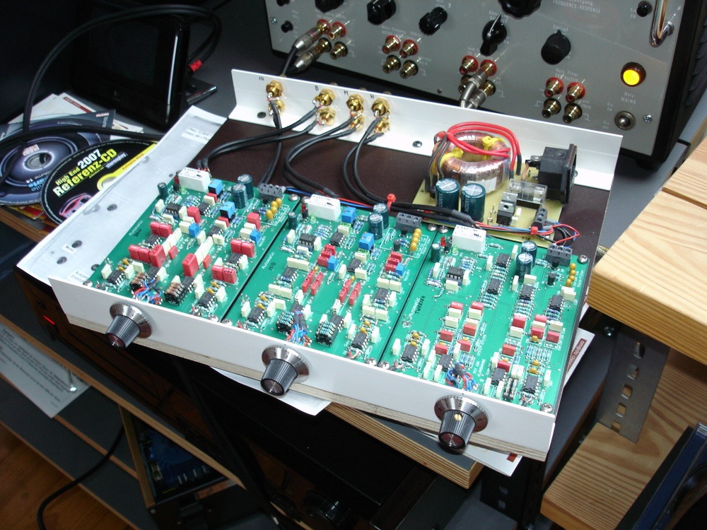

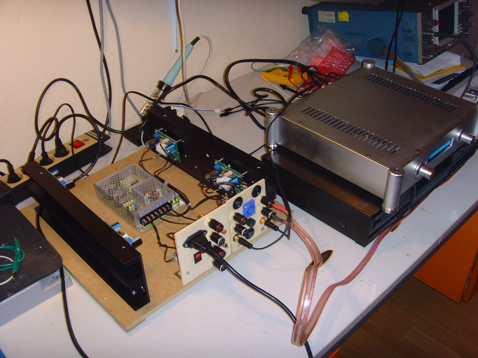

Gentlemen, this winter my DIY-friend Hannes and I are aiming for an active speaker project that is partly (66%) based on Mr. Nelson Pass' ACA#1 amplifiers.
Have a look at images 1 and 2.

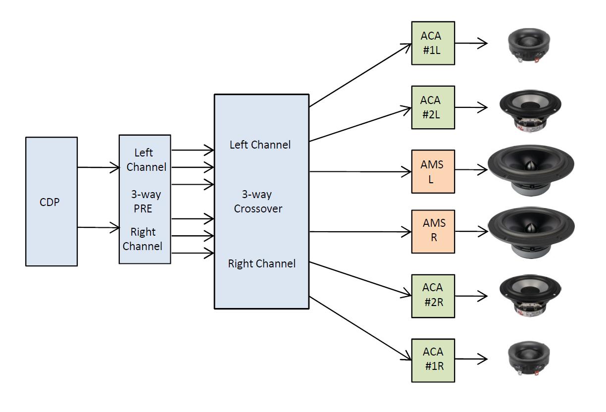

The music source is a CDP. Its attenuation is done by a 3-way PRE, which is followed by a 3-way crossover.

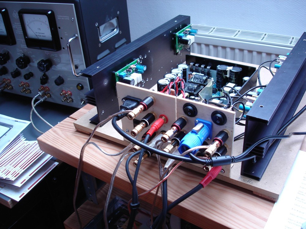

I have assembled 4 ACA#1s, two of them driving the right and left tweeters and the other two driving the right and left mid-range speakers.

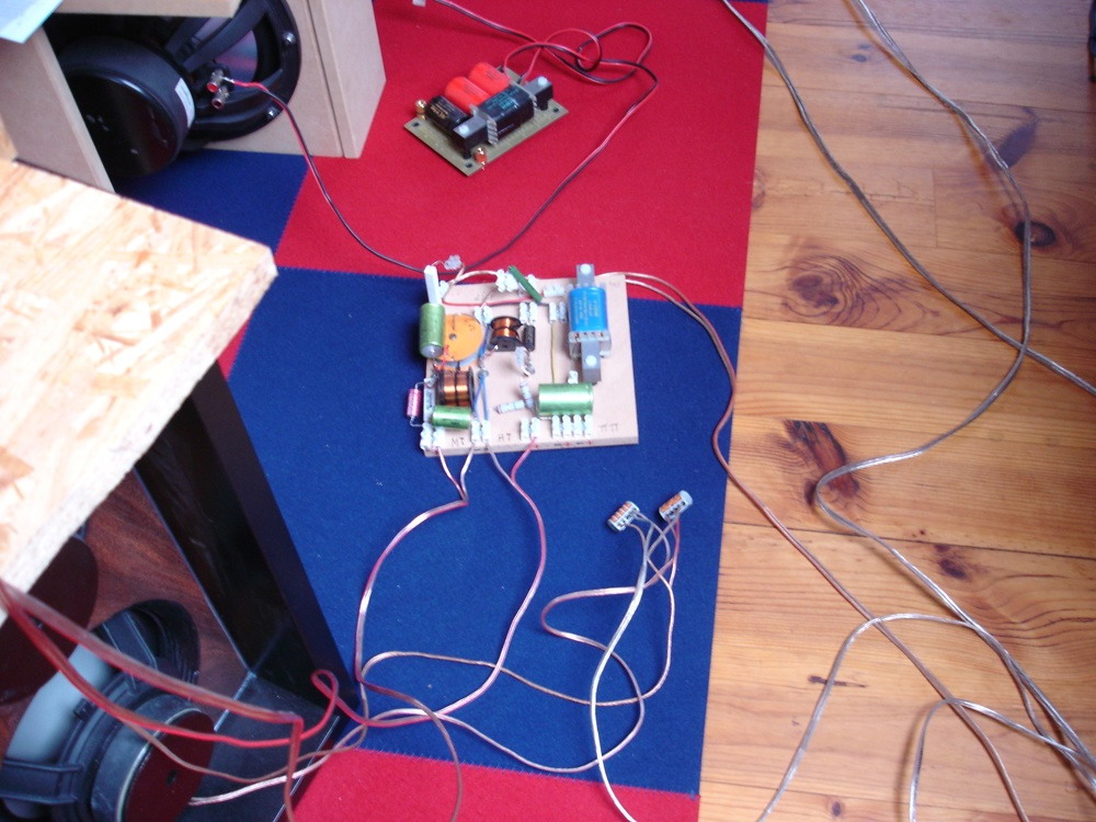

Hannes and I (after browsing the INTERNET, this forum, ...) decided to use an ANAVIEW AMS1000-2600 ClassD amplifier to drive the bass (see image 3).
I myself was very excited to get to know, if the ClassD would in any way "spoil" the performance of Mr. Pass' ACA#1s, if both of these amplifiers are built in close vicinity.
The result: the ClassD ANAVIEW AMS1000 does not spoil at all the "sound" of the ACA#1s. No hum at all.
But, and this is Hannes' and my 1st conclusion: the AMS1000-2600 is not able to "reproduce" music.
It can play loud, it will shake your ears and hairs, moving a lot of air around you:
But showing power over the bass membrans, being precise and being rhythmical and showing soul: no way!

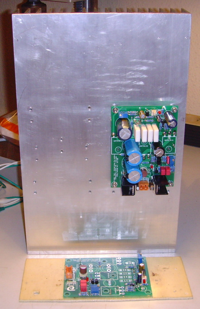

When I compare the "sound" of the ACA#1s with the "sound" of my "BlackBeauty-SYMASYM" (image 4):
I feel that the sound of the ACA#1s is a little bit "dark", "too warm", just as some of the heights are being cut off.
For example: while listening to a Piano solo.
Is this really, normally so?
Or is this the fact or is it due to my poor (DELL-laptop) PSU?
Can you please tell me?
Is there any way to get crisp and clear trebles out of the ACA#1 (with the R15-mod being active)?
I wonder how.

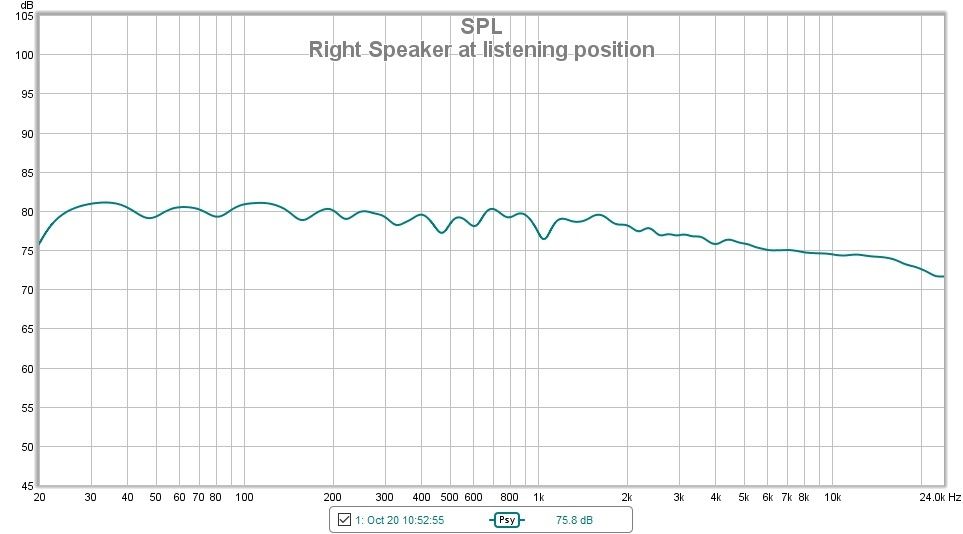

Rudi, my 3-way active system uses the ACA's with the R15 mod to drive midrange and treble compression drivers on waveguides: http://www.diyaudio.com/forums/pass-labs/215392-amp-camp-amp-aca-150.html#post3725314 Since those pics I changed the treble compression driver to a BMS 4540ND that goes up to 30 kHz. Mated to a QSC waveguide that is similar in size to the midrange waveguide in the above pic.
The sound from the ACA amps from 500 Hz on up to my ears is very crisp, but never harsh using subjective terms. I have digitally eq'd my system and the response goes out past my measurement mic limit of 24 kHz: http://i1217.photobucket.com/albums...Speaker at listening position_zpskt56bc5f.jpg
Don't know if you have access to a measurement mic and REW, but if you could take measurement of the frequency response of your speakers, one with the ACA and one with your Black Beauty, you can overlay the measures in REW and check for variations. It would be one place to start or if you can measure the frequency response of the amps...

Andersonix, please do not blame the tweeter. The left picture in post #1 is showing any tweeter, just to show you the intention of this project.
In effect we are using a reputable 3-way speaker and have removed its internal crossover.

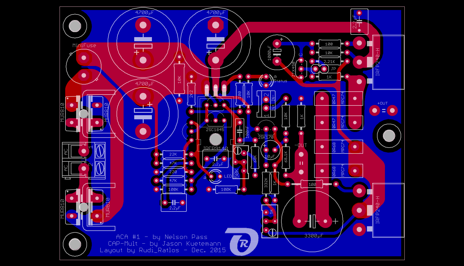

The shown PCB-layout will have a size of 100x75mm.

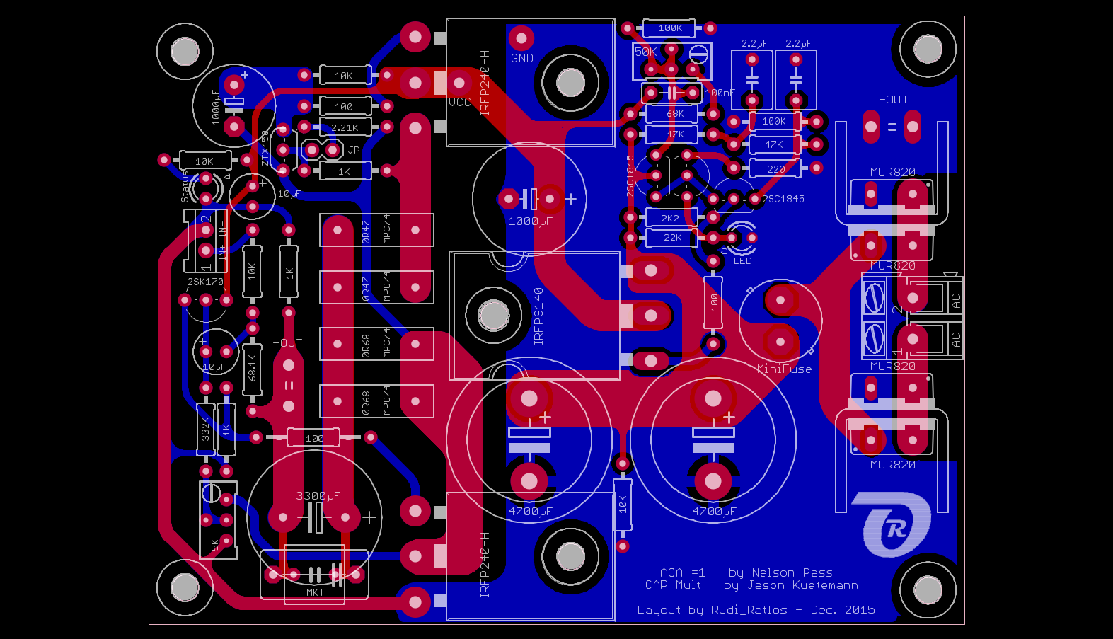

I did a new PCB-layout and have given my ACA#1 the Jason Kuetemann CAP-Multiplier - PSU.
I have not yet finished my ACA#1s yet, but will keep you informed.

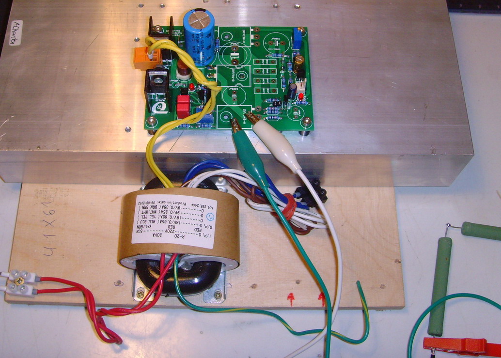

I have finished the 1st of Johannes' ACA-PCBs yesterday and have evaluated the CAP-multiplier, designed by Jason Kuetemann, which will drive the ACA.
I have ordered a 4x18VAC / 100VA each torroid from BADEL several weeks ago, but did not yet receive it and therefore connected the new ACA to a 18VAC R-Core that I had at hand.
I connected a set of resistors to it resulting in a load of about 500mA.
My DMM is showing a ripple of about 55mV with the output voltage being adjusted to 24VDC.
I will go on with the 2nd ACA-PCB tonight and have to wait, until the ordered torroid will arrive.
Best regards - Rudi_Ratlos
P.S.:
Looking at the 2nd picture above: I have had a mishap, my tapper broke during my 1st attempt and I had to restart tapping the holes.
The used heatsink is 300mm high and 190mm broad.
