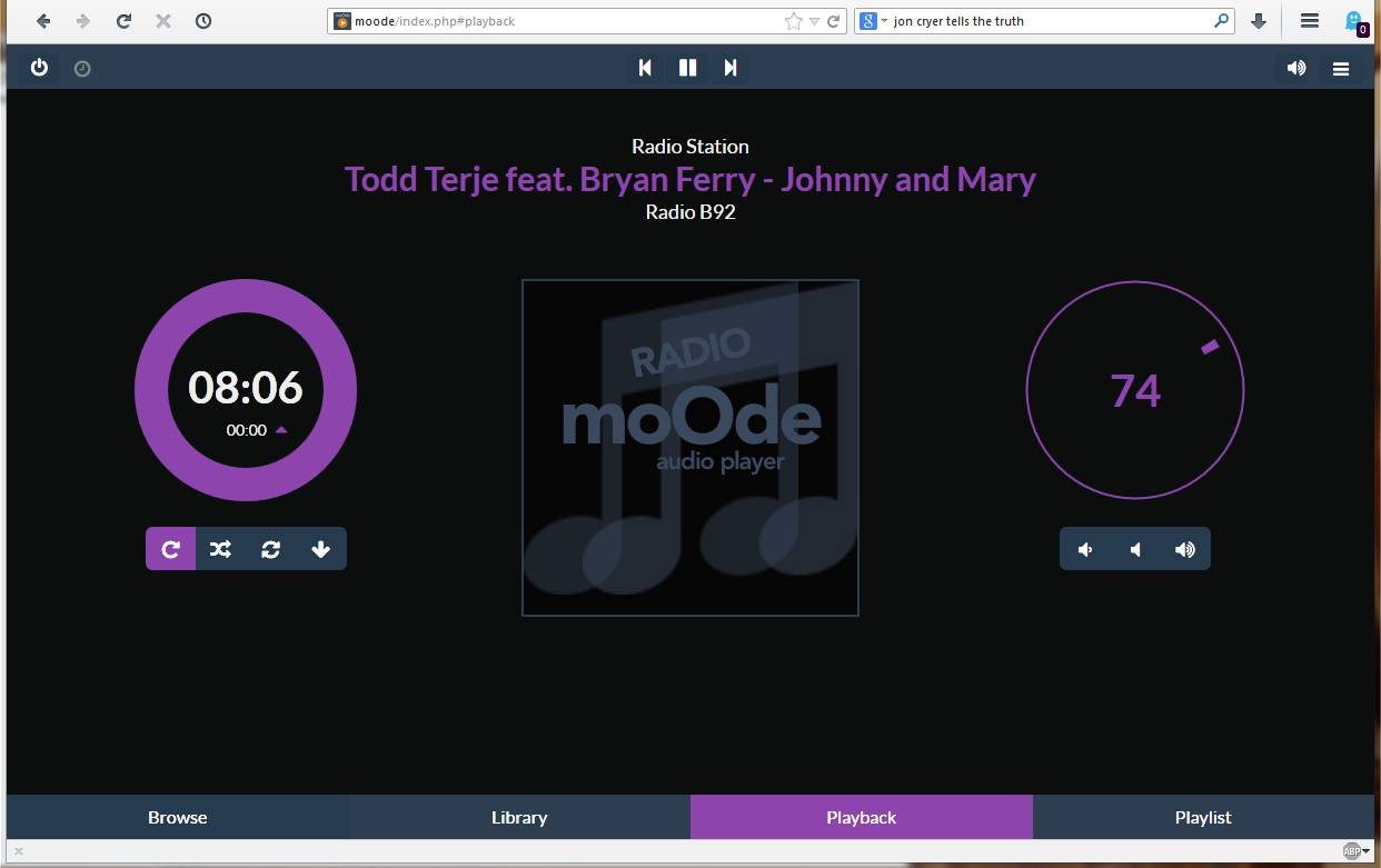

🙂 Tested and very satisfied with RaspyPlay4 on Raspberry Pi2. Also replaced my RuneAudio installation!
P.S. "Drag to move items" function on Playlist will be very fine...
