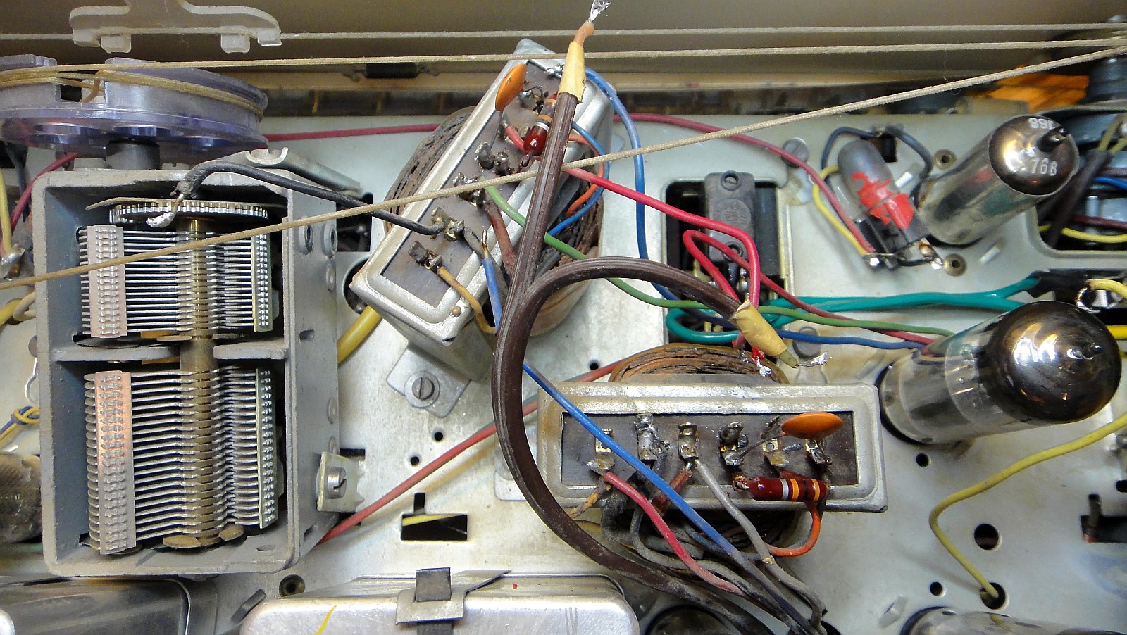

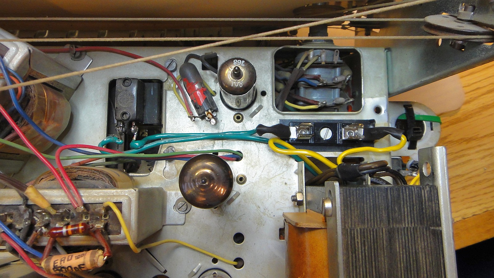

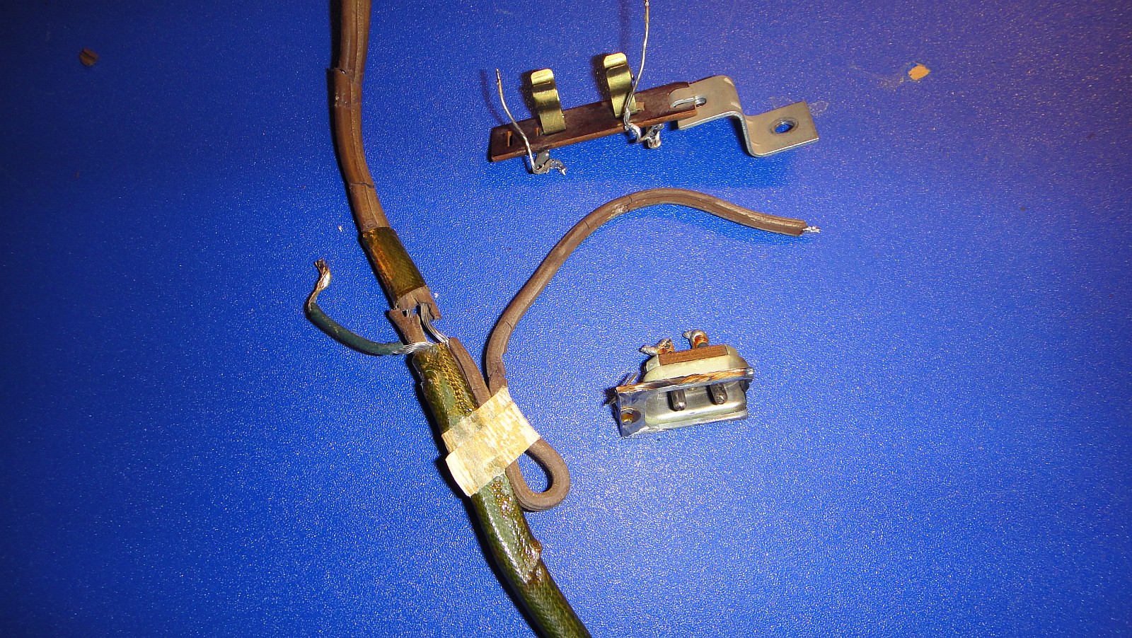

What I have done – I’ve started rebuilding completely the power supply rail - seems that the power transformer either have been replaced or some gimmicky repair job(s) have been done, extremely dangerous! The transformer have been mounted pressing the 110V cable and the heat “ate” the insulation to almost running bare 110V to transformer’s enclosure (see photo 5).

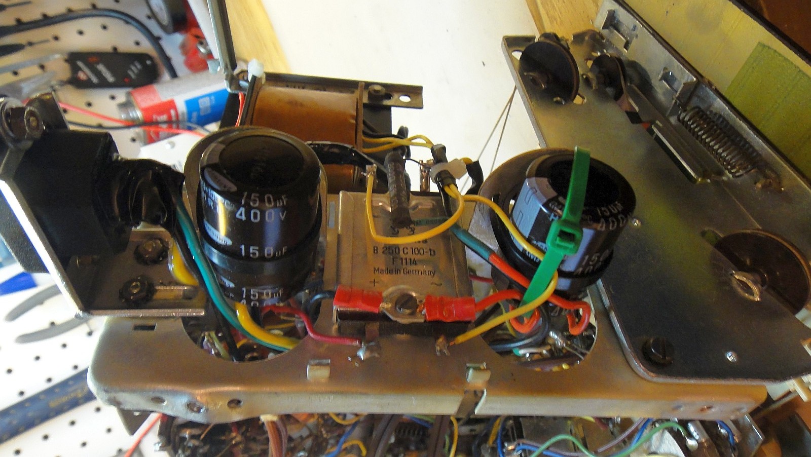

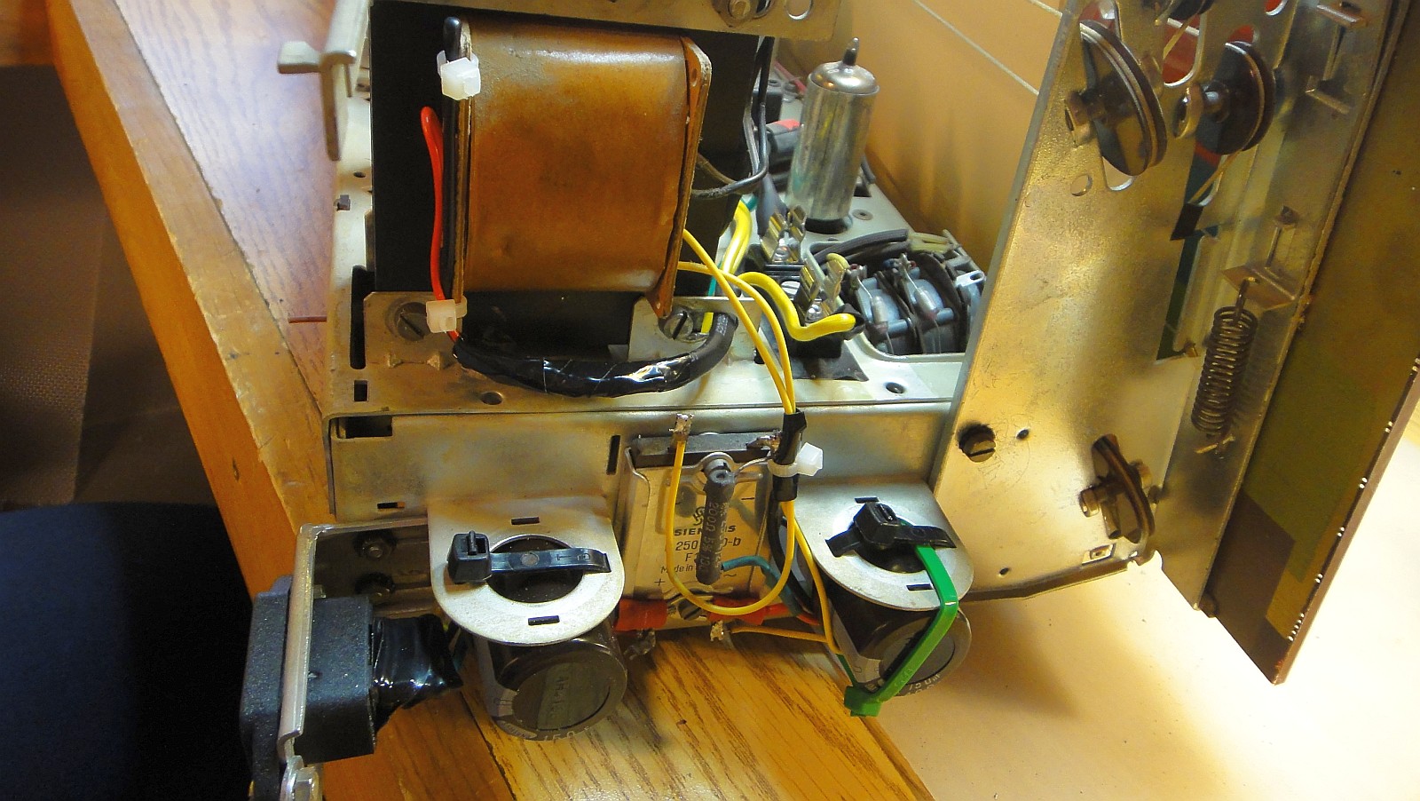

I’ve rebuild all the wiring, installed new fuse holder (see how was done before on photo 5), replaced both the can caps (50uF/350V) with Samsung 150uF/400V and made new enclosure for standard 3-pin female power connector, grounding the chassis to power ground (see photos 1, 2 and 3).

I’ve even swapped the output transformers (see photo 5) – the result is the same, but the power voltage rose up to 230V, of course – quieter channel still has lower voltage on the anode, but is 3-5V higher before the swap. Go figure now...
