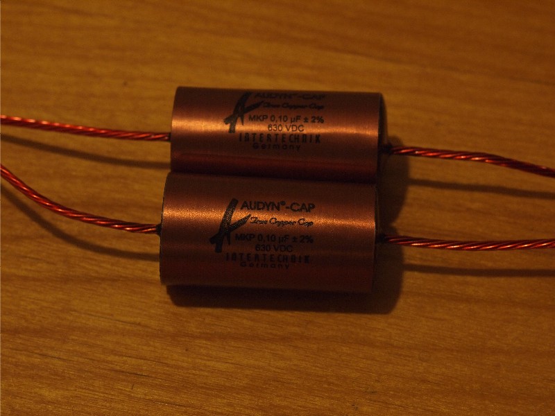

Confused. Is there any difference between Audyn true copper blue or bronze coloured caps ?
Build date at least. Tom E., Bob, and Dario all bought the blue ones in 2012 or earlier. I auditioned Bob's blue one and it sounded nice. I believe the blue ones have a paper or foil wrapper.
For a different project, I purchased a pair of the bronze ones late last year. It appears that the wrapper for these is rather thick aluminum foil that has a brushed and anodized finish. This appears to be a style change for Audyn, but I don't know if it affects sound. Actually, I prefer the look of the blue because the bronze has an uneven and thick junction of the foil that looks cheap.
Unfortunately, I don't have the other project complete, so I can't comment on the sound. Also, they are a different value than usable for C13, so I couldn't try them in direct comparison to other caps.
Has anyone else tried the bronze TCs in C13? Especially with some other comparison of caps?
