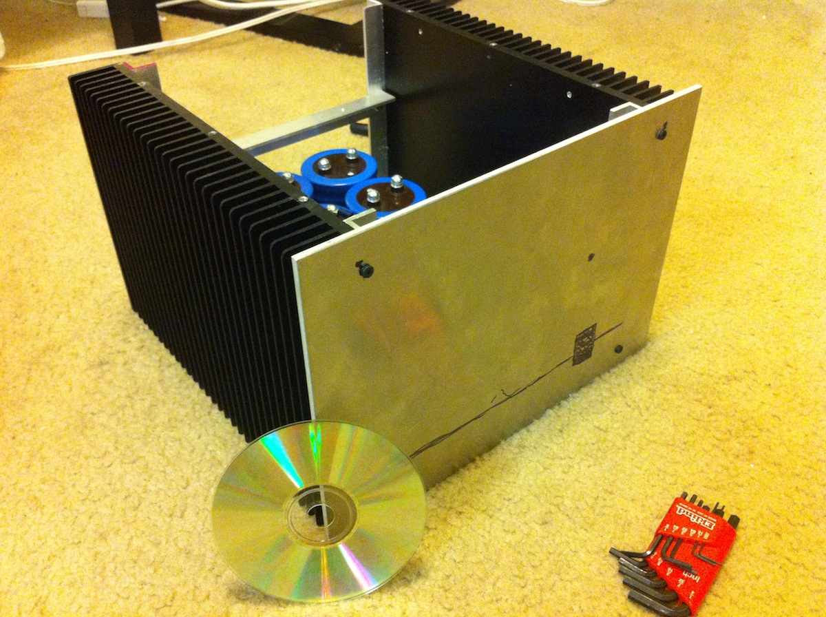

1) Chassis:
I do not have instruments except a wireless drill and small hand stuff, so constructing enclosures were the longest and least pleasant experience for me.
Especially enjoyed tapping: broke 5 tap because of excitement . Do not buy cheap taps they made of sh..t, not steel . For vent slots I found a guy with a milling machine who helped me.
After all here what i got (pictures 1, 2):

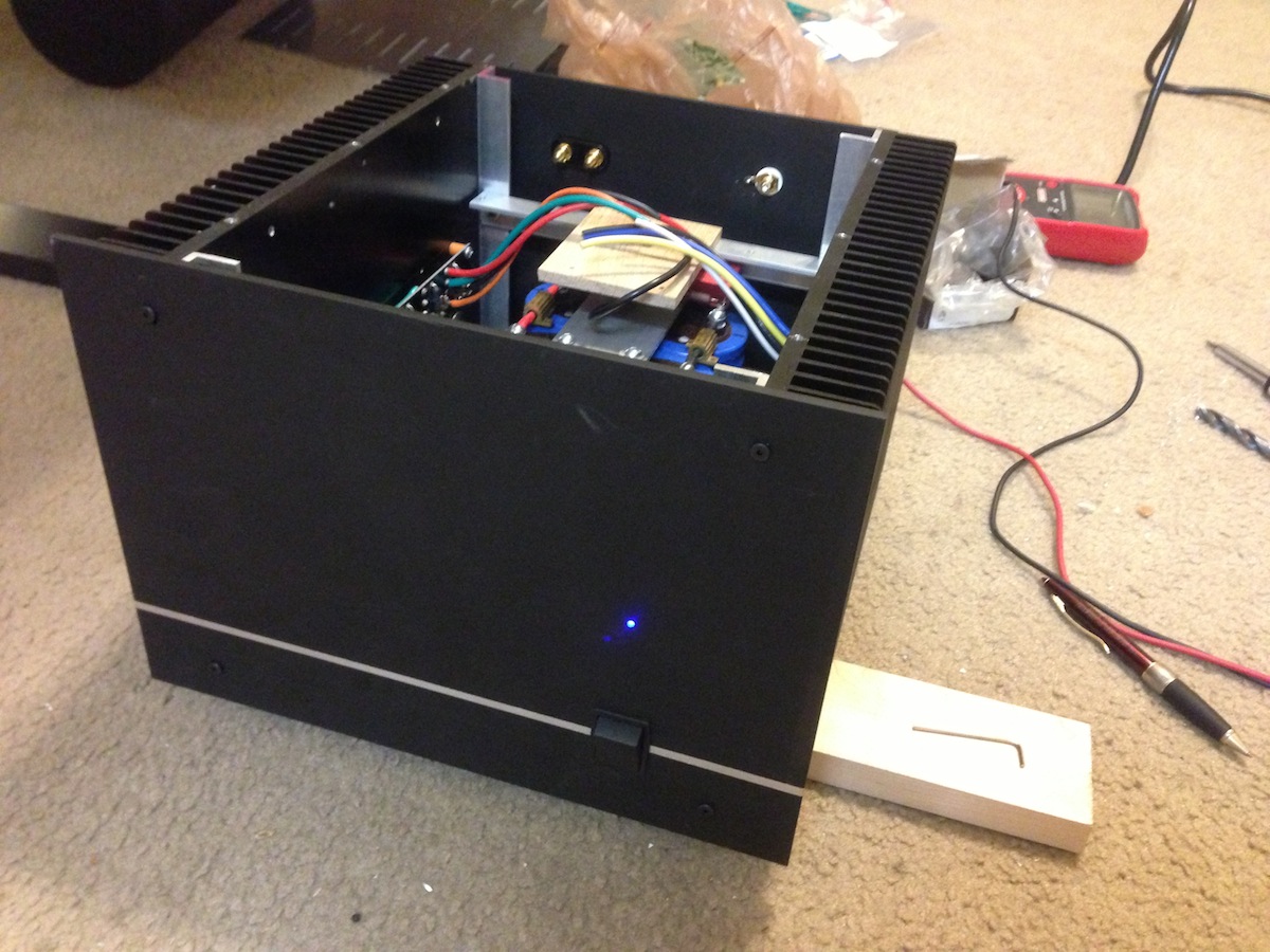

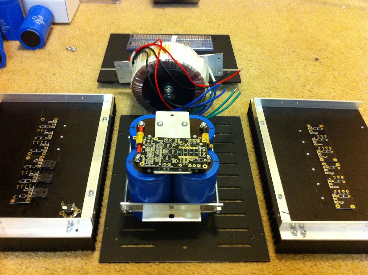

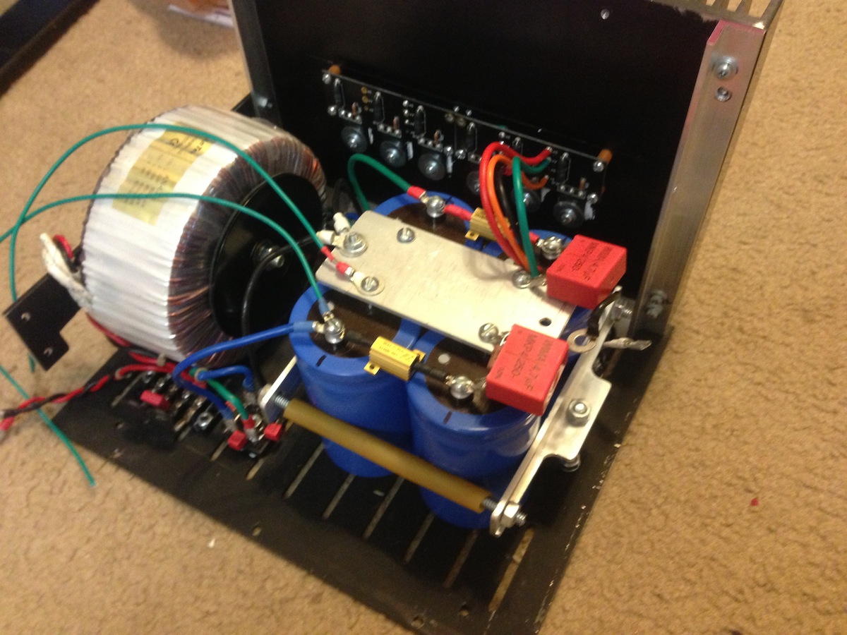

2) PSU mounting and wiring:
I used description from 6L6 thread, there is everything in there.
The only difference I had another type of caps — screw terminals. So,
— use an aluminum plate to connect capacitors like this: +(-+)- and 0.15Ohm 25W resistors for CRC filtering.
— after second pair of big cans I installed 4.7uF Wima MKP4 PP caps and 3k3 3W bleeders.
— drill two holes on this aluminum plate for the input voltage and one right in the middle on the opposite side for a ground star (pictures 3, 4(green wires to go a blue LED)):

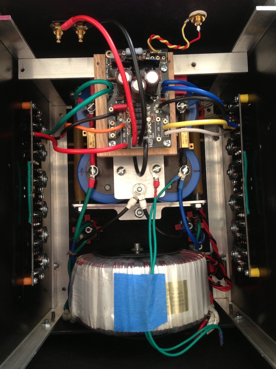

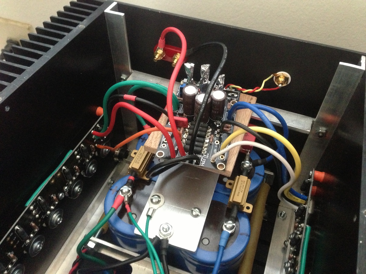

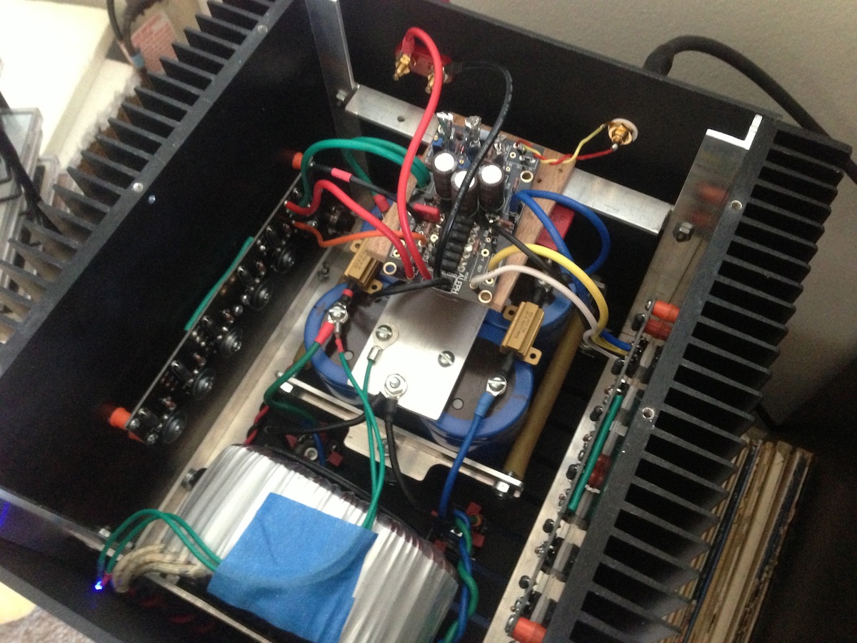

3)Transistors mounting and wiring:
I used 6-32 taps to mount both boards and transistors on the sinks (see above how I enjoyed it .

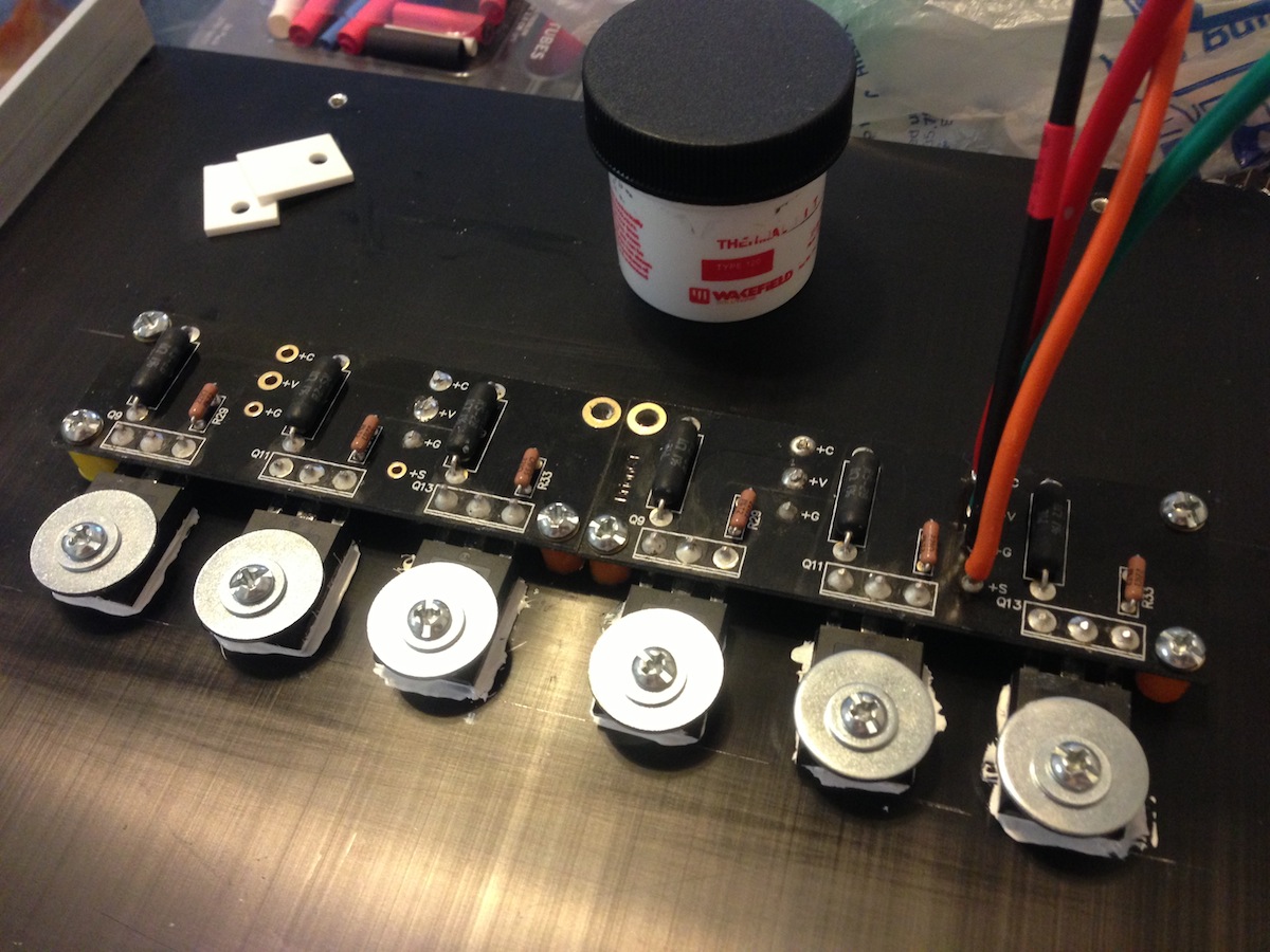

For an Aleph 60 you need 6 pairs of output transistors, however, chipamp(BrianGT) pcb's gave only 3+3 daughter boards. So, you can either
— buy another set and connect two daughter boards together with wires (what I did)
— buy two extra output boards for SE BA amp from the store: P-BASO-2V20 - Extra pair of Single-Ended Output boards (Requires gain stage and bias boards; Makes 2 channels; Rev 2.0) - Burning Amplifier Series - Power Amplifiers - PCBs (what I would do now)
As thermo-conductive insulators for transistors I used aluminum oxide pads and non-conductive grease(paste) from Mouser (picture 5). They have many, choose your own!

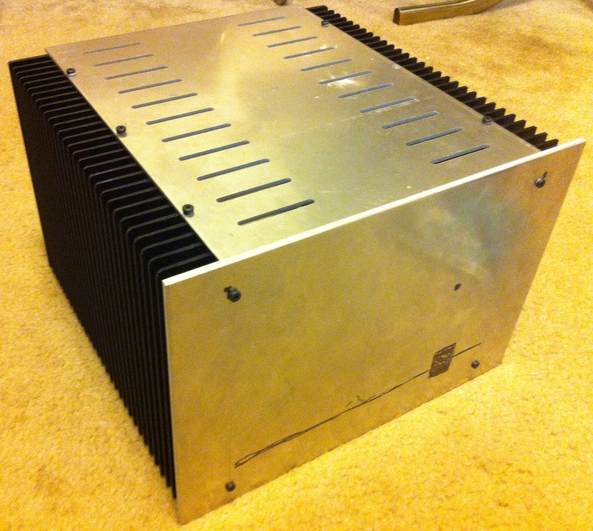

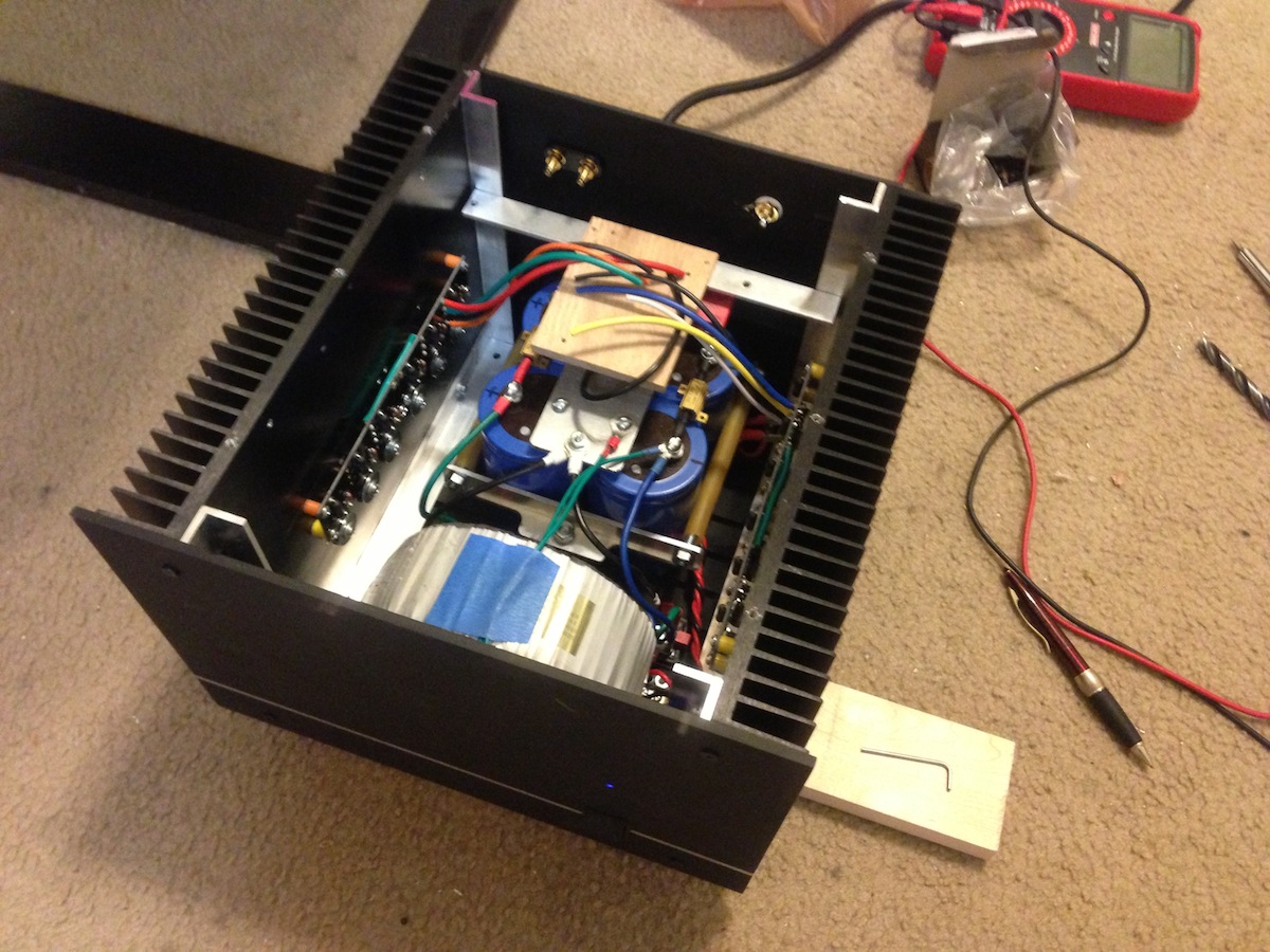

So, here are some pics of my almost assembled amp with fired up PSU (see blue light! , picture 6, 7. Looks almost like a real amp, doesn't it?
