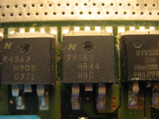

BUK9620 replaces R4363.
It is a small Mosfet switching transistor.
You will find a datasheet here: BUK9620-55 pdf, BUK9620-55 description, BUK9620-55 datasheets, BUK9620-55 view ::: ALLDATASHEET :::
R4389 is also a Mosfet switching transistor.
Is this a picture of some Car-equipment of any sort?
Have a feeling I have seen those in ignition systems for cars in the nineties.
It is a 60V 50A N-channel switchMosfet.I am not sure what replaces it.
