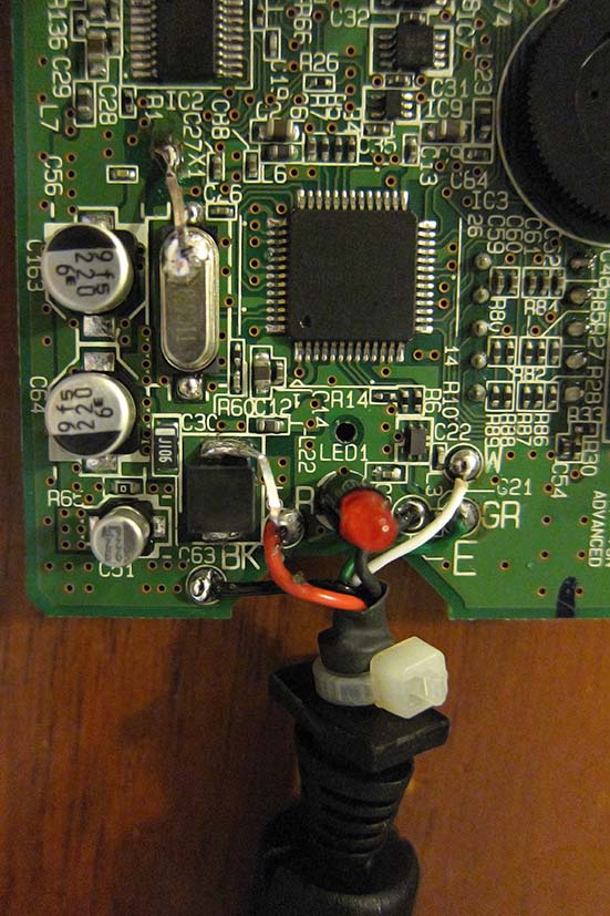

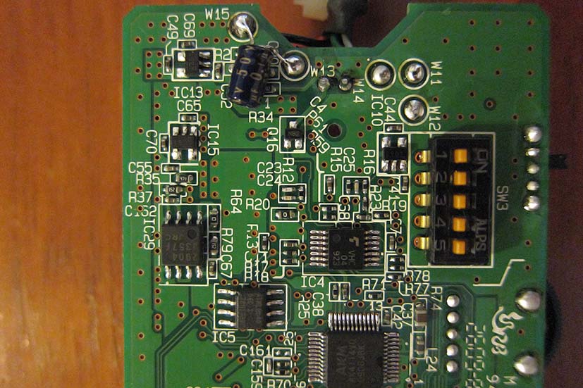

3 things I did to boost the quality:
1. I used an extra filtering cap at the “input” where the USB power is fed to the UA-1G PCB. The capacitor in question is probably the best (still) available – Black Gate 0.1uF /50V N type. I soldered it on the PCB “under-side” right across black and red wires.
2. The in-series inductor used at the “input” (as filter) is bypassed with a peace of ribbon (wire). The idea is great (to filter high frequency noise coming from the PC USB port)… but it just never works with large inductance in series with power supply rails… The above mentioned Black Gate is great at doing this job. I measured DC drop of 200mV across this choke (inductor) with UA-1G fully “loaded” – so there’s plenty of small diameter wire windings that should definitely be bypassed.
3. The crystal oscillator (6MHz) case was grounded. I used a bit of ribbon (wire) and soldered the case to ground.
The result?
Sound firmed-up and gained in definition – just what I wanted. The original tape and the exported file sounded almost identical. There was just a very tiny hint of softness still present in exported file, but I blame cheap and long-ish USB litz cable for this. The end-result was excellent.

do you have any pictures from your modifications?

I'll take the photo or 2 this weekend and post.
Boky
