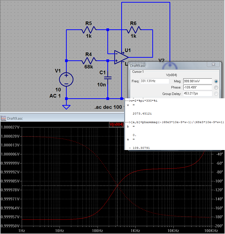

I’m trying to work out the phase shift for 330Hz through an all pass filter which has a value of 68K for R1 & 10nf for C1.....
shack.us/i/diagram1.gif/]
Now formulas aren’t a strongpoint of mine, but apparently, this one will provide the phase shift for any given frequency through the above circuit ….
(source = http://www.maxim-ic.com/appnotes.cfm/an_pk/559
Where where w is the frequencies in rad/s.
I want to determine the phase shift for 330Hz, so I used this online calculator to get that converted to radians per sec
http://www.sciencelab.com/data/conversion_calculators/frequency-conversion.shtml
therefore w (radians per second) for 330Hz is 2,073.451149
R1 = 68,000
C1 = 0.00000001
Ok, don't laugh, but I tried to use that formula above....

Excellent working there, just a small mistake at the very last hurdle. Tan -1 means inverse tan, you should have the function on your scientific calculator, usually shift or 2nd then press Tan.
So you need to find the inverse tan of 2.8543 which is approx 70.7 degrees.
some of us are just lazy - let (Free!) software do the math
the inset is SciLab console calc for those who need better than the LtSpice cursor resolution

109.307... degrees is the "correct" answer
the sim's -109 comes from the software's phase unwrapping algorithm
a simple calculator style atan function is going to return a value between +/- pi/4 rad == +/-90 degrees while the "true" value of the phase shift may have an additional +/-n*180 degree phase
at "0" freq the cap is open and the circuit has a +1 gain == 0 phase shift
at high freq the cap is a short and the circuit is an inverter with -1 gain == 180 (or -180) degree phase shift
so the phase shift smoothly varies from 0 to either of +/-180 which means it goes beyond the +/-90 range of the elementary atan function
I believe the sign ambiguity enters with +/-180 degrees being "equal" so the software chooses one - probably using the magnitude response slope - which would be correct for a minimum phase circuit - which this is not
if you sim the circuit with a .tran you can see the phase shift is clearly greater than 90 degrees at 330 Hz, a frequency sweep should show the phase smoothly varying as I described above
Firstly, jcx - you're on firmer ground than I!
I'm kinda outta my league here, but it seems there are two possible phase shifts possible ... depending how C1 & R1 are arranged in that all pass circuit - either 'Inverting' or 'Non-Inverting' (source = http://sound.westhost.com/pcmm.htm#s22 ...fig 2.4).
The circuit I posted is a Non-Inverting All Pass (& this is very significant wrt the manner in which to calculate the phase shift!)
Re the values he has used on that website Figure 2.4 (R1 = 2.2K & C1 = 39nF), I note this extract...
"Phase shift at 3kHz is 116° or 64°, depending on the phase polarity selected"
(Incidentally, both those figures add up to 180°)
Well, when I tap his C1 & R1 values from Fig 2.4 into my spreadsheet, at 3Khz I get 63.45850366° as the phase shift. So it looks like my spreadsheet has been calculating the 'Inverting' All Pass filter phase shift (as opposed to the Non-Inverting circuit I'm using)
Coming back to my spreadsheet's calculation on my original circuit, it arrived at 70.69213237° ...and your software came in at 109.307°. Once again both add up to 180° (give or takes the odd 0.00001!).
I'll take your result as being right jcx (since both the software & your good self seem to know what you're talking about!)....it's a simple tweak to my spreadsheet, which now yields Inverting & Non-Inverting all pass phase shifts!
Anyway, I've learnt a bit today (not least about how to do Inverse Tan calculations within Excel!)...all's well that ends well.
Many thanks to both of you for your input/help.

Is it possible that you are using the wrong schematic. It looks like the formula you posted is for figure 2 and not figure 1. The spice results for figure 2 agree with your 70.69213237°.

lepomis,
Yes, you've hit the nail on the head - in the real world, I'm actually using an inverting all pass circuit (which I've actually breadboarded up with a variable resistor for R1). I then hastily created this thread late last night (hoping that I'd have an answer when I woke up here UK time!), but in my haste I linked to the wrong schematic 'variant' (posted up in order to help explain the situation to forum reader) Doh!
So my long hand (no Excel) calculation for my implementation of the all pass circuit was right (apart from the last bit that richie00boy corrected!)....ie the phase shift @330hz for C1 = 10nf, R1 = 68K is indeed 71°
*BUT*...
With the schematic I actually linked to in that first post (a non-inverting all pass), jcx was completely right - the phase shift there is 109.307°
I'm still chuffed though, not having tackled such formulas for the best part of 30 years, it was quite an intimidating one for me to face up to! (& then learn how Excel -ise)
Could someone with one of those fancy calculators please punch in the following values....
R1 68k
C1 1nF
Frequency = 234.05Hz
My spreadsheet (which may still be wrong - dunno, still grappling with its output!), shows that for a non-inverting all pass filter circuit, the phase shift is 270°....& for an inverting all pass the phase shift is -90°.
I'm having some diffs grasping 270°vs -90° wrt the original signalhere. The way it looks to me, is that the non inverting has essentially a 90°phase lead & the inverting cct has a 90° phase lag?
Am I missing an obvious point? (probably!)
Another example, using yesterdays values....
R1 68k
C1 1nF
Frequency 330Hz
we got two results....
Non inverting = 109.307°
Inverting = 70.69°
Are both those results phase lags wrt the original signal presented at the input to the circuit?
Can anyone elaborate here as I'm getting my knickers in a twist?
R1 68k
C1 1nF
R1 68k
C1 1nF
Frequency 330Hz
Inverting = 70.69°

Wow...what a reply! But Oops 😱 , I made a typo in my last post, the values should be
R1 = 68K
C1 = 10nF (not 1nF)
using those valuse the centre frequency should be 234.05Hz 990 deg phase shift)
Would you mind running that one more time, but this time with 10nF? (I don't have MATLAB!)
R1 = 68K
C1 = 10nF (not 1nF)
Many thanks...those number tie in with my own spreadsheet - but I'm just not uderstanding the results!
