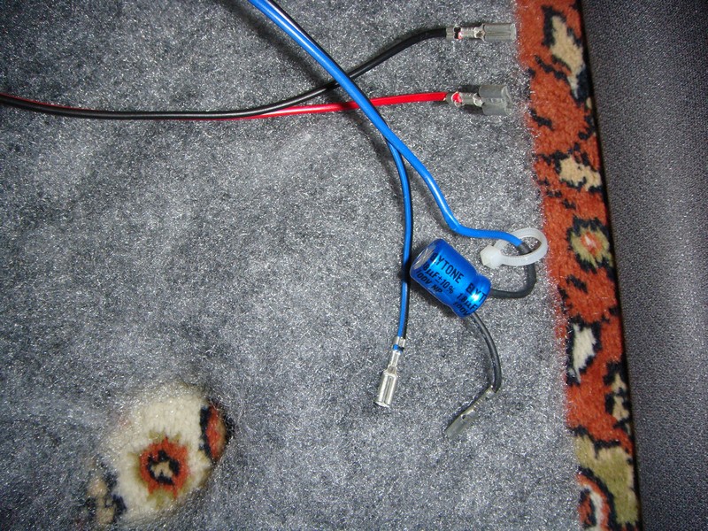

When i removed the drivers, i was disappointed with the wiring and crossover network, both of the driver cables were 0,5mm² ordinary copper wires connected with standard connection sockets inside and a "elytone" brand (probably china made) 1,8uf non-polar electrolylitic capacitor. On the other hand, thickness of walls and general workmanship is better than many more expensive cabinets around.

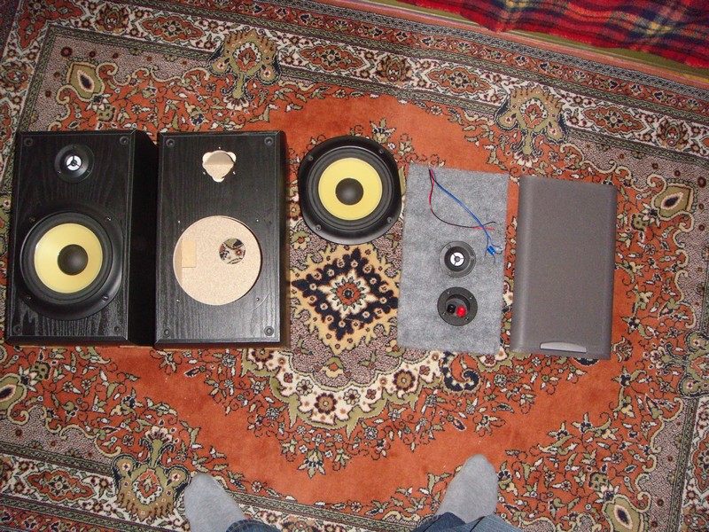

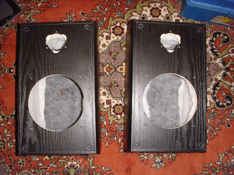

First of all i removed what's inside the cabinets, drivers, socket and the synthetic wool. There was only one piece of wool inside, placed on tha backside, but not attached to anywhere. I decided to cover all the walls with wool and attach them so they could not cause any nasty problems. With ordinary wood glue, i placed the old piece wool on its original location and covered all the other walls with a thinner fibre wool because i didn't want to reduce the volume of the boxes. After glueing, i let them dry for about 3 hours.

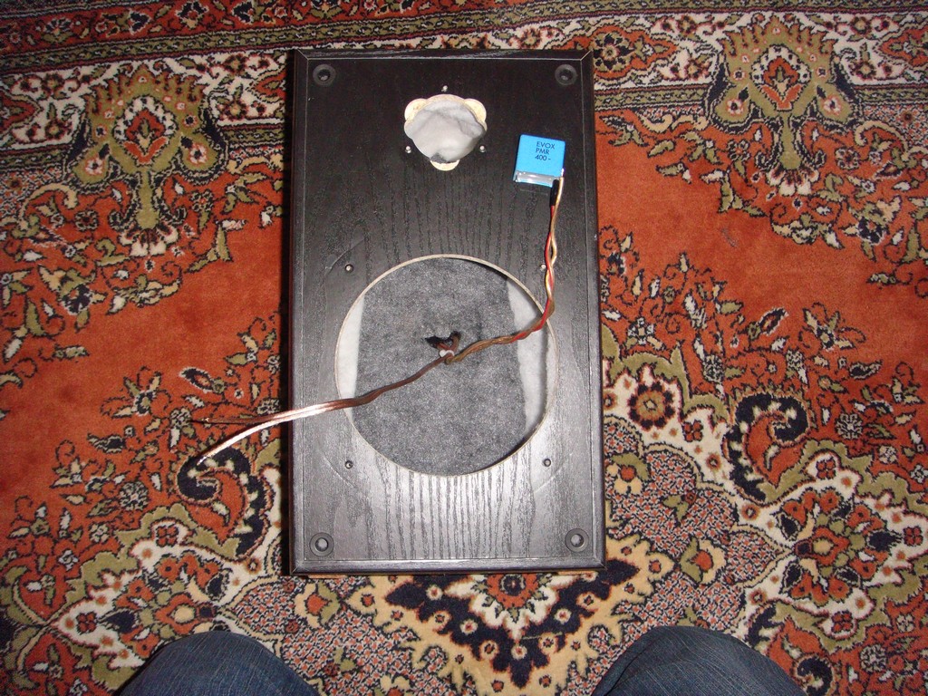

The high-pass capacitor was a cheap electrolytic as i mentioned above. I used an EVOX PMR series (metallized polypropylene) capacitor in that position and increased the value from 1,8uF to 2,7 uF because i wanted a better high-mid frequency response. because the evox cap is bigger and heavier than the elytone, i glued it inside the box and on the front wall of the cabinet.
Instead of ordinary sockets that sony used, i soldered the wires to the terminals with a remarkable amount of solder for the best conductivity. After finishing the connections, i insulated all of them with electrical tape, twisted and fixed them together with plastic handcuffs. To reduce the resonance transition between the box and the surface beneath, i put tiny rubber pads under the cabinets.

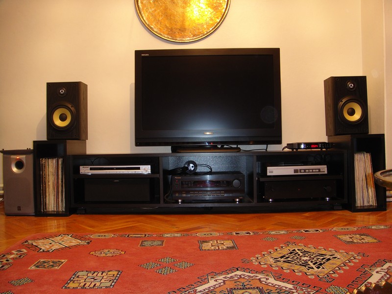

First impressions; much better soundstage, tighter, deeper and more accurate bass response, more natural overall sound, high frequencies came up life-real, cymbals, china crashes are amazing. Vocals are realistic but not tiring.
The total cost of these tweaks was about eur 7, but i can gladly say that the overall performance is doubled, great sound for a pair of eur 60+7 bookshelf speaker set.
Here are some photos:

Sounds like you did some good upgrades to it. I'd also recommend throwing in some extra bracing to help reduce cabinet resonances. Maybe some ribs that are glued to the insides of largest panels or a couple dowels between panels. It shouldn't take too long and will improve the bass/midrange clarity. Don't go overboard though because you don't want to significantly alter the cabinet volume.
I'm happy with the "box sound" at the moment, there is not cabinet resonance at a disturbing level but of course i can try it by doubling the amount of wool that i put in, by the way i'M thinking about connecting an inductor to limit the high frequency that gets to the midbass driver, however, there are not any parameters of drivers in my hand. Can anybody suggest something easy for this application?

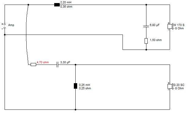

This SS-MB250H speaker is a 6" Kevlar bass and standard sort of tweeter in a closed box. The original idea of adding wool stuffing to smooth the midrange from the bass unit, and increasing the simple 1.8uF tweeter capacitor filter a little to 2.7uF was quite reasonable.
Sony make decent cabinets with a few small wooden battens strengthening the cabinet in the right places.
Although this is an old thread, since the original poster asked, if I was to try seriously upgrading the filter, I would start with something like this 3kHz crossover, where the red resistor is select on test for treble level. It will sound quieter and bassier.
