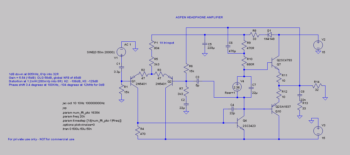

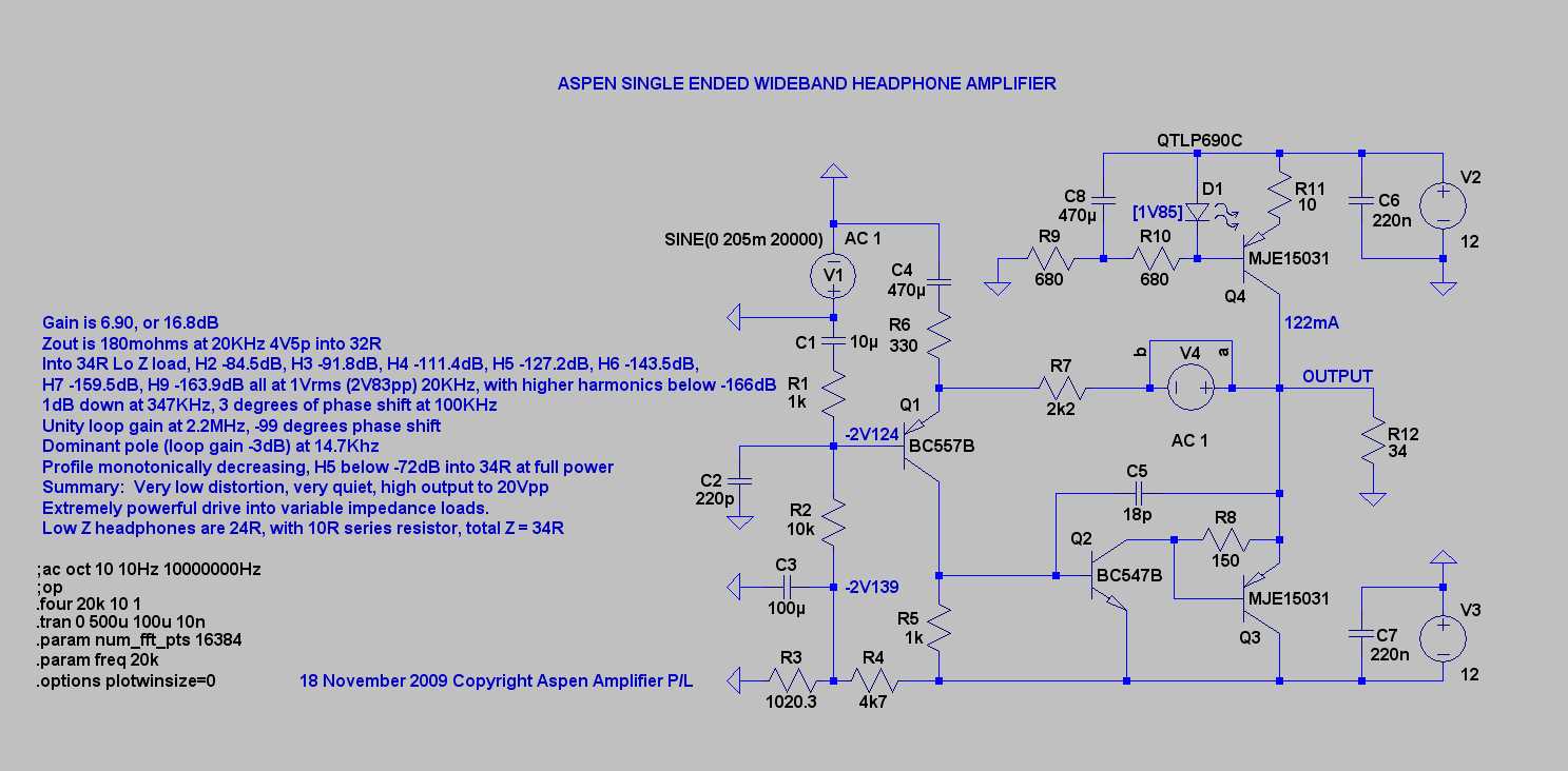

In the spirit of DIY, I've decided to offer a simple headphone amp. Gareth Ingram (aka Bigun) of Ontario will be directing this thread, schematic attached.

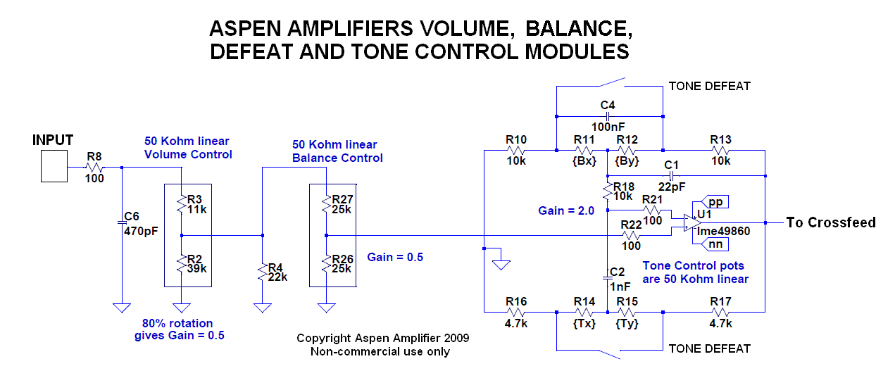

The tone controls with minor corrections, without the volume and balance controls; Tone Controls

Hi Hugh,
I would current source the diff. pair and VAS..................😀
I hope this is in keeping with the spirit of DIY.
Jam
Yes, Jam, I'm sure you would - and thousands of other designers.
However, that is a deliberate choice, and yes, I assure you, it's in the spirit of DIY!!
Hugh

Hello Hugh
Very nice and simple, for sure it will sound very good and there is a well chosen caps value for the vas and a phase lead cap.
Jam
You can just use a zener, a resistor and a cap for the diff. pair and VAS regulation, I do that in my own amp and it's very good and simple.
You can also match VBE and HFE of the two diff. pair transistors.
And, After adjusting P1 offset, if you adjust R4, so R2 and R3 will have same DC voltage drop, you will gain more definition and better soundstage.
I alway do those two things in my amps.
Thank for this headphone amp Hugh
Bye
Gaetan

Hi Hugh,
Jam
Hi Jam,
That would certainly clean up the performance of the LTP and put a firmer grip over the VAS.
On the other hand, the bootstrap is so efficient, small parts count, low cost, reliable and gives excellent results. I've used this approach before and love the results, I believe it's more 'musical'.
A current source on the LTP is a good option for improved PSRR and other things. It could be more important with the relatively low supply rails because we can't use such a high value resistor if it's a simple feed. Again though, many good reports from amps which use a simple resistive feed in terms of musicality. Maybe we need to try it both ways ?

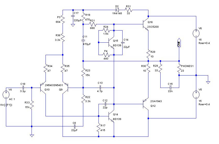

Hi Ikoflexer (should that be Harley, or Buell?),
Good question. You could actually simply use three 1N4148 diodes in a string. That should give around 2.1V of bias voltage, which would translate to 45mA of bias current. It's simple, and effective. Two of the diodes should be thermally coupled to the small heatsink used to keep the outputs cool.

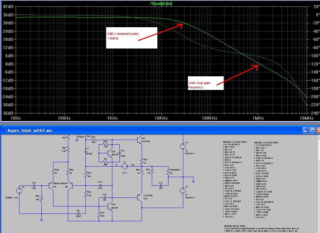

This small amp has lots of phase margin, 75 degrees at 12MHz, the dominant pole. It would be very good with electrostatic headphones (Stax). There is a possibility that lag compensation (Cdom) could be reduced to 18pF. This would chiefly affect imaging performance.
Hugh
Hugh

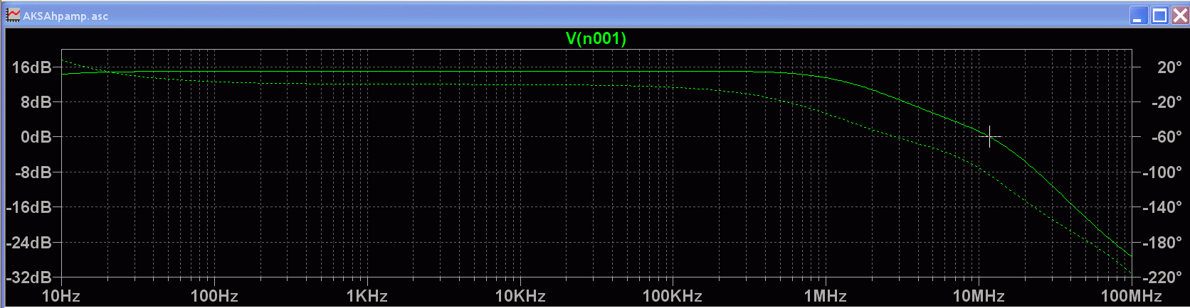

12MHz??
The unity loop gain frequency is actually closer to 1.1MHz and the dominant pole frequency is a bit under 50kHz.

Let's see if a simulation file is helpful here (attached - my recreation of the schematic - Hugh, perhaps you can post your original file including the device models). I've opted for the infamous Vbe multiplier for now - can swap out for diode's later.
To use the sim, download it and change the file extension from .txt to .asc (LTspice). You may need to go into file options to view the file extensions.

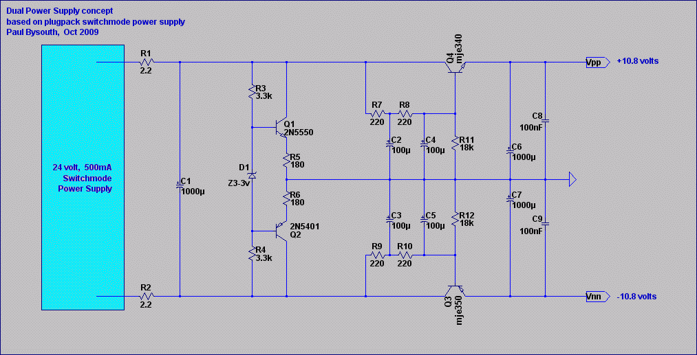

Power supply
I see this as a desktop unit so my first thought was not batteries despite the noise benefits because I don't want to be worrying about re-charging etc.
If we want to keep this simple I'm leaning towards a 20VA trafo, anything too small will have poor regulation ? IF it is to drive small monitor speakers as well, I'd want 50VA.
Current draw on the rails is small, perhaps we can get away without dual supplies, put some fairly stiff CRC or CLC filtering in place on the rails if current draw is limited to headphone use only.
Another option would be a capacitance multiplier. It's a bit crude, but does the job well. The downside is some loss in headroom since you have not just the Vbe drop but Vce under load and the drop across the base resistor.
I'd like to keep it really simple - my dream would be a single pcb for both channels and power supply - how fussy should we be, can we achieve -100dB cross-talk on a single pcb ?
What are you thoughts ?

I think so but where the amp itself is simple, I'd like to see extra effort on the PS. For a low current draw amp like this going with a fully regulated supply makes sense.
