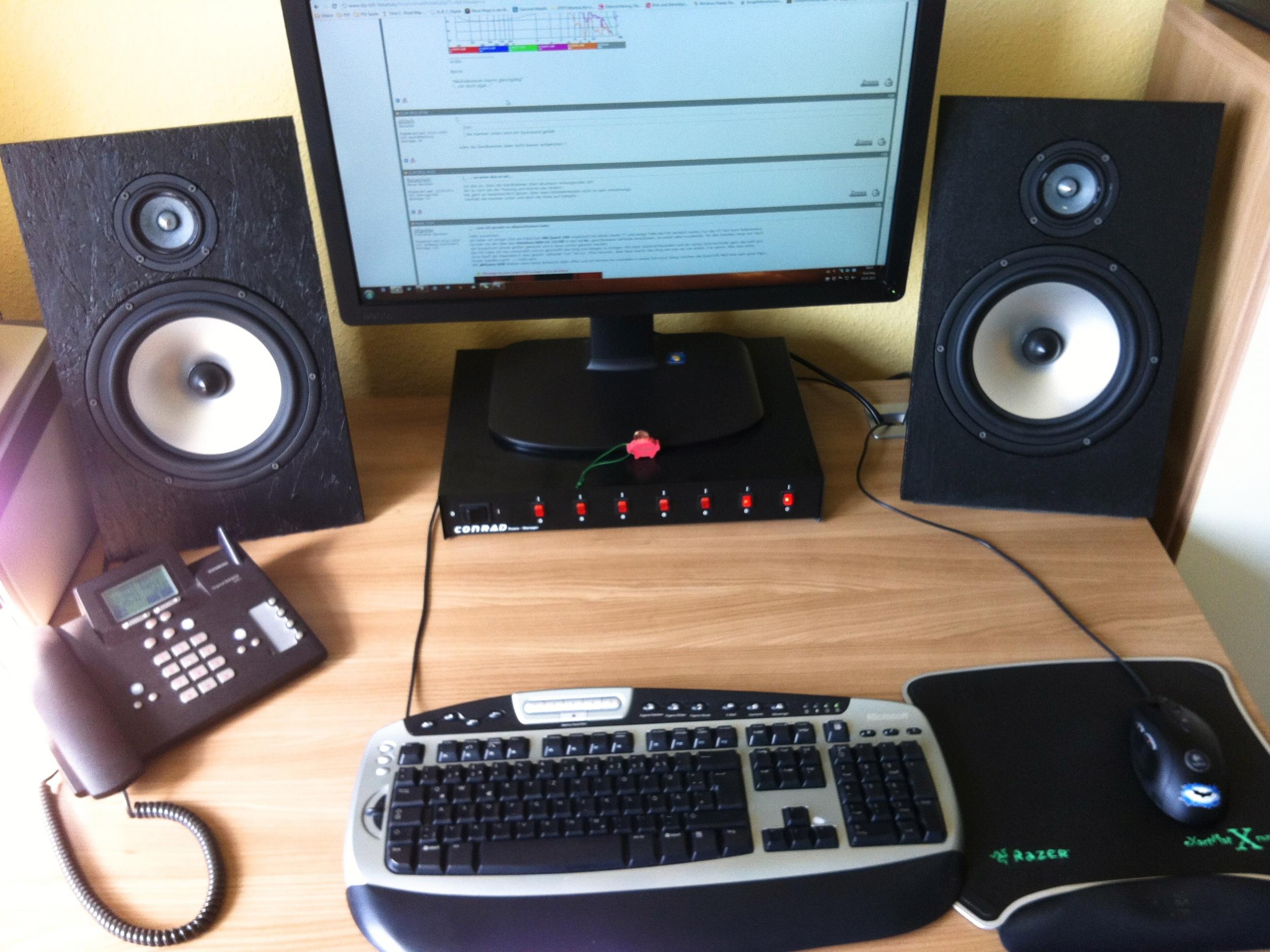

Hi gainphile,
maybe you remember my question about the W3 in your blog? Since then I made a pair of prototypes that play around half an hour now (so they are far from being "wobbled in").
As my miniDSP hasn't arrived yet, I play music over foobar's crossover plugin which works quite well. The amplifier is a modified Yamaha DSP-E1000 that isn't "DSP" anymore 😀 (a little modification I did). It is a capable and yet affordable amplifier.
I didn't ask you about the measures of the baffle you used but I think I came pretty close with some simulations in "Edge".
I wanted to thank you for the inspiration. Without your blog I wouldn't have tried an open baffle. It sounds real good now...and I hope it will be even better with the miniDSP and some measuring 🙂.
The current look of my desktop open baffle prototypes is attached.
Many thanks
Sven
Many thanks
Sven

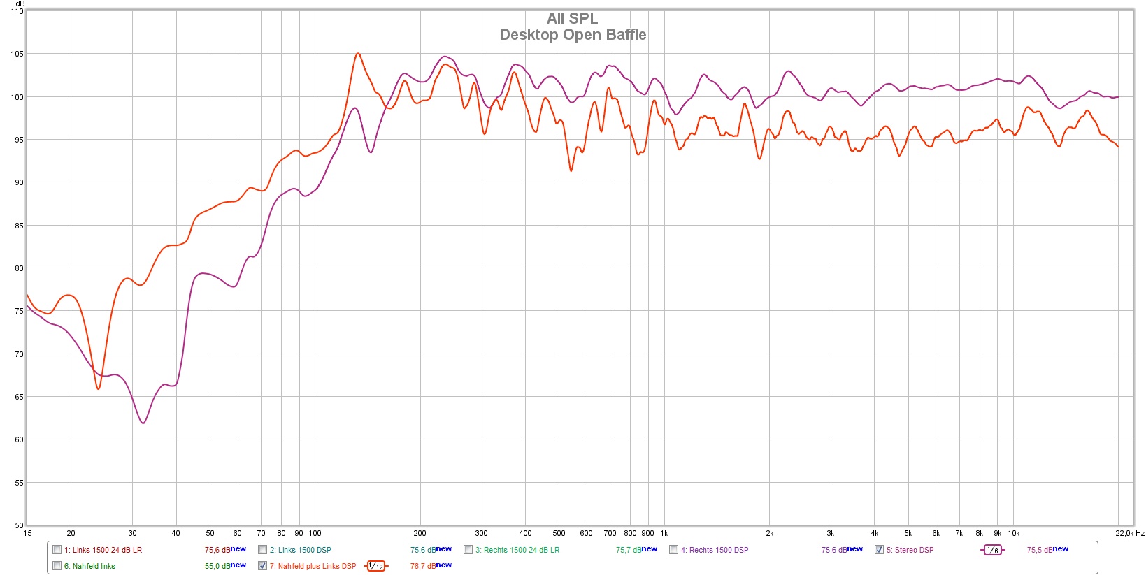

Finally...
after some weird results I got more or less acceptable ones 🙂.
The attached picture shows the frequency response at hearing position with both speakers playing. I added a plot with an applied nearfield response (below 200 Hz).
It is not perfect yet but I keep trying. In fact it sounds better than before as I did wire the TB and the SEAS false on right channel 😱. Now it is correct and it makes me 😀.
Greets Sven
Greets Sven
