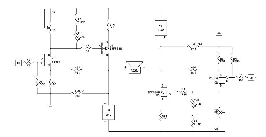

I was about to build Mike Rothacher's Amazing Circlotron amp when the news of SemiSouth's power jfet came. Liking the simplicity of Mike's amp and Nelson's glowing over the power jfets got me thinking about using then in this circuit. My question is about the biasing of the power jfets. From what I've read, normally that they are biased by a resistor in the source but a what Id and what Vgs etc. The curves on the data sheet are very expansive if you get my meaning. So can anyone help with a suggested operating point and bias scheme. Thanks in advance.

Yeh, I love to but at $60 each, have to save up a few more pennies. So what do you think about biasing, Mark? And Nelson, what operating point do you use?

The circlotron can be either Common Source or Common Drain.
I bias the JFETs into Class A - if you are spending that much
for a part, you might as well go for the gusto.

There's nothing new about the Amazing FET Circlotron. It, and other circlotron's are push-pull amplifiers, with push-pull cancellation.

Even when operated common-source, the circlotron doesn't contribute voltage gain. It's still a follower. This may be the cause of some confusion. (Would it be a drain follower? Is that even a word?)
This accounts for the distortion performance differences between The FET Circlotron and its F5 cousin. F5 has more open loop gain since both stages contribute voltage gain. The FET Circlotron has less gain available for feedback, and the distortion is correspondingly higher. Of course, there's also less feedback and a balanced input, and you might view that as a good thing too. 😎

I pulled up the PDF from 6 Moons, and, as a starting point I guess I'd pop them (SICs) into the circuit as-is, adjusting P1, and dispensing with R7 and TH1.

I don't think that removing R7 and TH1 is a good idea given that the SJEP120R100 has a positive temperature coefficient.
Nelson as to bias, I was looking at the curves and given a requirement for 1.2A the Vgs is pretty close to the gate threshold voltage of 1V. Is this a problem?
