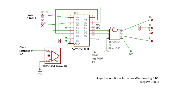

I don't know a lot about reclocking but I've looked for schematics and found the one below. Would this be a reasonable way to go about it in this case? If so, which clock and clock frequency should I use?

Any D-Flipflop will do in principle. The QA550 has 3.3V digital outputs, so you can also use LVDS as well as VHC.
As to the clock, I presume you might want to keep the original one, in which case you can use the MCK output from the I2S of QA550 to drive your Flipflop.
Don't be shy to ask Clark of QLS. he knows his stuff, and is quite willing to help.
If you really want expert advise, go to the other place and ask Jocko or Elso.
Patrick
