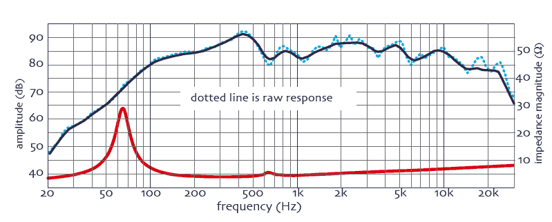

I have a question about the datasheet. I just measured mine (well, mine are a prototype) and I get very similar TSPs. Much closer than most manufacturers!!! However, Fs is 64hz but the impedance sweep on the data sheet shows it closer to 97hz. Perhaps the wrong impedance curve? Or do I not understand. Thanks.

I got an Fs of 72hz. I meant the spec sheet says 64hz, but the impedance curve on the same spec sheet says 97hz. That is, if you define Fs as the impedance peak.
I consider an Fs within 10hz of factory spec to be very good, as I measure with low voltage, rather than factories use high voltage. Therefore I get a higher Fs usually. Like you say Dave.
So my enquiry isn't about my measured differences, rather the conflict on the spec sheet.
Now i see what you are talking about.
Not the wrong impedance curve, just that it didn't get grabbed when the graph was moved on the page, you can see that the start of th eimp curve is not at 0 (the document is over 10 layers in Illustrator).
I have fixed the doc and put it here. Bob can download and replace his. I have left the name the same so any external links should still work
