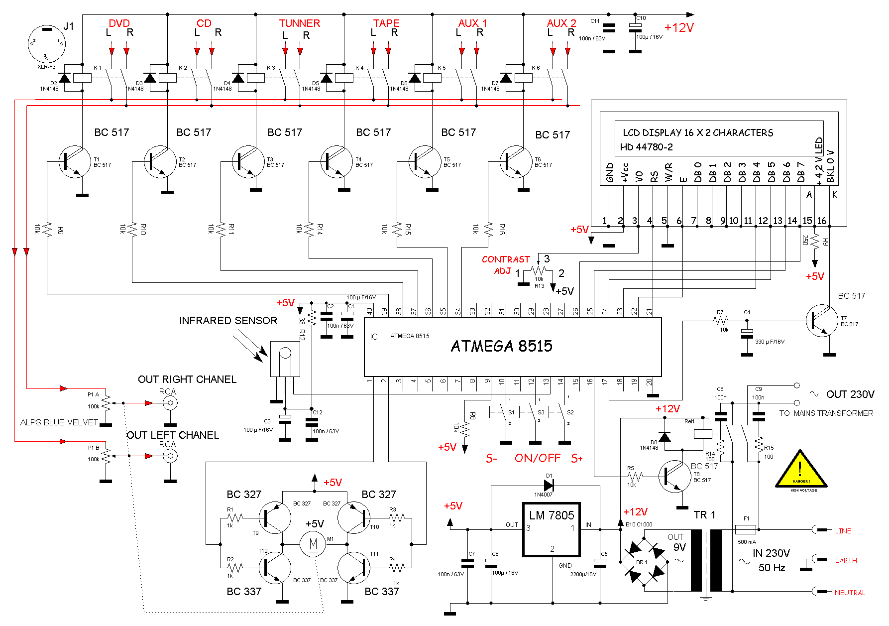

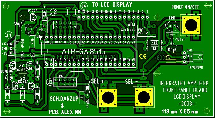

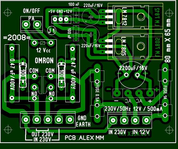

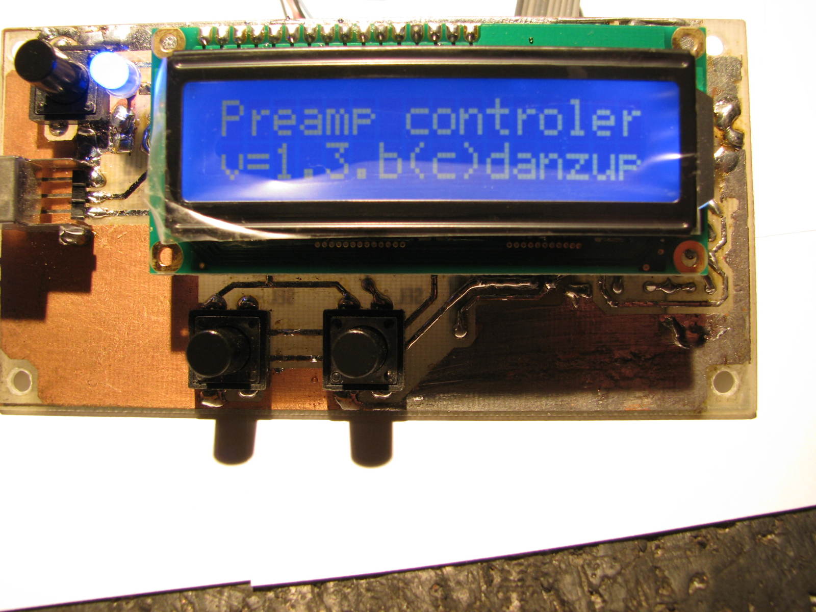

1. Volume controller / source selector for motor potentiometer ( like Alps blue velvet ) :
-schematics
-avr atmega8515 soft
-pcb
On atmega8515 you have to write only the fuse-bit named :
" Internal RC oscillator 8Mhz "

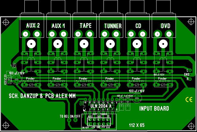

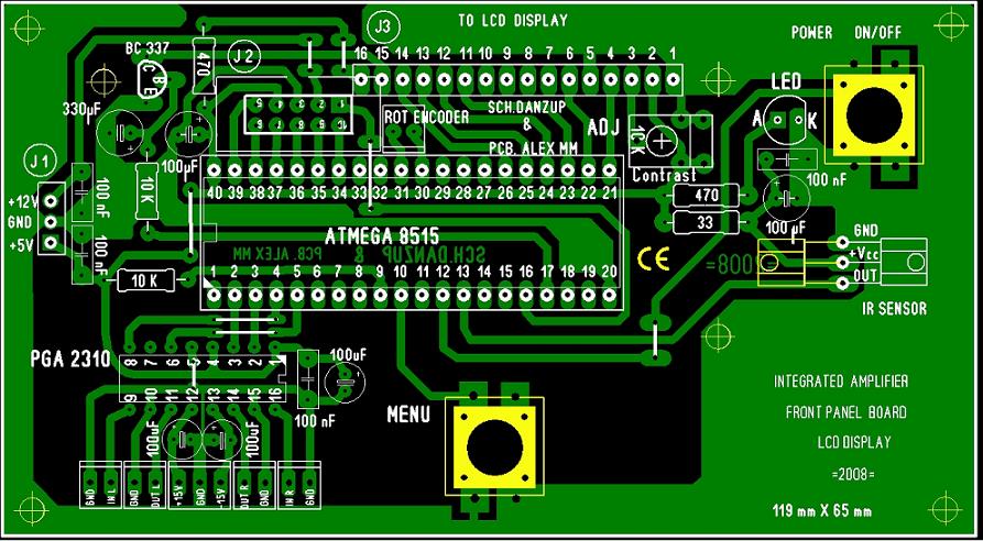

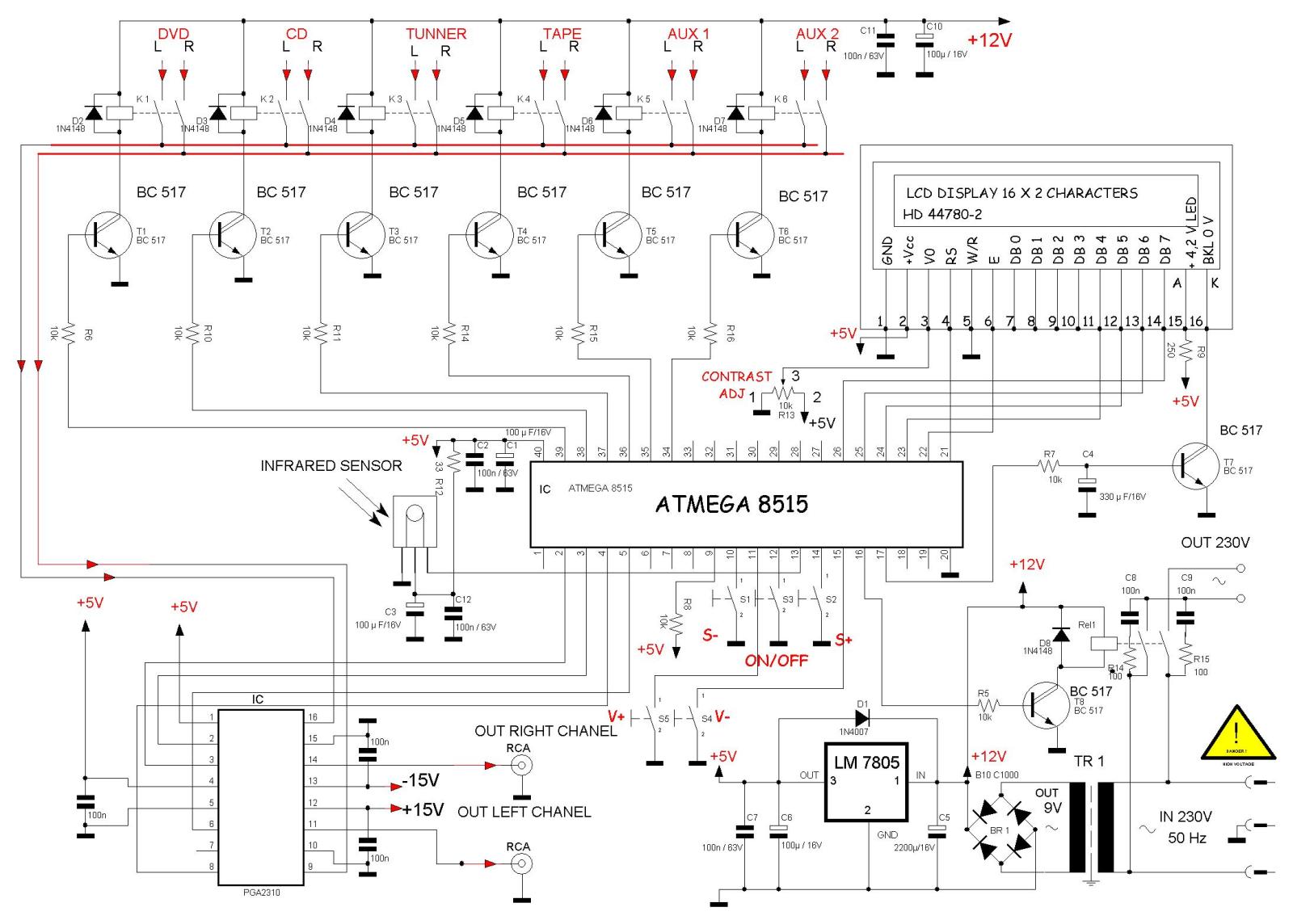

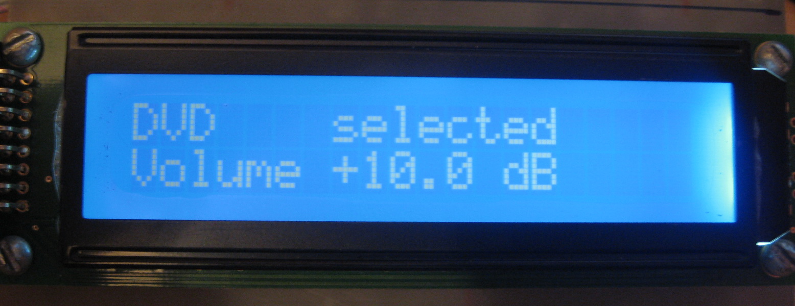

Projetc nr.3

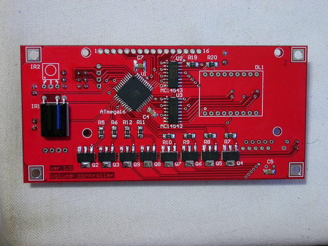

3. Control and audio select with relay and r2r volume
- volume with quality MELF resistors for r2r or shunt adjusting
- infrared remote control in the stop / start amplifier
- selection from 4 sources of signal relays
- version Display with LED or LCD display as it wants ( depending on board will possible planting to serve both variants )

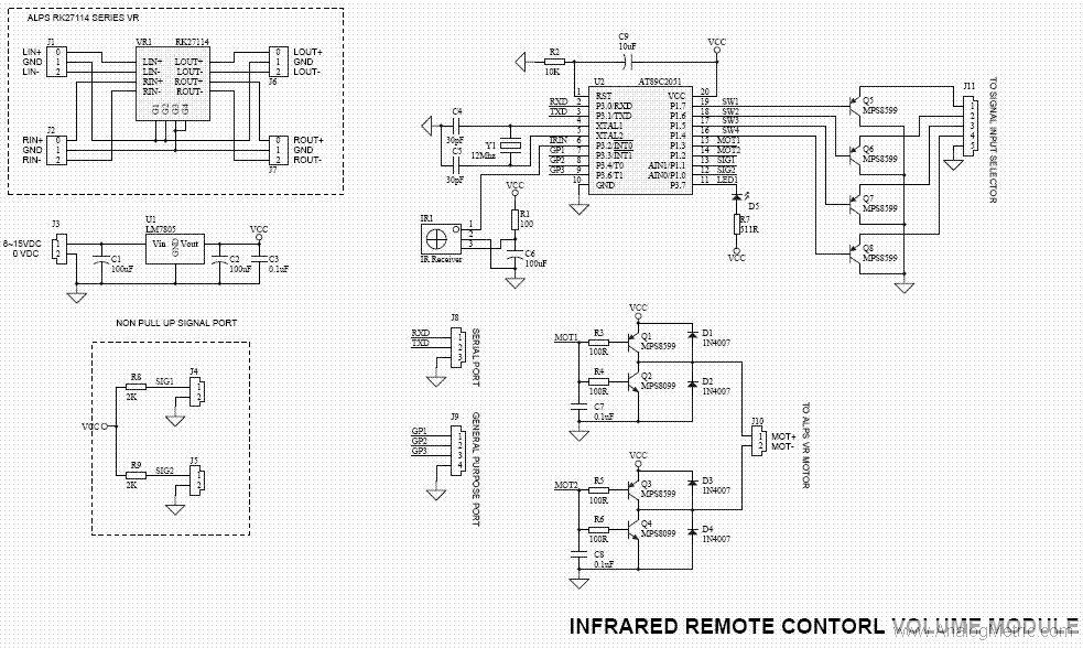

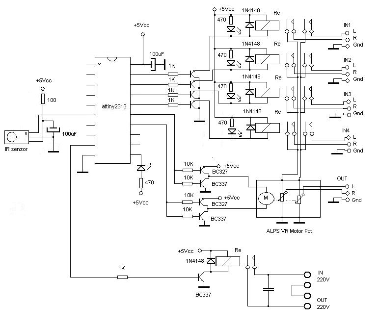

4 . This project was made by me for a friend who buy from ebay a kit like this :
http://forum.analogmetric.com/viewthread.php?tid=349&pid=421&page=1&extra=page=1
but did not work at all !
So I write the software for this kit . I post here for everyone who want to use .
Atenttion : I have remove the AT89C2051 ( look at the old schematic ) from that pcb and replace with ATTINY2313 ( look at the new slightly modified schematics) which is more modern micro controller .

Neat. I was thinking about remote controls a bit lately, and thought something like this might integrate really easily with a "lightspeed" style attenuator using LDRs controlled by the micro controller. Seems trivial to control the brightness of an LED via the voltage on a pin.
And while you are at it, you could configure each input to "remember" it's previous volume setting.
Just some ideas I wanted to share since I will probably never build my own remote controlled preamp 🙂

Thanks for your thoughts man !
I have also tried an write soft for all variant include the not so hi-fi IC like : TDA7813 and associate.
But nothing like only resistor attenuator !
"Hello Danzup,
I would like to ask a question and I hope I'm not OT cause I've been OT in the "Ebay Hdam module" thread.
Does your relay based ATT suffer from audible click in the speaker ( not the relay) ?
Cause I have a similar ATT I bought off ebay, And It has audible on the speaker click at only 2 points in its attenuation range. "
I give here the answer : no there are not such click or pop in speakers in my resistor r2r or shunt type volume .
Because everything is done properly in soft and in pcb layout of the volume controller .
Every up or down in volume attenuation is done in software by switching to max attenuation (mute ) for 2.... 6 ms (depending on the relay parameters !!! every type of relay have different time for settle ) and then applying the new value .
Ok ?
"Hello Danzup,
Ok ?

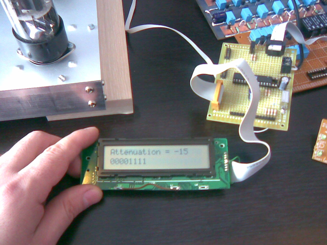

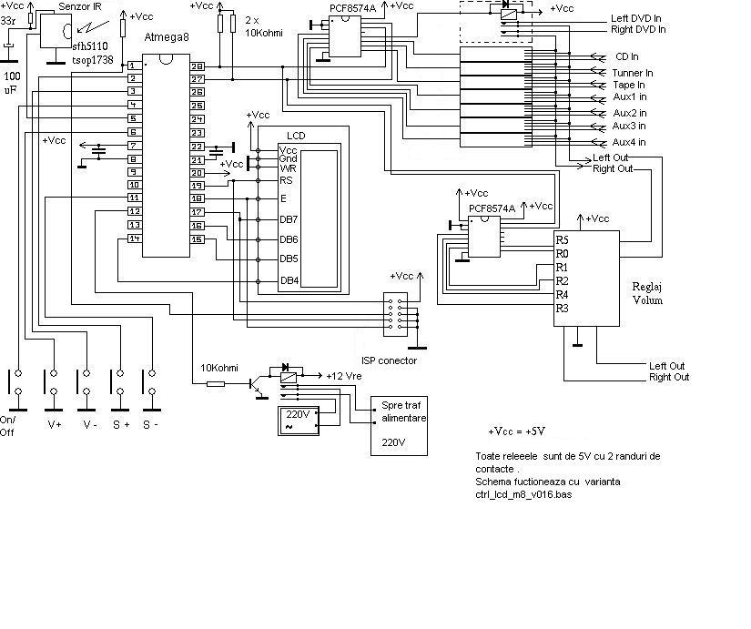

And another type of volume/selection controller made by me in 2005 .
Who want the soft just ask .
Used I2C port expander from Philips to command the relay PCF8574A .
