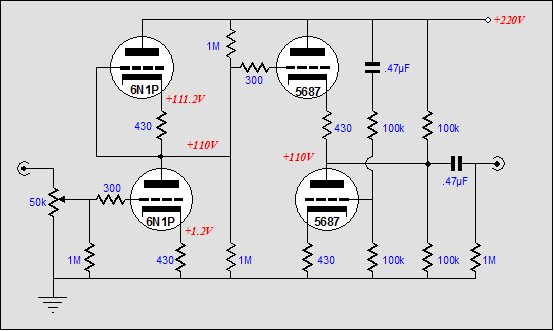

I have gone for a SRPP tube front end with MOSFET output transistors.
It gives a valve sound with lots of power at a very reasonable price.
