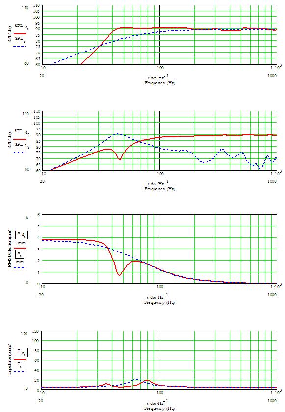

The predicted performance of the individual MLTL is shown in attached figure. The SPL response has a F3 point of 40 Hz with a port null at 45 Hz. The graphs are plotted for an input power level of one watt. Note that the deflection is well within maximum deflection (Xmax) limits and the impedance of the individual MLTL is typical for MLTL speakers. When connected in series the overall impedance of the bipolar speaker will be nominally 8 ohms.

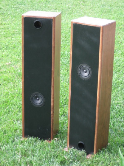

I'll attach a photo of the enclosures that were constructed for this design. Walnut panels were used for the sides and top of the box with MDF employed for the front and rear baffles, the shared internal panel and bottom of the box. The terminal plate (I used the Parts Express #260-309) was located on the bottom of the box. Hardwood rails were used to stabilize the enclosure and raise it for access to the terminal plate. The port tubes are Parts Express #260-322 cut to the correct length.
For each pipe I stuffed the volume from just below the front driver to the top of the box with Acousta Stuf™. For the rear driver the volume from just above the driver to the bottom of the box was stuffed. No additional stuffing was used within the boxes. An alternative to Acousta Stuf is to use a 9 x 16 inches sheet of 1 ½ inch thick convoluted acoustical foam behind each driver. Again the front and rear drivers are connected in series within the enclosure and no equalization circuitry is in the signal path.

You are correct in that Martin's worksheets do not correctly model an offset bipolar speaker. Offsetting the rear driver does increase the wraparound length (the wraparound frequency area is the frequency at which the drivers are separated by a half wavelength) which would lower the frequency range wherein the wraparound would occur. It also tends to disperse the effect. But offsetting the rear driver will not totally eliminate the effect--it does move it downward in frequency so that it is less apparent.
So far my measurements on my prototype have been limited to in-room testing which does not yield a very good measurement of the wraparound effect for the lower frequencies where it occurs. And near field testing does not show the effect so you must test in the far field. In the future I plan to take some outdoor measurements which will better isolate the effect.
If I were you (and if you plan to try an offset bipole) I would use the half wavelength criterion as a guideline to get an idea of the area of concern.

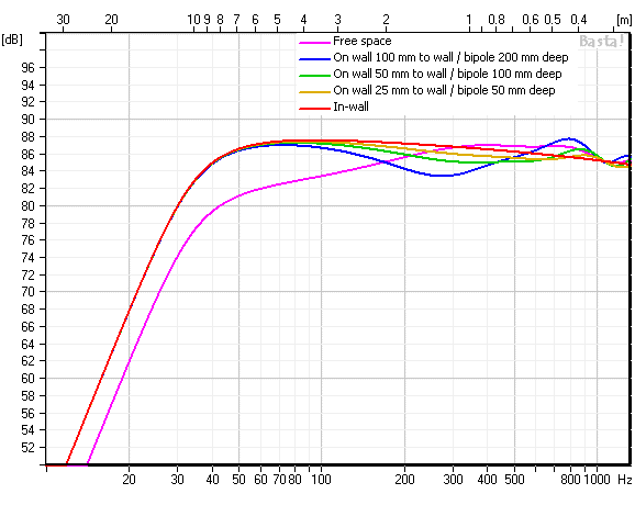

Jim, I'm honored that you would see fit to incorporate some of the ideas I talked about into your latest design. And I thank you for giving me credit... though I think you'd already figured out most if not all of it on your own.
Ttan98, the wraparound dip is usually not symmetrical, and the greater the vertical offset between the front woofer and rear woofer (or fullrange driver) the less symmetrical it will be. The dip will have a shallow slope on the low frequency side, and a steeper slope on the high frequency side. This is because the wraparound itself is spread out a bit. The shortest wraparound path length for the rear driver will usually be horizontally around the sides of the enclosure, but there will also be wraparound energy along diagonals as well as over-the-top. Since these other path lengths are longer, they sort of spread out the dip on the low-frequency side.
I think the deepest part of the dip will be close to (perhaps a little below) the frequency where 1/2 wavelength is equal to the depth of the enclosure plus 1/2 of the width. So if the enclosure is 12 inches wide and 8 inches deep, that would give a path length difference of 14 inches, corresponding to 1/2 wavelength at about 480 Hz.
Now a 12 inch wide baffle won't start to baffle-step (which is a form of wrap-around) until about 560 Hz, so we won't have a whole lot of wrap-around energy at 480 Hz, and therefore the dip won't be very deep. The wider-than-deep geometry that I use isn't really necessary; in practice the enclosure can even be a little deeper than it is wide, as the wraparound notch is probably less audible than the floor-bounce notch that virtually all speakers have - but the offset bipole has less floor-bounce notch than most.
You see, the rear-facing driver's proximity to the floor will greatly reduce the depth of the floor-bounce notch because it will not be notching at the same frequency as the higher up front-facing driver. So the floor-bounce notch is significantly filled in by the rear woofer's contribution, assuming it's fairly close to the floor.

Duke, good to see you here.
Attached is a sim that Svante did with an 800x400mm baffle. this is actually a box mounted on a wall, which is topologically the same as a push-push bipole with a box 2x as deep. As the depth decreases the width to depth ratio increases. As can be seen this ratio can have a substantial affect on the magnitude of the bipole dip.

That's a pretty clever way of simulating a bipole with a program that wasn't designed to do bipoles. It can't simulate an offset bipole, but it's still quite useful for investigating different combinations of enclosure width and depth. Comparing the blue trace with the green trace illustrates the advantage of going with a box that is much wider than it is deep, which is educational even if such a confiuration isn't always practical. Nice job!

Jim. I am in the process of building your offset Bipolar enclosures with the CSSEL70 drivers. The plan drawn by "did" mentions that the stuffing hangs from the top of the box to just below the driver. That makes sense for the front section where the speaker is at the top of the box, but surely for the rear facing section where the speaker position is reversed to the bottom of the box, the stuffing would be from the bottom of the box to just above the driver? Did you put the stuffing in place before you closed it all up or did you make the speaker baffles removeable, so that you could alter the amount of stuffing if it was necessary. Thanks.
Since It is essentially 2 identical TLs, with the back one upsidedown, i would consider the top of the back one to be the bottom (wrt gravity). In other words i agree with you. I'll add some comments to the drawing.
dld.
Leeoh,
Yes, the stuffing goes from the top of the box to just below the driver for the front driver (right side up MLTL) and from the bottom of the enclosure to the just above the rear driver (upside down MLTL).
I place the stuffing inside the box via the driver hole cutouts and you can vary the amount by this manner. You can vary the amount of stuffing to adjust the bass performance a bit from over stuffed to lightly stuffed to best match your listening room dynamics.
