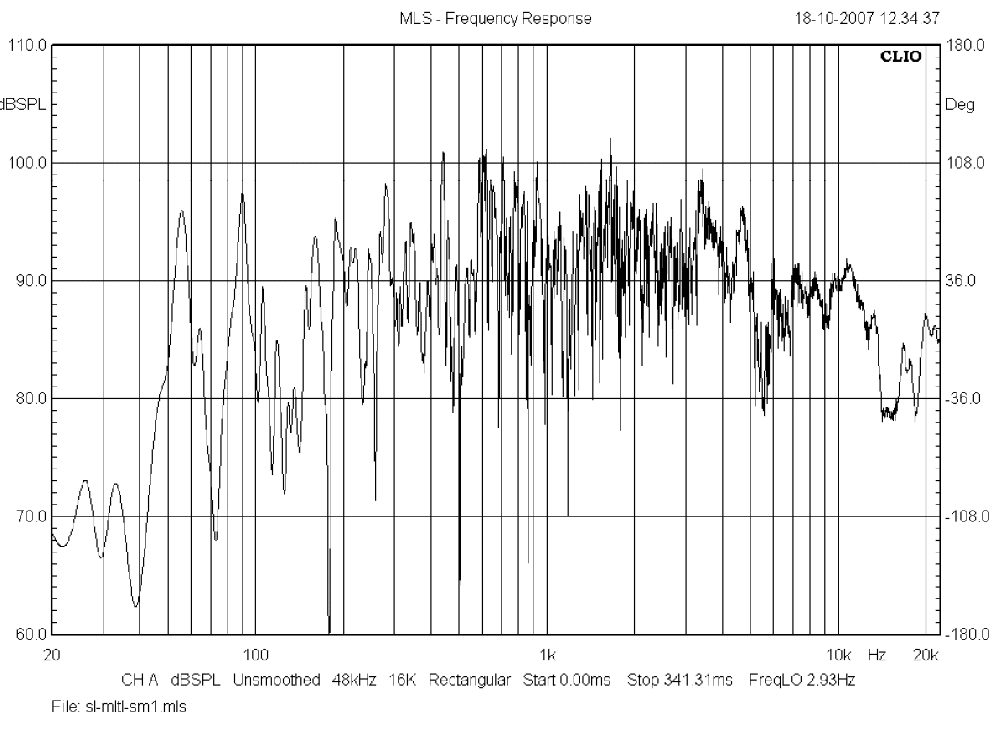

InclinedPlane said:
I'm missing the point of why the smoothing of 1/3 octave is necessary and how the omitted data is 'trash'. Ha maybe I'm just sick of all the super-smoothie plots you get from Fostex and everyone else. For once, I'd like to see the real deal. But you're taking the initiative and doing the work so I applaud that. Would measuring them outside offer a cleaner plot compared to in the garage?
I just can't see how the driver could be within 5db 1K to 20K.
Indeed you are missing the point.
If I didn't smooth these spaghetti charts, they would be unreadable.
Do you really want to see all of the cabinet defraction effects and the reflections within my garage?
We are looking at the DIFFERENCES between three different cone treatments. The actual performance of the stock driver is irrelevant.
The measurements were done with a 2k FFT. That in itself smooths the data, and I didn't feel the need to take the time to increase the data points.
Finally, you brain is going to smooth what you hear to something like 1/3 octave (actual number debatable). Unless narrow spikes are very large, you won't here them.
But since you ask,
Bob
Right, in general terms, the unsmoothed data isn't especially practical to work with. If you want really raw, see attached Clio measurement.
This was of a 167 MLTL I did a few years back. 1m, on axis, room heavily damped for the measurements. Driver had a phase plug; otherwise stock.
