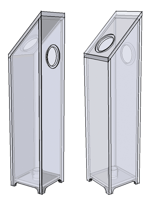

Inspired by exposure to the original EPI microTowers (by Winslow Burhoe) in our youth, Chris & I, with Scott Lindgren's help, have come up with a tribute to this landmark vintage product,
We have come up with a small bipolar ML-TL for either the Marl Audio CHR-70, CSS EL70, or Planet10-HiFi E70eN (with an appropriate port) that with the exception of being 1" taller is the same size as the original.
Since we were squeezing drivers into a format instead of making the boxes fit the drivers, we have held off release until actual builds were heard. We now have both a traditional microTower with CHR70eN & a castle variation with EL70eN. We like them both.
We are quite pleased with these. Bass is exceptional (a bit of port damping required if you get them too close to a boundary), WAF is high, build is easy.

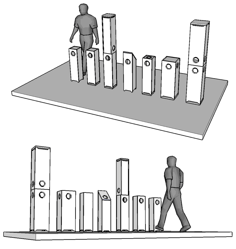

The design quickly generated a bunch of variations, including a chubby/omnipole version and a halfTower that can be a floorstander or a wall-mount.
Plans are just being detailed and i will post a link within the next week.
dave
Attached is a comp of most of the variations.

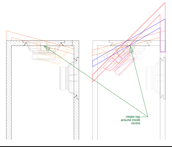

Scott,
It was you mention of the Castles (many many months ago) that inspired the castle version, and reminded us that a BD-pipe variation should be looked at...
Here is an illustration of the concept
dave

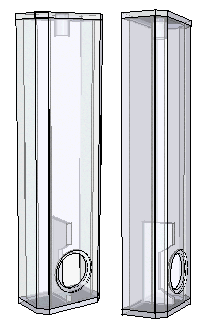

audiosteve said:
Would you by any chance have a variant that will work properly with a single driver per box?
yes, saw it in half and you get a halfTower.
I haven't done a visualization of this one yet, but have an early version of the wallMount variation on the halfTower. Note that the brace in this visualization is too short, our actual build revealed some front panel vibration just below the driver so the brace was lengthened, Also the orientation of the application has the bulk of the box above the ear & the port firing at the ceiling. Bevels were also added to match a full set of small wall mount surrounds and a centre.
dave
