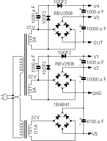

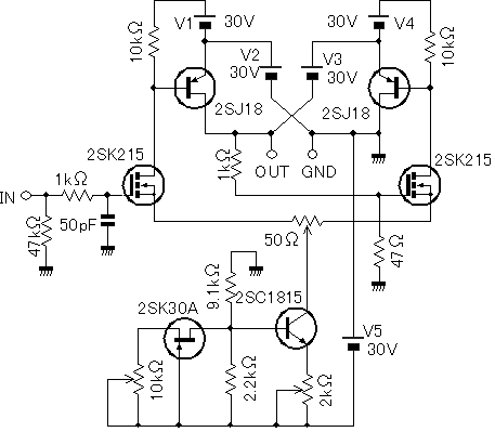

Hannes,
I was not aware of the details, see a simpler design below, lateral MOSFETs can be biased conveniently (with a resistor).
