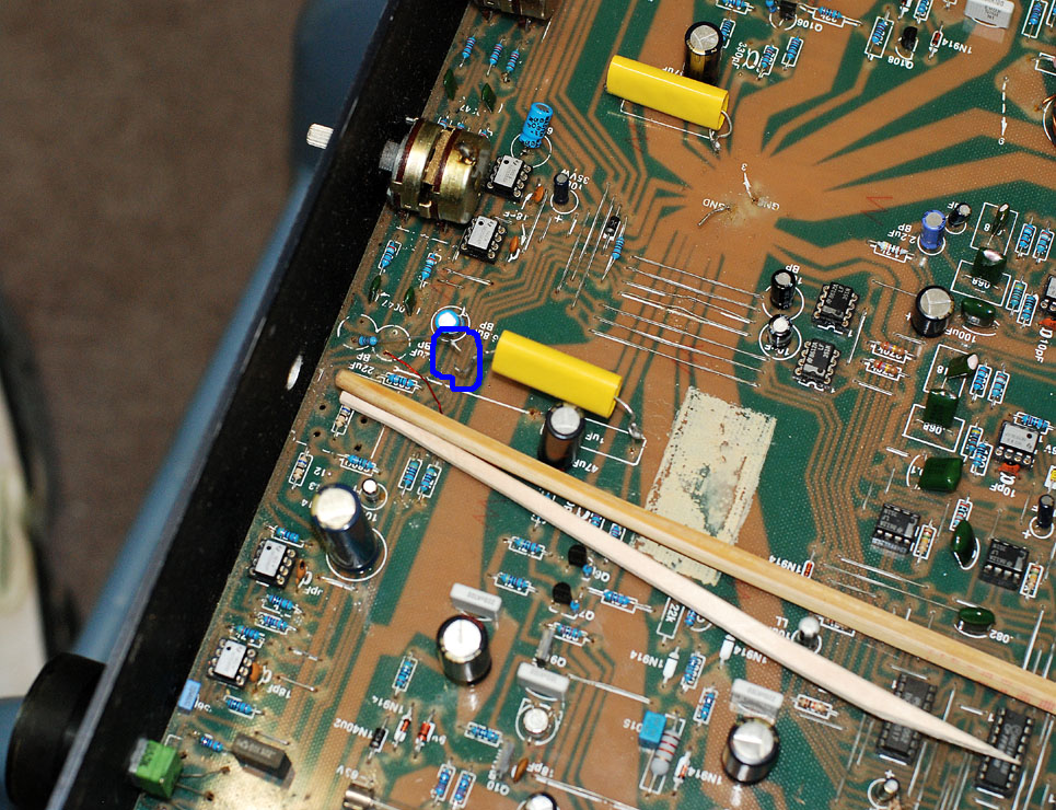

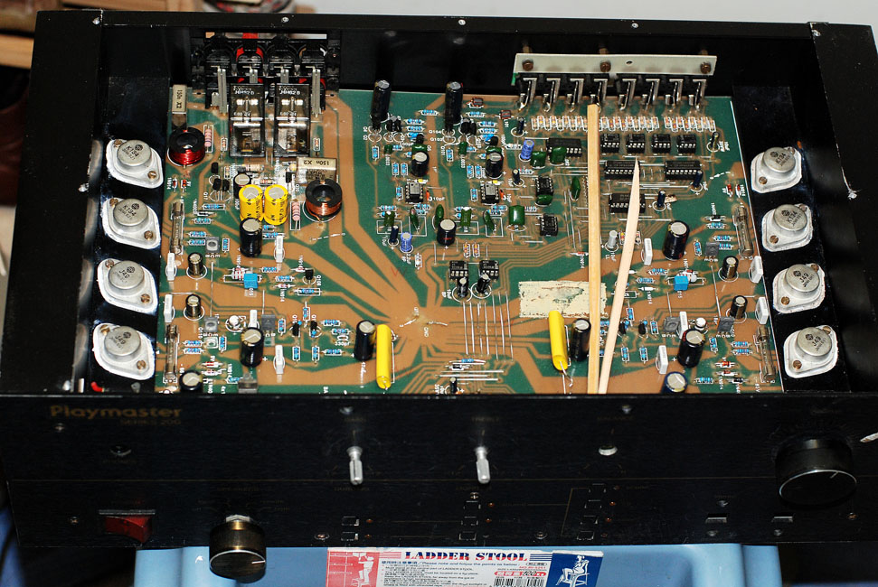

Well thankfully mine was a simple repair didn't even need any test gear... My 20 month old daughter had decided that the hole where the balance pot used to be was just the right size to poke chopsticks through. in the process she managed to jag the rather dodgy connection between a resistor and the main input capacitor to the power amp. Dodgy mod I did ages ago to bypass the tone controls of the amp. Resoldered and back up and running.
Two interesting things came out of this though. First was I got to finally seriously listen to my gainclone (I originally only built if for speaker testing duties). It is surprisingly good, and not at all underpowered. Perfectly fine for my normal listening levels. Bass was good despite the small caps in the power supply, and due to the earth loop breaker installed in it, it doesn't have the hideous hum that my main amp does when hooked up to the htpc. I'm not set up to do A/B comparisons, and it wasn't fair as the GC was being fed direct with no preamp, and the Playmaster was going through the integrated pre, but I suspect that the Gainclone had the better of the bigger mosfet amp in the clarity stakes.
The other interesting discovery was that I had modified the right channel of the amp mosfet, probably after a particular thread in the solid state forum where I asked for suggestions for improvement. I think after the mods (which I did at the same time as a complete recapping, and transistor matching excercise) I had some problems (solder bridge) and gave up and left it as is once working, but I had completely forgotten about it. So the right channel is missing 2 diodes, a resistor and a transistor and has a single resistor in their place... I suspect I was going to do some tests but never did due to the frustration the other problem caused.
anyway here are a couple of pics of my daughters handywork 🙂 The circled bit is where the break is. Just shows that it is not always something you would think!!!!
edit: oh and I gaffer taped up the hole, hopefully enough to stop her again. Luckily for me (and her) it was a chopstick and not a screwdriver!
